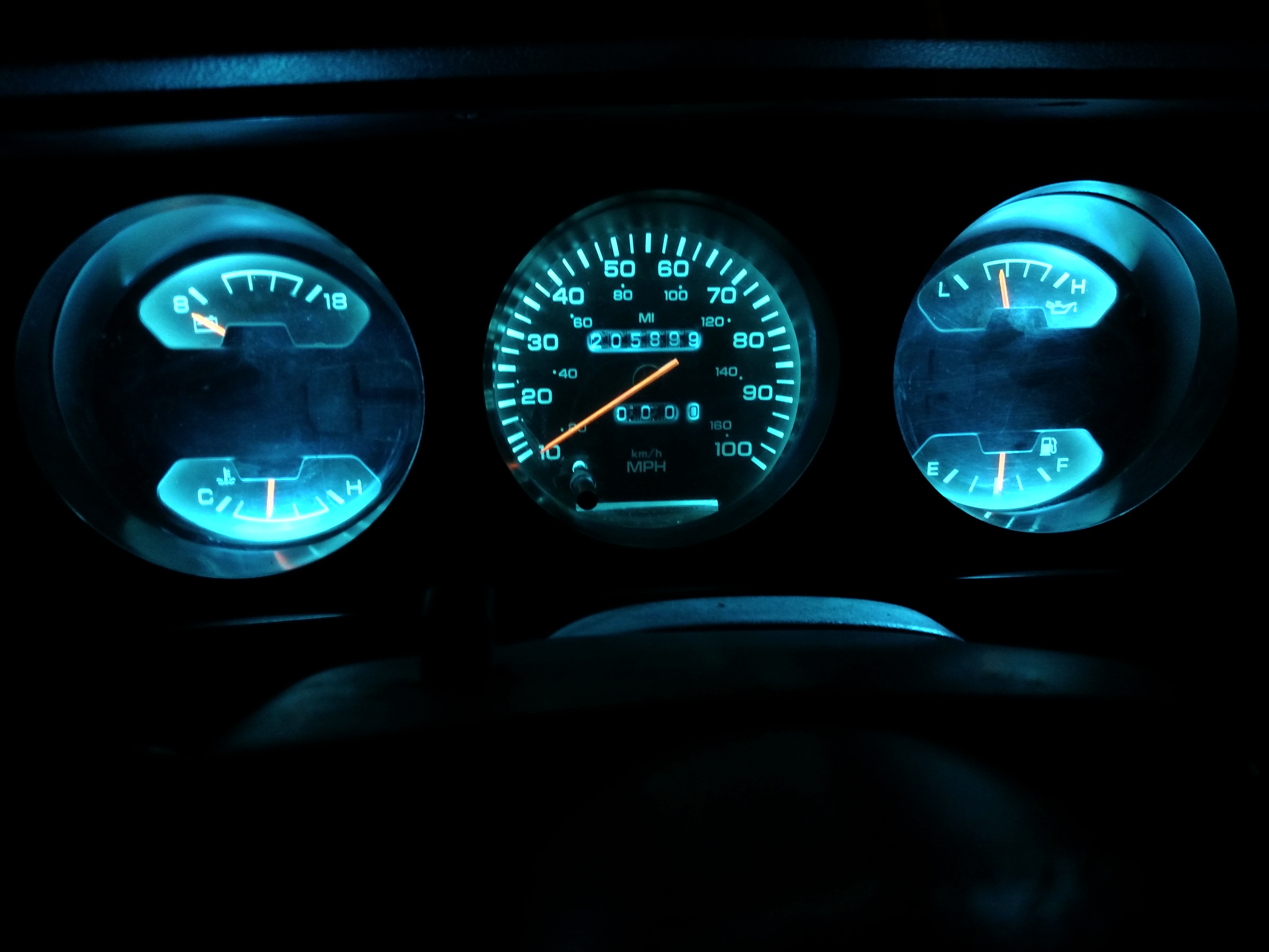

Also put the blue bulb caps back inside the instrament cluster. Just having the LEDs only was creating a glare on the windshield and pure white isn't night friendly either.

Looks much better.
Blue / green light is best for me. I have a honda which has red instruments. HATE them. Can't read them very well at all.
Do they dim, or just that brightness ?
Old Sep 9, 2016 | 11:41 AM
  #2945
I have the LED's and the stock blue covers as well....I really like them. Mine dim just a little, enough to take the glare out of the gauges.

I'd agree with that.
Mine seem to dim maybe 5-10 percent before turning off.

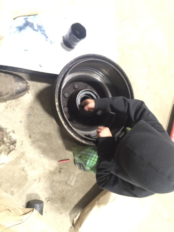

My wheel seals came in so I was able to put it all back together. 3" shoes, 1 1/8" wheel cylinders. Now it should be ready for the new hydroboost system!
Here's my youngest son (4yrs old). Greasing the wheel seal
We'll test drive it tomorrow
