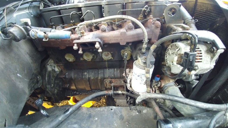

Trans tubes, heat exchanger & tubes all pulled for powder coating.
Tried painting, coating with grease, and nothing lasts. Figured I would do this before I break down again....
So tired of,chasing the rust...

Old Sep 10, 2017 | 03:59 PM
  #4450
That's a big job T-man....you getting all the lines done, even down under the truck as well?
When I do the cummins/auto swap into my Ramcharger I saved about 6-8" of the original tubes and will get fittings brazed on and then run standard HD hydraulic lines.
Took me a few hours to remove all the lines and the heat exchanger. 25 years of ...
Yes the low lines under the truck as well.
Yes its a pain to do, but I can't risk breaking down in the winter.
The oil pan is getting rusty too. Lord knows I don't want to pull that, so I'm at a loss other than oil coating it and hoping for the best.
got to clean them up a little bit of the oil and then drop them off at the powder coating company. They're going to attempt to blast them with a very fine media after dipping them in acid. They're not going to dip the exchanger but all the other parts will get dipped, and coated.
This isn't for visual effect. This is my feeble attempt at keeping this truck,going.
