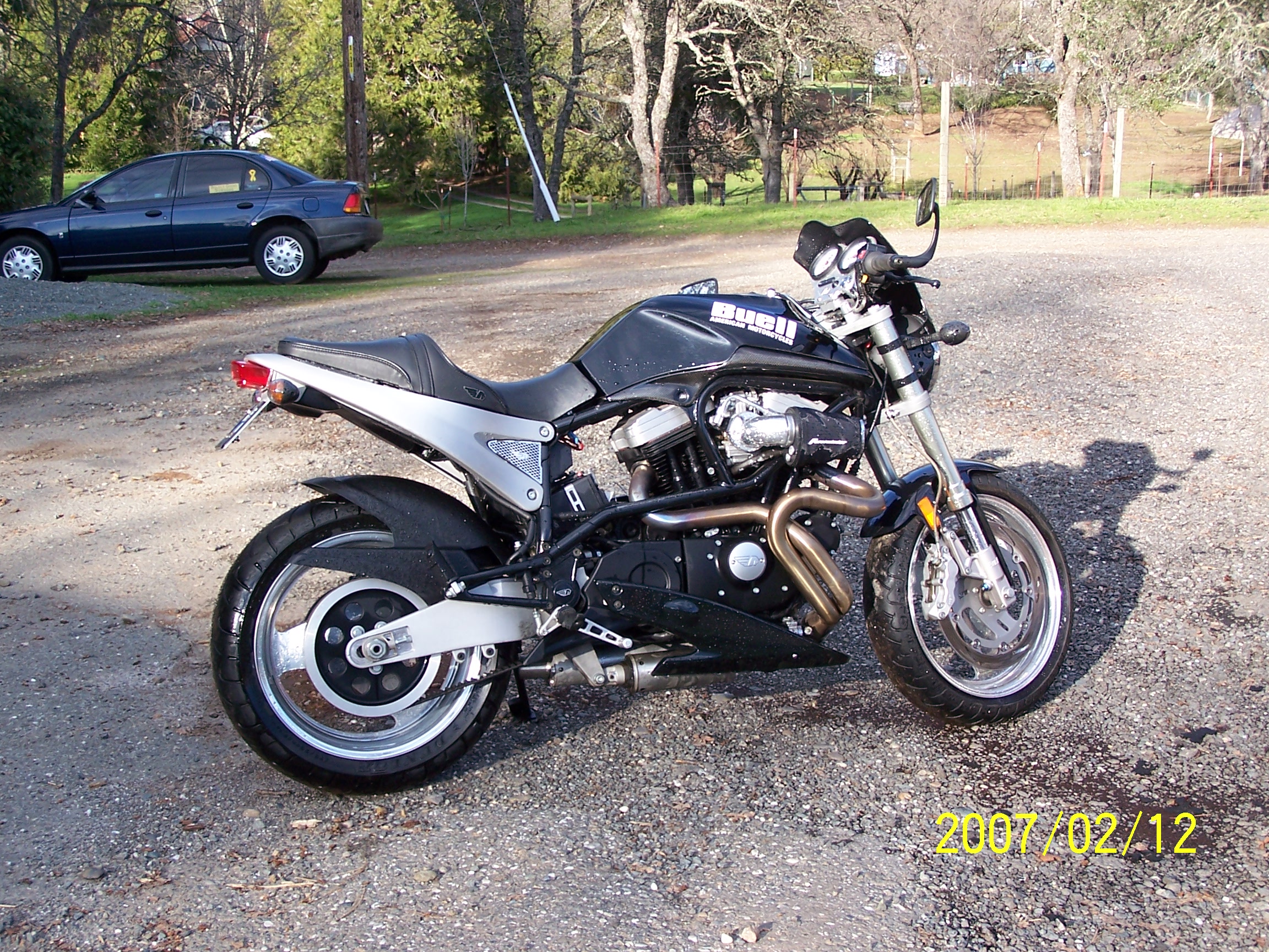

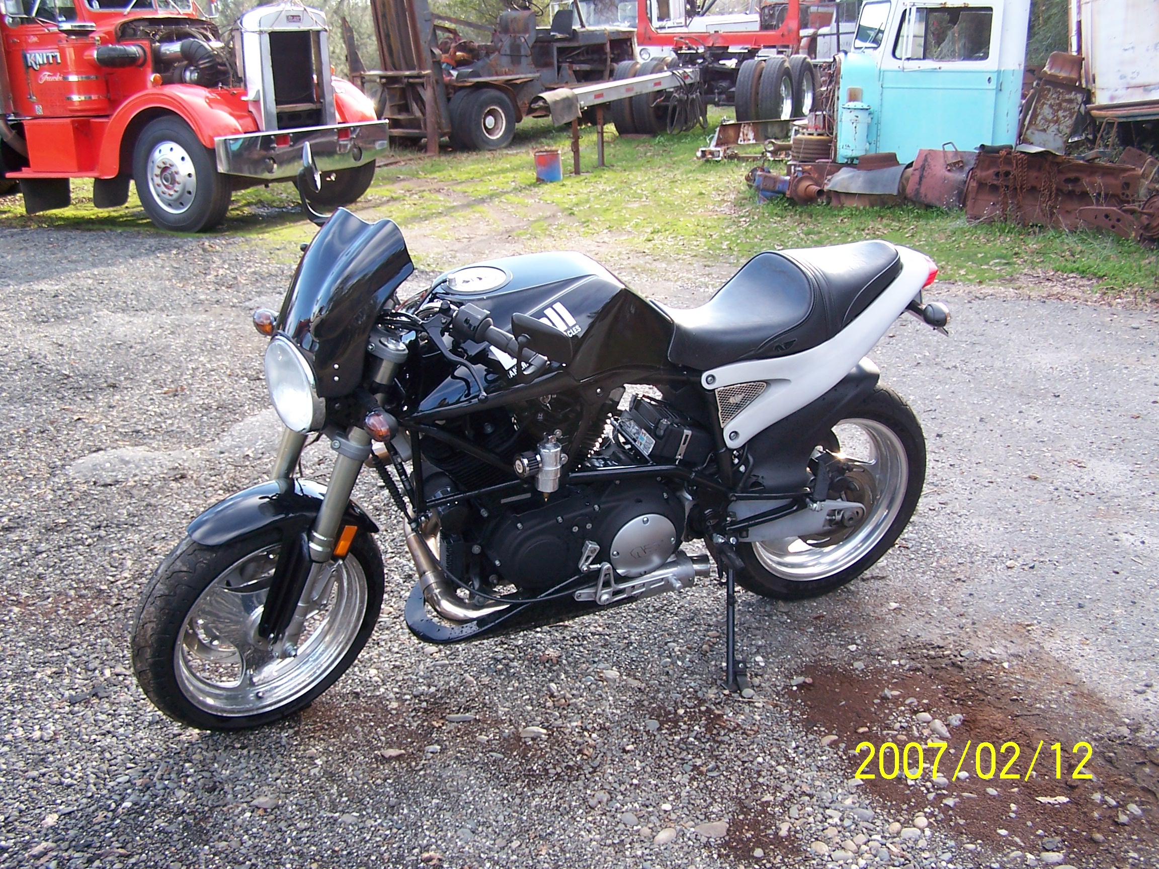

I think today I will dig out my old Buell X1 lightning and get it ready to sell.
I can't ride it any more so I may as well get some truck money out of it before it dry rots. Should get enough to get the truck rolling. Finished not hardly
This is what it looked like when I was last able to ride it.
