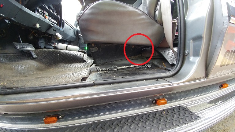

Will do.
once I see how well the fuso rides, I'll order a ford base kit and do some fabricating, as the Air ride kit requires a flat surface to mount, vs our slanted cab floors. I don't see it being much of an issue now that I have my shop all set up for working.
One snag will be the height of the unit, as the rearward most section of our OEM seat stand is only about 2" high. I'm not really tall, (just really handsome) so it should work out okay for me. TC, James Comey, Donald Trump, and all the other zombie giants on this forum might have an issue with it....
I'll do a new thread on the process if it all works out....
