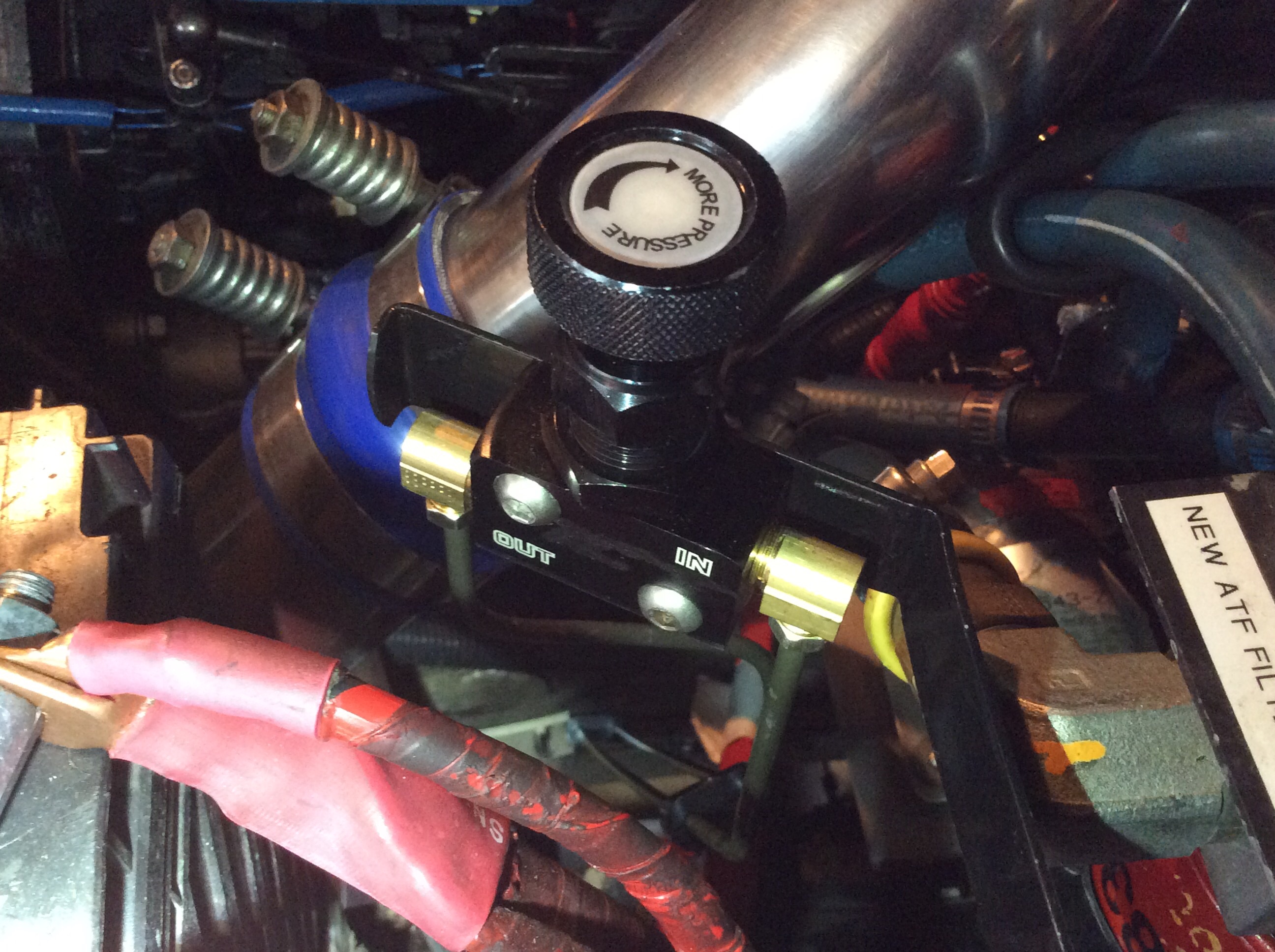

Adjustable prop valve all tied in. The joy of one person bleeding comes next.

Tied all lines right at the departure out of the junction block, to the valve, then back down and unioned at the factory line heading to the rears.
Think I've got the brake line bending down, Mr. Knittle.
Run, Rise, gives the Diagonal length, then the degree of offset. Cake, baby!
Or, A squared + B squared = C squared. Use trig to get offset degree.
Or my wife's version: We = U - I.
Looks good.

Thanks, Mark. I still haven't figured out what to dial that **** to when bleeding. Fully open, or fully shut? Halfway? That's actually a popular question on the net regarding P-Valves.
Open it up until it is bled. Otherwise it will be hard to bleed the rear.

I have an adjustable one on my wagon, and I turned it all the way one direct, then counted the turns to the other side, then started in the middle when adjusting.
I did small increments when braking on a gravel lot, I wanted the rears to lock up just a tad before the fronts. So many up to speed, then locking brakes up later I got it dialed in.

Just curious, Mark and TCows, once your all adjusted, have you ever had to readjust the valve for less pressure in different weather conditions, like snow, mud or rain? Gravels one thing, but you add water to the mix, whole different ball game, I'm assuming?
Not knowing any better as this is my first prop valve install, I'm foreseeing at least two settings for dry and wet conditions? I don't tow, and I know if I did that would also be another setting.
I didn't have to change mine. I scribed a line on mine once I had it set where it worked best. so if I wanted to move it I could find where i started if i wanted to go back.

Thanks, Mark. I plan on doing the same
