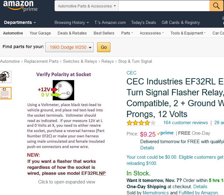

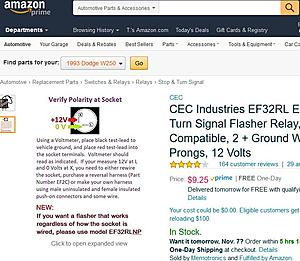

Originally Posted by 73CrewCab
Did you change out the flasher? I’ve got LED taillights from LMC Truck (which work awesome, even with the stock flasher), and haven’t swapped the front turn signal bulbs yet... I know when I bought the LED turn signal bulbs, they recommended a flasher with a ground wire attached to it...
I checked out the specs on these, and I also looked at our fuse panels to see how our trucks are wired. If you go to the specifications for that flasher, it's actually wired backwards to what our trucks are wired (or vice, verse, if you will). In the diagram attached, the voltage on our trucks is actually in the " L " position, which mean's that flasher you posted (where the voltage is supposed to be at the " X " location of the flasher), it won't work directly in our trucks. You can install a reversing polarity plug, switch the wiring in the fuse panel, or buy a flasher that is "polarity independent, such as EF32RLNP listed here:
Amazon Amazon
I just ordered 2 of them, one for flashers, one for hazards. I'll let you know how they work when I install them, either tomorrow or the following day.
Keep us posted. It should work for MY truck, since I have an "EZ Wiring" brand wiring harness and fuse panel. I didn't know that they changed the terminals on the flashers. I thought that the were standard 2-3 prong.... Learned something new today. Now I just need to get off my butt and change out the front lights.
