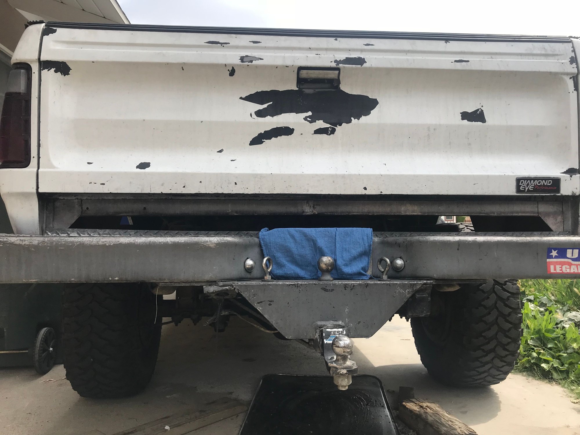

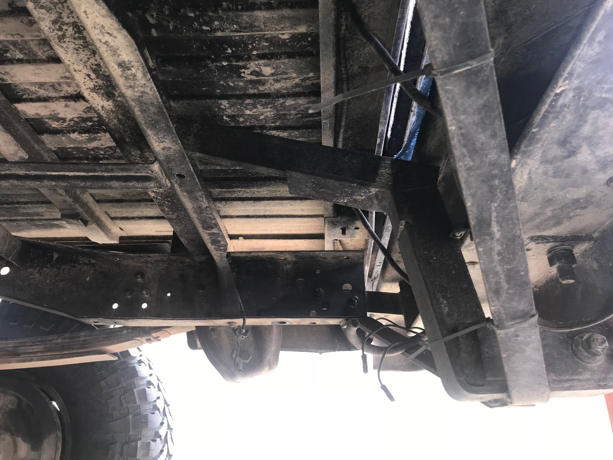

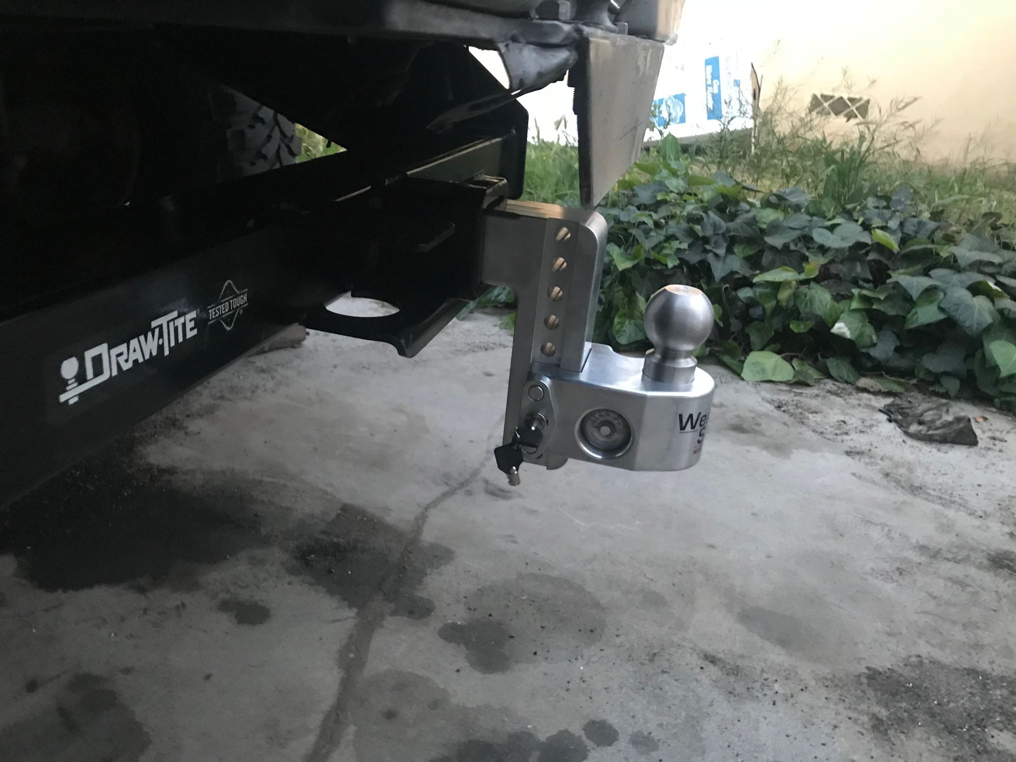

Got the new 2 1/2” hitch installed. Grandpa ran out of steam watching my 3 year old twins, so all I did was bolt the hitch up. It sits too far forward, but it was the best place to line up frame wise. If I can get to the shop early tomorrow, I’ll cut the step out of the bumper with the torch. Hitch fits fine in the drop position, but I can’t flip it to the raise position. I plan on building a custom bumper out of 1/4” plate and tube down the road, so a little hoppy-chop doesn’t bother me.

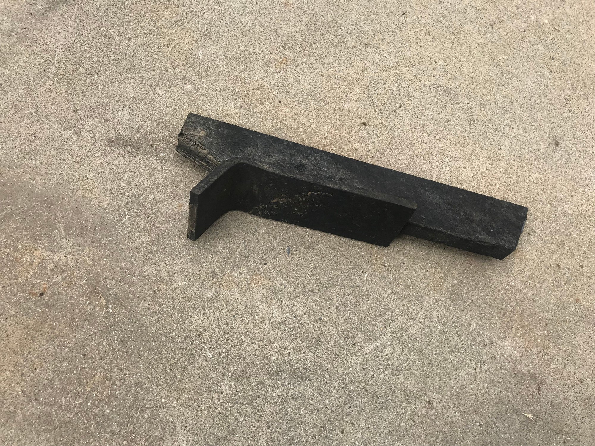

This upper piece wasn’t even welded to the “drop down” piece! When I cut the top loose, it fell to the ground unexpectedly.

What is the weight rating on that hitch? My hitch was customized to say the least by the P.O. and needs replaced.

12,000 lbs and 1,200 tongue weight used normally.
14,000 lbs and 1,700 tongue weight with weight distribution bars. The part number from Etrailer is DT45505
