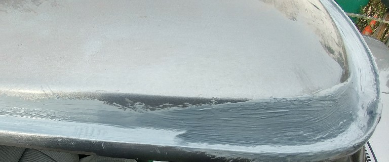

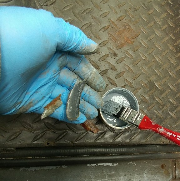

About three or four years ago I brought my truck to a local auto body shop to have the roof repainted. There was no rust on it at the time and the theory was to fix the gutter which was starting to have little cracks in it and repaint the roof before it started to rust thereby eliminating the rust. Since I brought it there that first time with no rust the paint has failed three separate times and now my roof is rotting out. I guess I should have just left well enough alone.
Today I scraped the paint in the rust bubbles off in applied some zinc paint on there after removing some of the new gutter sealant. Seems as though you get what you ask for and now I'm paying for it again. Had paid twice out of the three times it was repainted now I'm going to have to re-pay again.
Has anyone found a fix for this? Other than moving to Arizona?
More than six years ago I noticed the OEM paint on my cab roof had worn too thin and there was some very fine surface rust beginning to show. I took it to the body shop -- they painted the roof and replaced the OEM gutter seals with a 2-part epoxy product made by Teknol (MRS-7204). (The stuff was apparently then being used as OEM on several Ford products; it has held up extremely well on my truck.) I can no longer locate the Teknol product on the web but 3M is making a 2-part epoxy seam sealer that was recently recommended on this forum (3M 08307). But it seems your problem may be more than just bad seam sealer? Sorry I can't be more help...
The sealer "was the new and improved"... yada, yada, yada. The body shop sucks, as I didn't have any, I mean zero rust in there until they got their hands on it.
A small gap formed between the sealer and the metal, which allowed water to enter, then causing rust to form beneath the sealer. The first time they said the guy they hired was not doing his job. The second time they fixed it, they said that "it's your truck, and this will come back".
Well, that's all fine and dandy, if I actually had any rust in the first place, and if they had done the job properly, and were willing to guarantee that it would never come back ..... which is what I was told, that it was never coming back.... they were doing it right the second time around.
Yeah.... Don't believe the bull they say to you.
