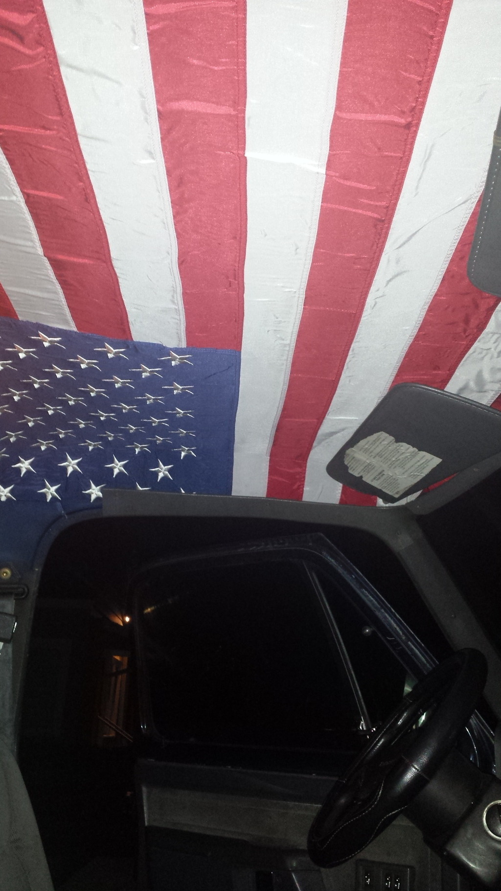

had a spare headliner, flag, and spray glue in the garage. didn't turn out that great, but i'll probably go back to black when i redo my interior
Old Oct 9, 2015 | 08:43 PM
  #1438
Well, that's interesting to look at, but might get a bit busy while driving. Something to get used to, I guess.
I'm sure there are flag purists who would take you out back and shoot you for doing that, but then again....

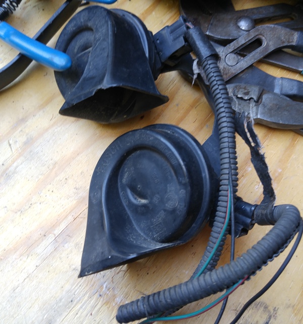

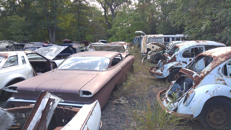

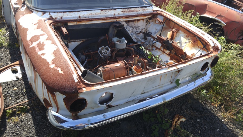

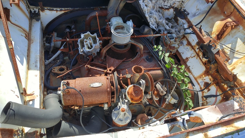

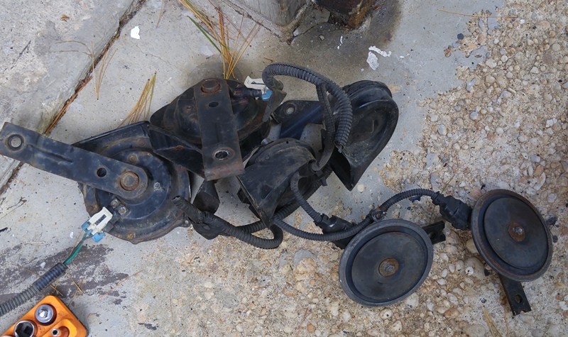

went to the boneyard today, and on the way, saw an old gasser. I found a bunch of new *USED* horns for my trucks. Figured I'd spent $20 and see what I could find. The guy at the boneyard said I looked to be a "bit horny" today. Yeah, but not for him...
Some old cool rides, like that chopped top boat, and a corvair. When was the last time you saw a corvair on the east coast ? Not many of them around.

I added these Dakota horns to my ride, right below the original ones. A little louder than before, but still just as annoying... so I accomplished my goal, I think ???
