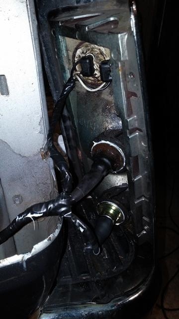

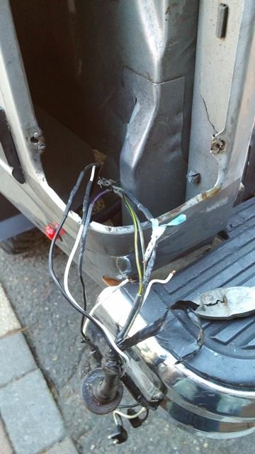

Today, I repaired my bad grounds in my rear drivers side tail lamp harness, and replaced a failed socket for the backup lamps.
The quick disconnect wire harness below was corroded, and the ground was barely functioning.

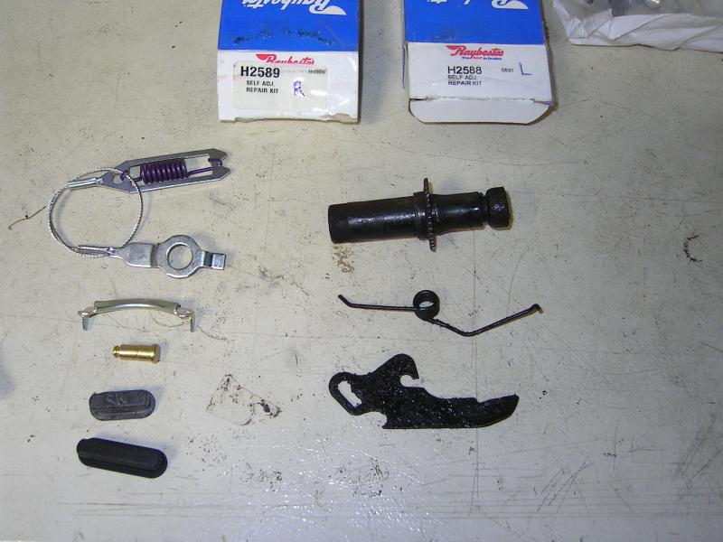

Rear brakes have been squealing and giving me issues since I got back from my winter haul trip. I tried adjusting up the star wheels, but only one side would hold the adjustment. So I decided to get new adjustment hardware kits for both sides.
I decided today I would get this done...friggin rained like crazy, but oh well...if you live on the 'wet" coast and are afraid to get wet, then you will never get anything done on your vehicle.
Here's the kit and the parts I replaced.
When I pulled the LH side I found the inner seal is shot already. It appears that the inner bearing is starting to go. Think on my winter haul trip things got hot enough to cook the inner seal....thank goodness for the arctic weather we were driving in or I could have toasted that hub!
I will be ordering all new inner and outer bearings, and seals, and probably a spindle nut kit to get rid of the nylock nuts and keepers.

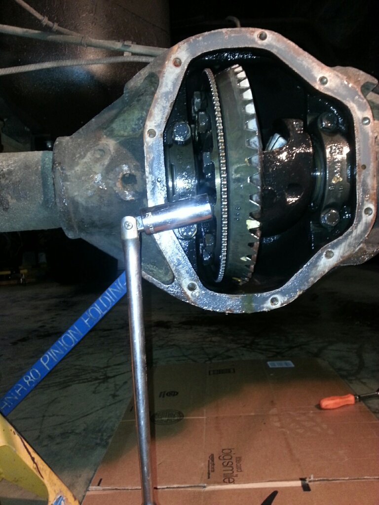

- pinion seal changed
- hub seals changed
- Lockright installed
- shocks replaced & remounted for better angle
Attached Thumbnails What did you do to your Gen 1 today?-20141218_152920_resized_1.jpg   What did you do to your Gen 1 today?-20141218_185631_resized_1.jpg   What did you do to your Gen 1 today?-20141218_193513_resized_1.jpg   What did you do to your Gen 1 today?-shocks_2ndgen.jpg

I put those on my D70 over a year ago. They have held tight. I was a little skeptical at first. Still not sure its as positive a lock as the bent washer tang, or the retained keyway business. Why'd they pick different methods front vs. rear.
