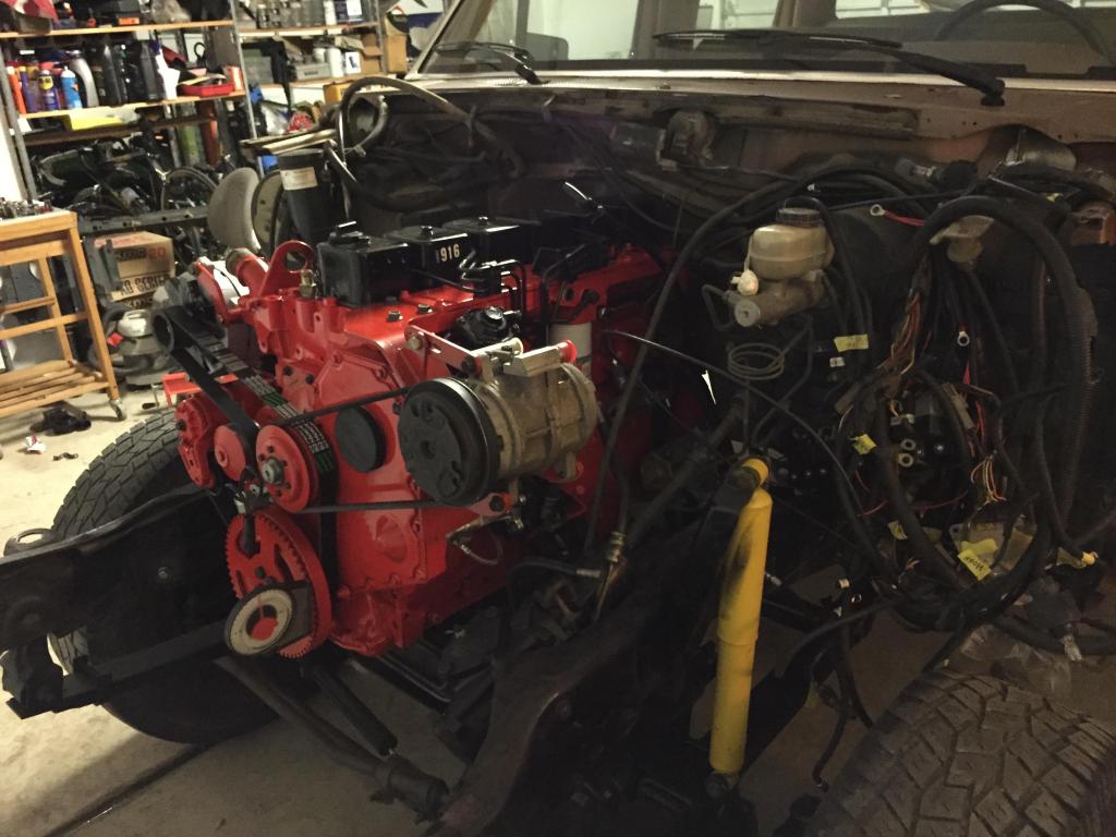

dropped the cummins in the ford
and a bunch of other boring tertiary steps in between.
edit: just realized this thread is for first gen dodge trucks, not first gen dodge truck motors going in fords. *tip toes out of thread quietly*

Papecat...that is a very interesting belt, pulley and accessory set-up on your motor....all industrial parts? Was this by necessity or that was what was on the motor when you got it?

Nice fit on the AC pump but the turbo looks to be a tight fit. Could just be the angle of the picture though.
The motor was stock out of a 1991.0 D250 with 85K miles. The brackets are all from Autoworld conversions. On the fords, the dodge A/C pump location hits the crossmember. It can be cut out and boxed but I didn't want to hack the frame.
The Turbo should have plenty of space, it is one of those industrial/RV type manifolds. The dodge manifold puts the turbo right into the HVAC box, so this is one of the solutions.

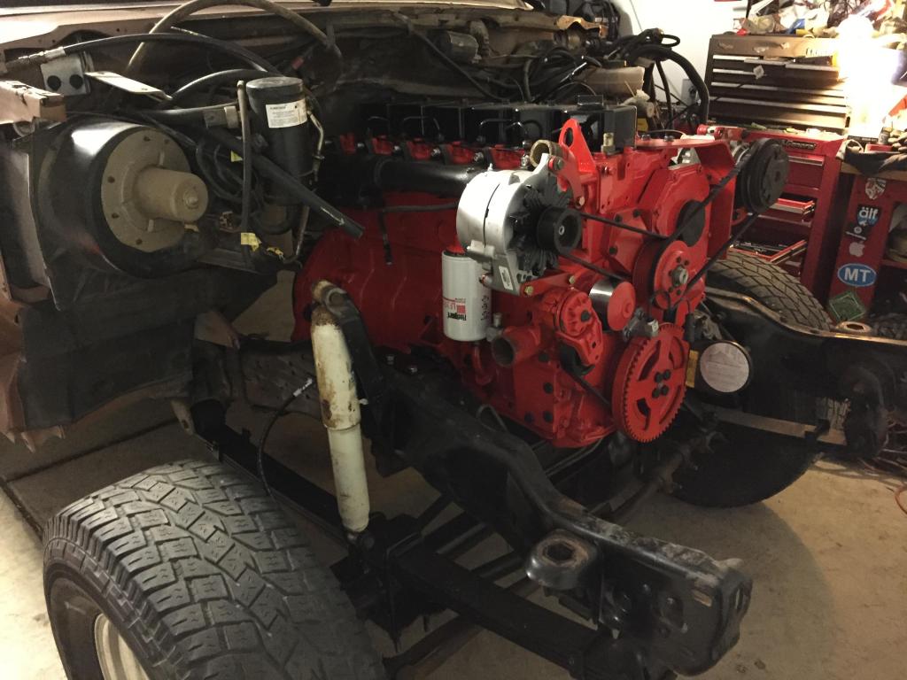

View from the other side. I'll get a turbo slaved in with pic sometime next week.

I suspected the reason for the different accessory geometry was to get the AC compressor out from down low. I could see the potential interference issue that might arise.
I hadn't noticed the rear dump exhaust manifold though. I can see why you need it down low at the back like that.
Looks good!
