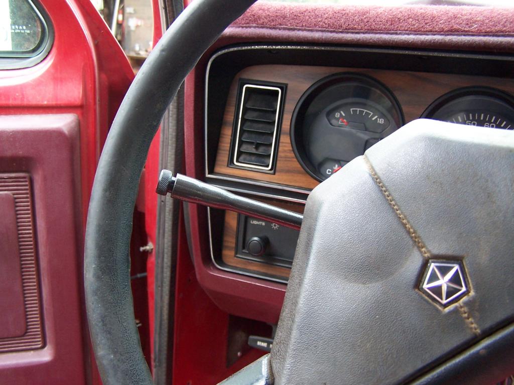

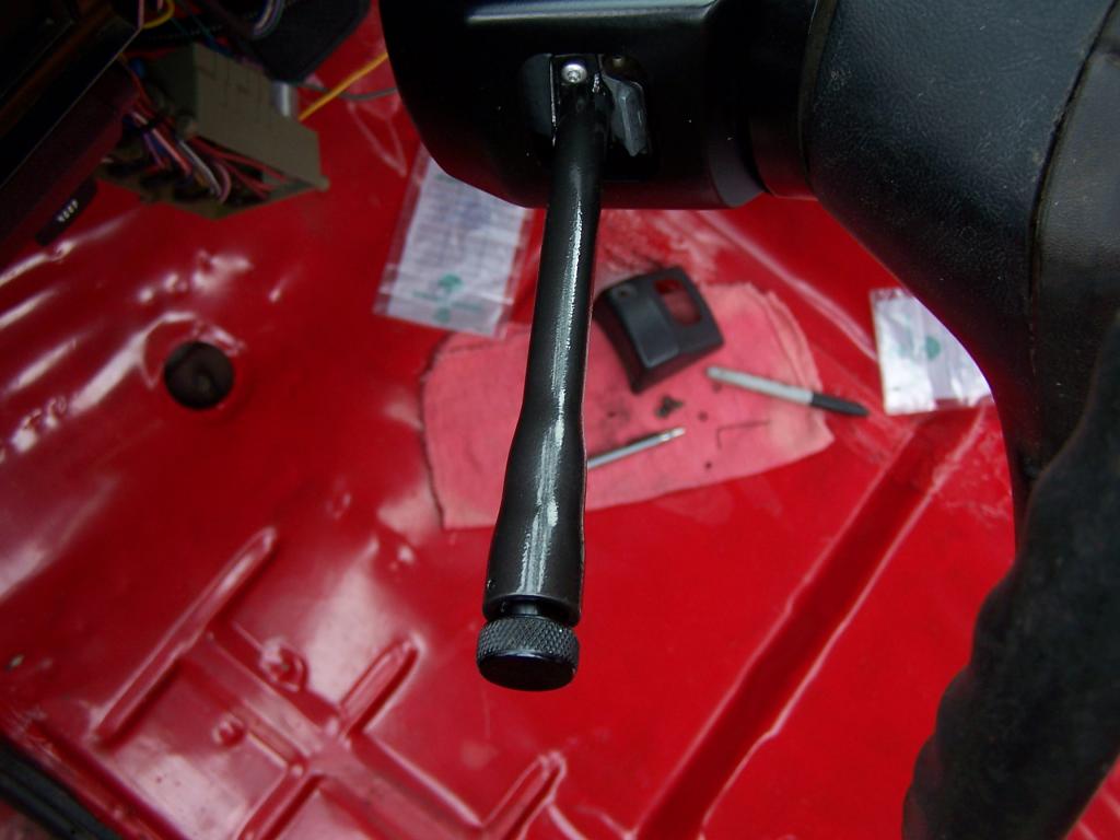

Mounted up and works. That is if the switches are good
It took just a small bit of tuning to get it to work right. on to bigger and better things

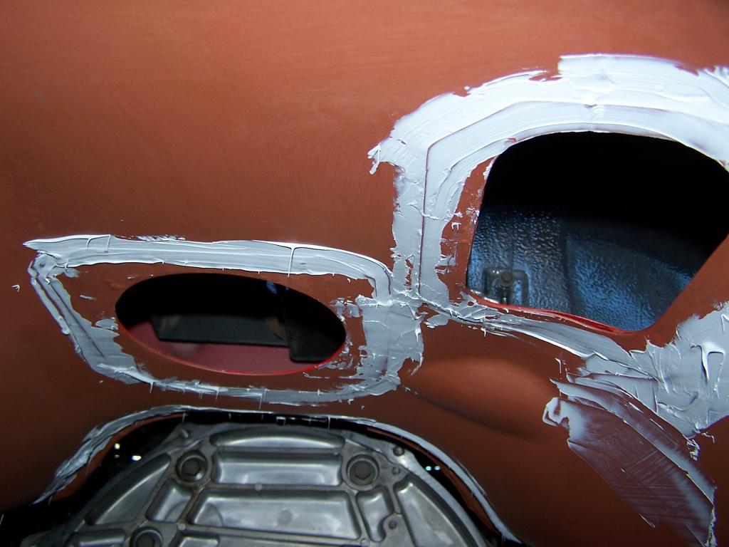

I got the bottom of the floor(trans hump cleaned and treated. I also got a coat of primer on it. Today I will put the seam sealer on. and???

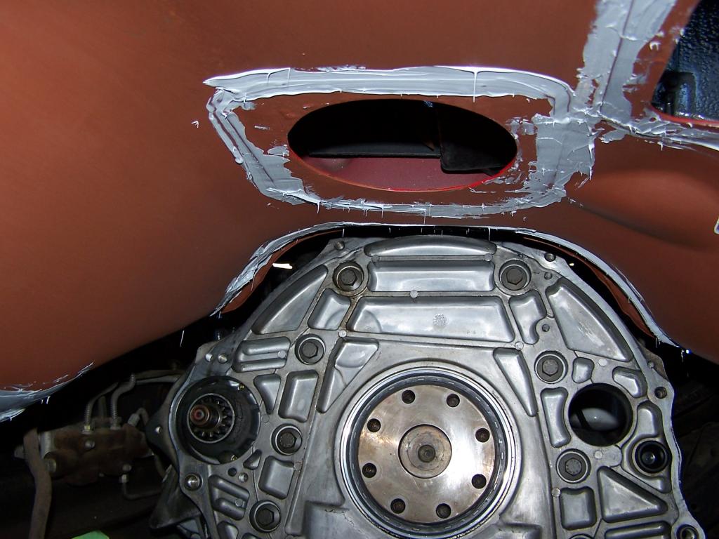

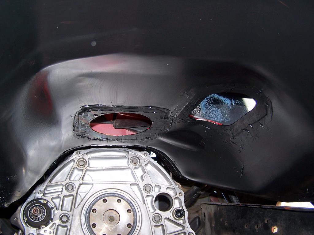

I got the seam sealer spread and put a new main seal in. The next thing is going be hoisting the transmission and transfer case in to drill the holes for the cross-member.
This thing was really clean when I opened it up. I probably spent five minutes wiping it with a rag.
Asyou can see the seam sealer gravity works.
Attached Thumbnails 1990 D250 to W250-100_5393.jpg   1990 D250 to W250-100_5394.jpg

That looks like you spread on icing.... Sure nice and clean under there.
I was like spreading icing with stalagmites. I don't think I have ever seen one that was so easy to clean up. Even though the hump was already bare metal. All I did on the rest was wipe it off a couple times with a rag soaked with mineral spirits.

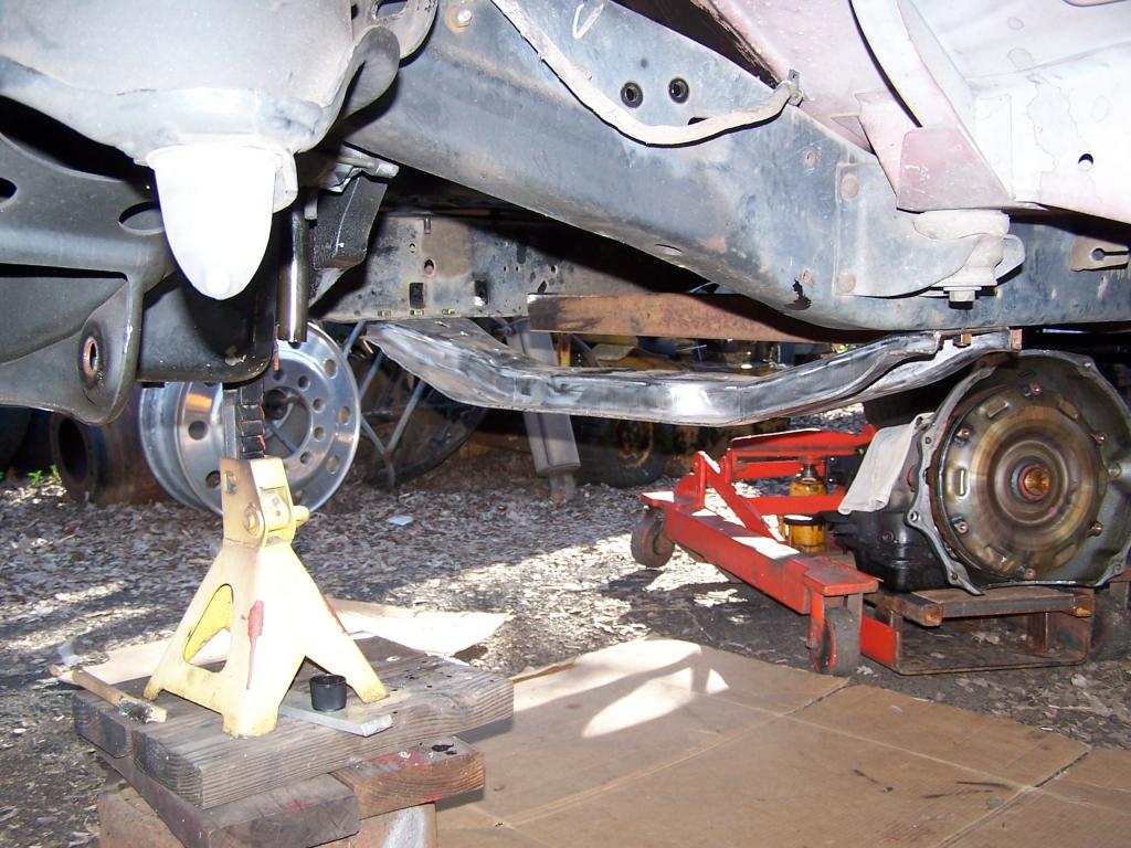

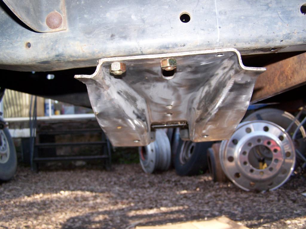

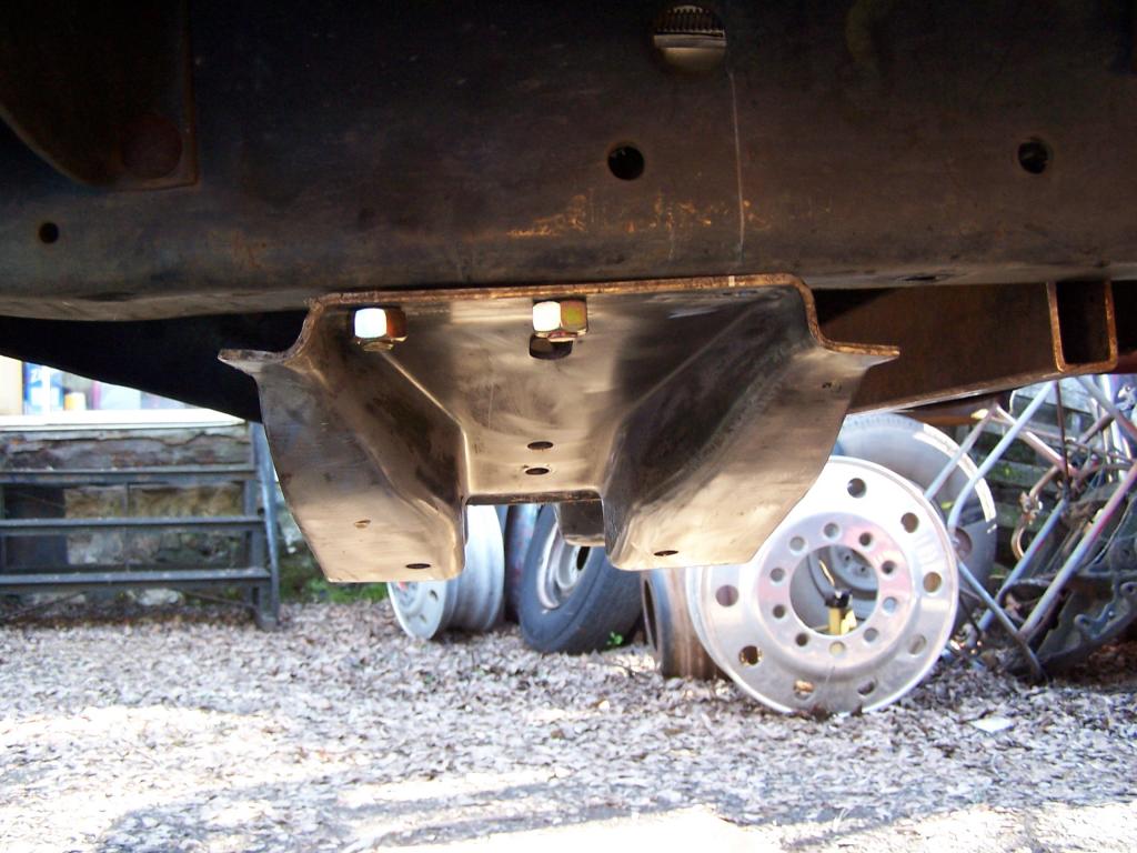

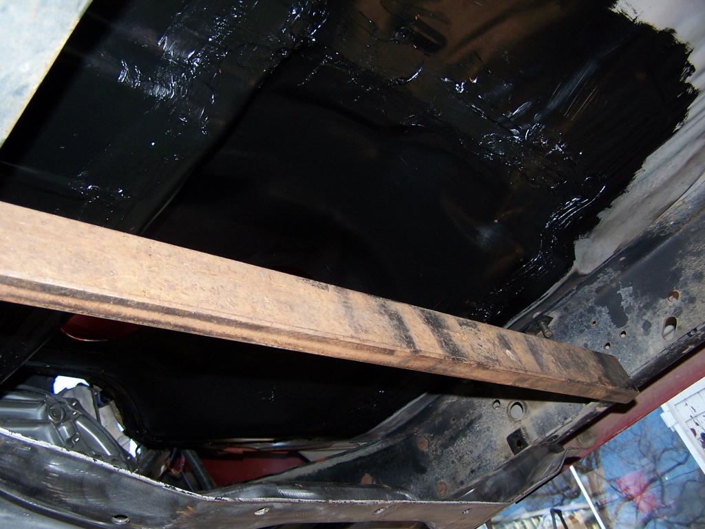

I had some fun today. I located and drilled the transmission crossmember. I spent some time measuring my dads two trucks. and determined that the rear most hole was .250" to the rear of the factory reference hole. under the cab. After a bit of searching I found a piece of 1" round bar stock with the end turned down that fit perfectly into the hole. all I had to do was use a square to draw a line down the frame and mark the crossmember. I lined the marks up and centered the crossmember side to side. then devised as many ways I could to prove I was in the right spot. transfer punched and drilled.
The piece of tubing in the second picture is to spread the frame where it bowed in a little.
I have a couple holes to weld up then I can tackle the braces.
