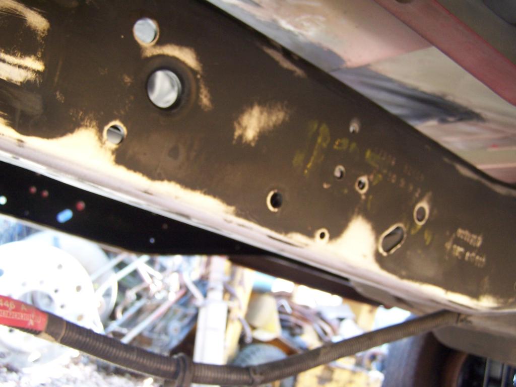

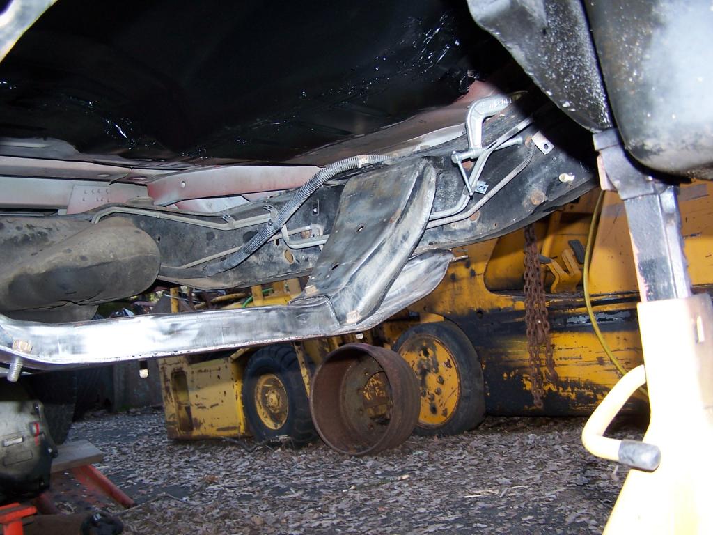

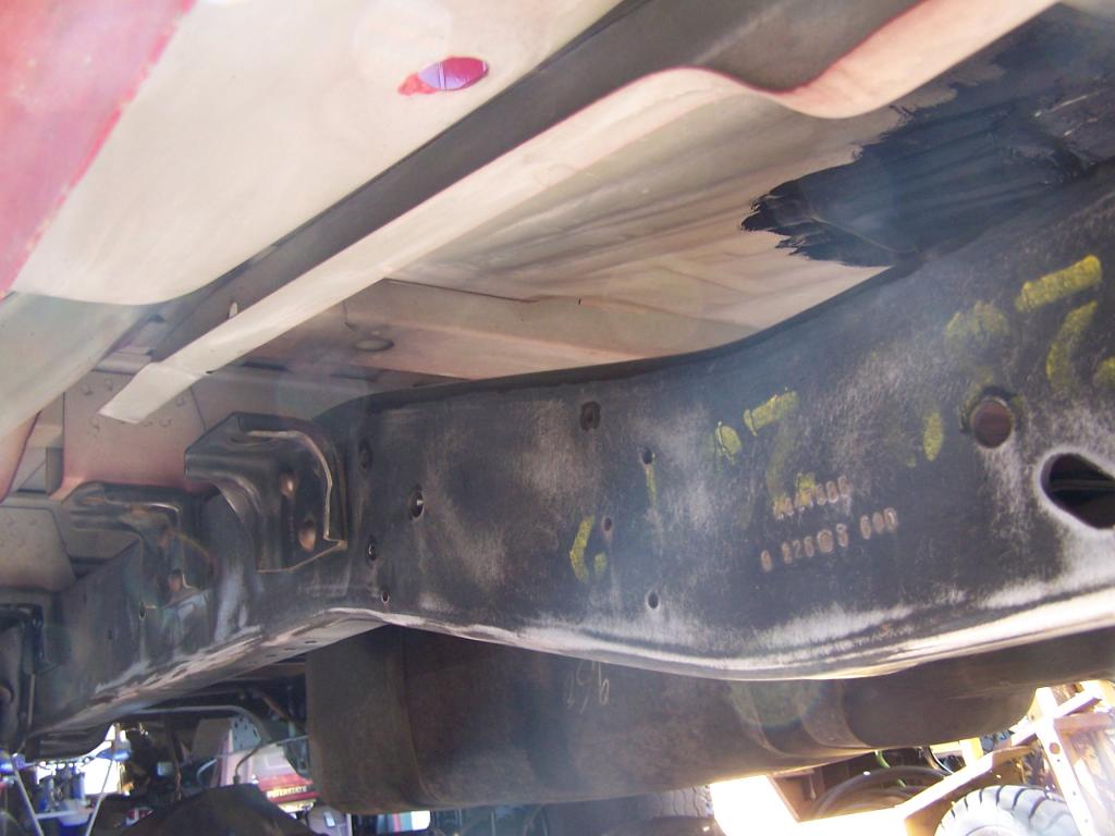

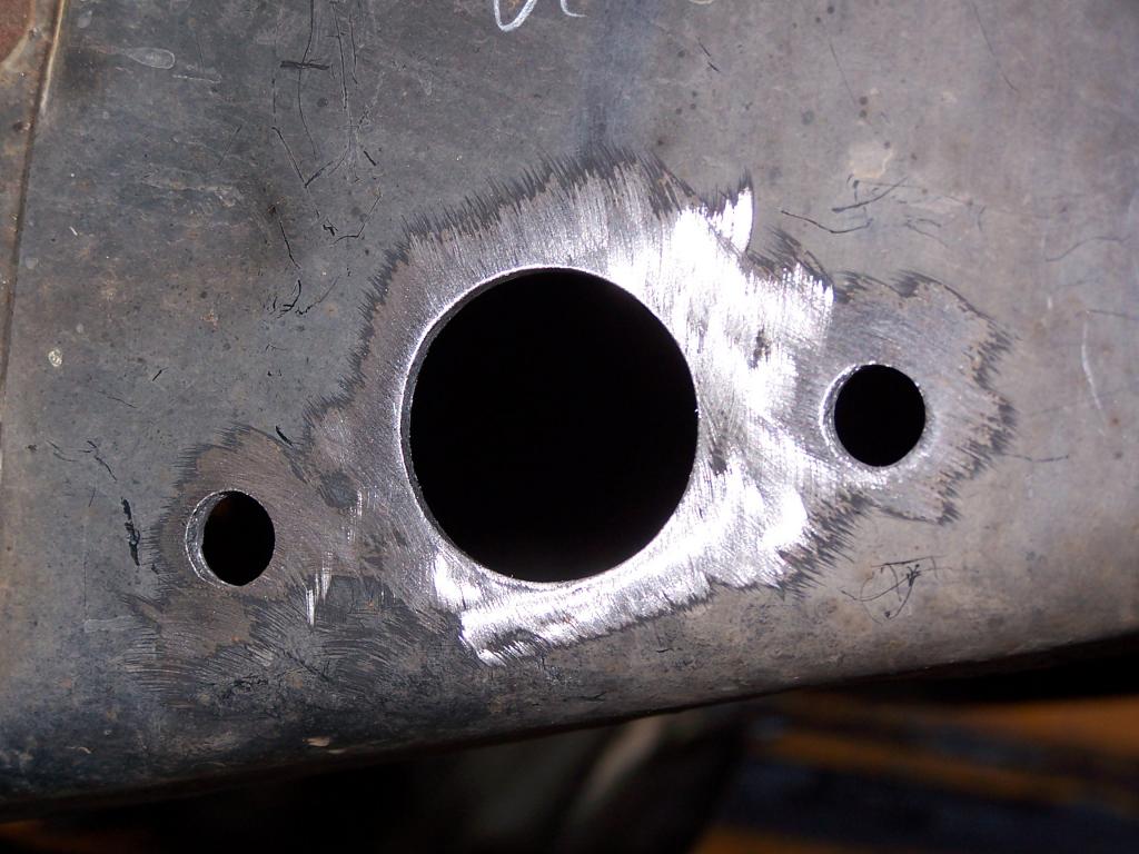

Well todays progress. I did a bunch of measuring and marked and got one of the 2 1/2" holes cut then broke the hole saw. so I had to go to Home cheapo and get a new one. After I got both holes cut. I transfer punched and drilled the two 1/2" mounting holes. I have to drill the topones from the inside.

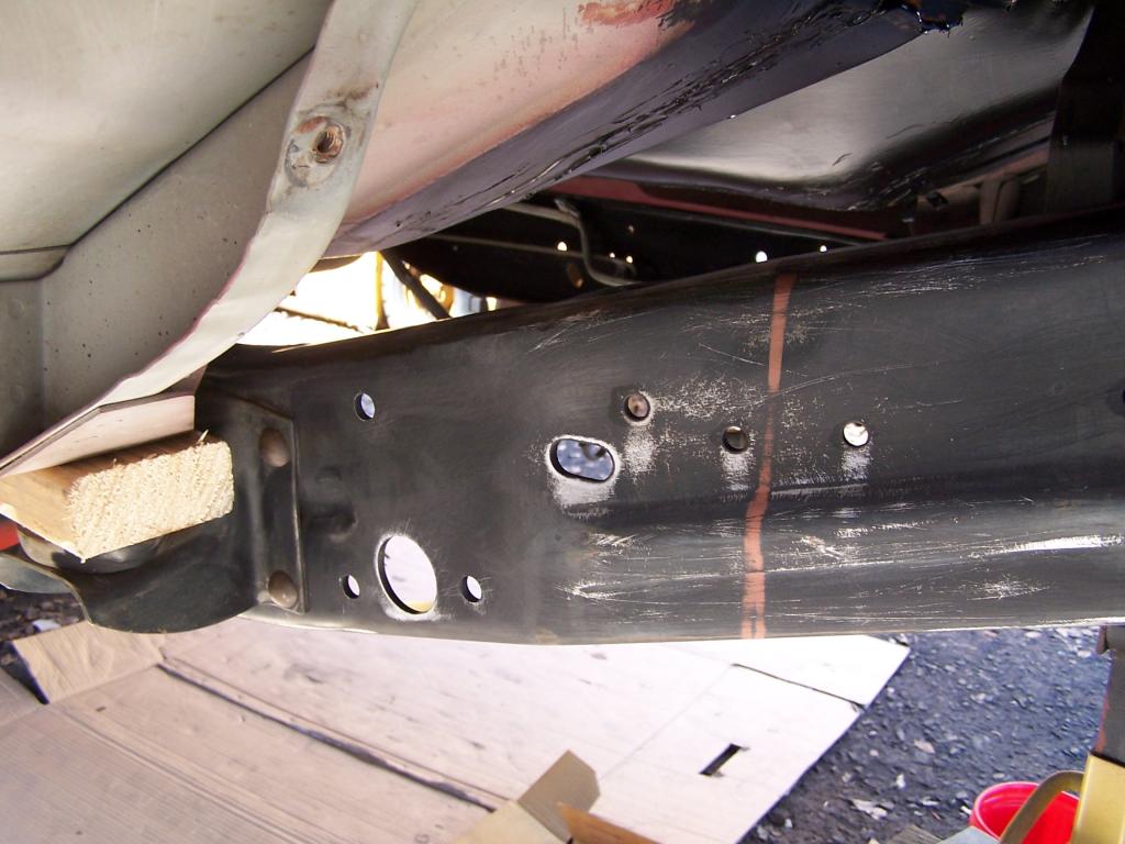

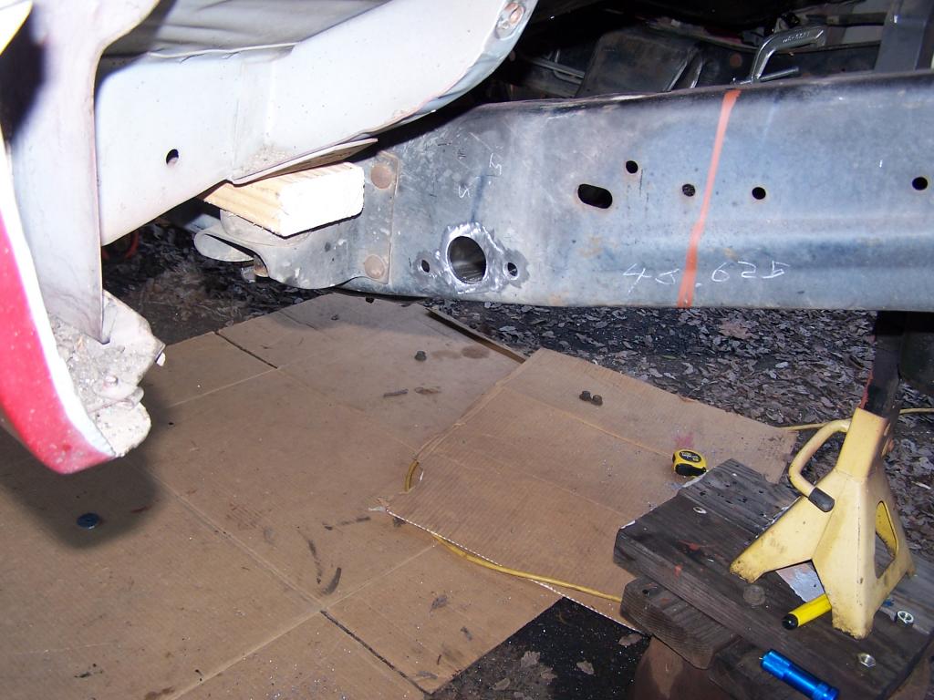

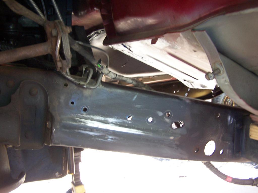

I welded up the holes in the frame that were too close to where the new transmission crossmember are. then drilled the last one. there were also a couple too close to the rear front spring hanger on the left side. once all that was done I sprayed some Rustoleum Rust reformer on the bare metal as it is supposed to rain tomorrow and Saturday.

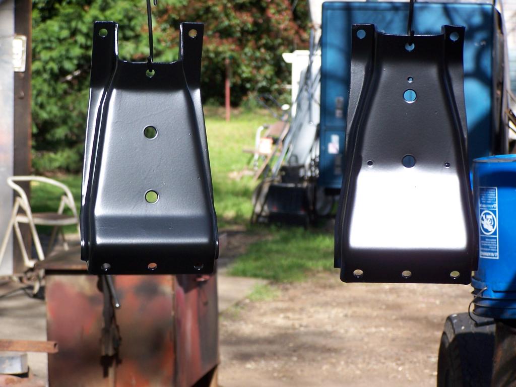

Well 7 months later and I am almost ready to paint some more frame. And not with a brush this time I have a few more spots to clean up this afternoon and a couple parts too then maybe tomorrow primer.

I gotta say every time I see south west rigs that are THAT rust free it blows me away.
All I did was skim it with the DA and hand sand a little with #80 grit. I also have a 1952 GMC frame that is not much worse.

Blah blah blah and nanny nanny boo boo!
I'm with you oliver, I can't believe you can still see the painted numbers on the frame! Around here you leave that kind of thing as proof to how CLEAN it really is.
I am jealous, looks amazing.

I had to do it I am pretty happy with it

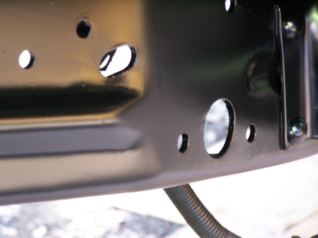

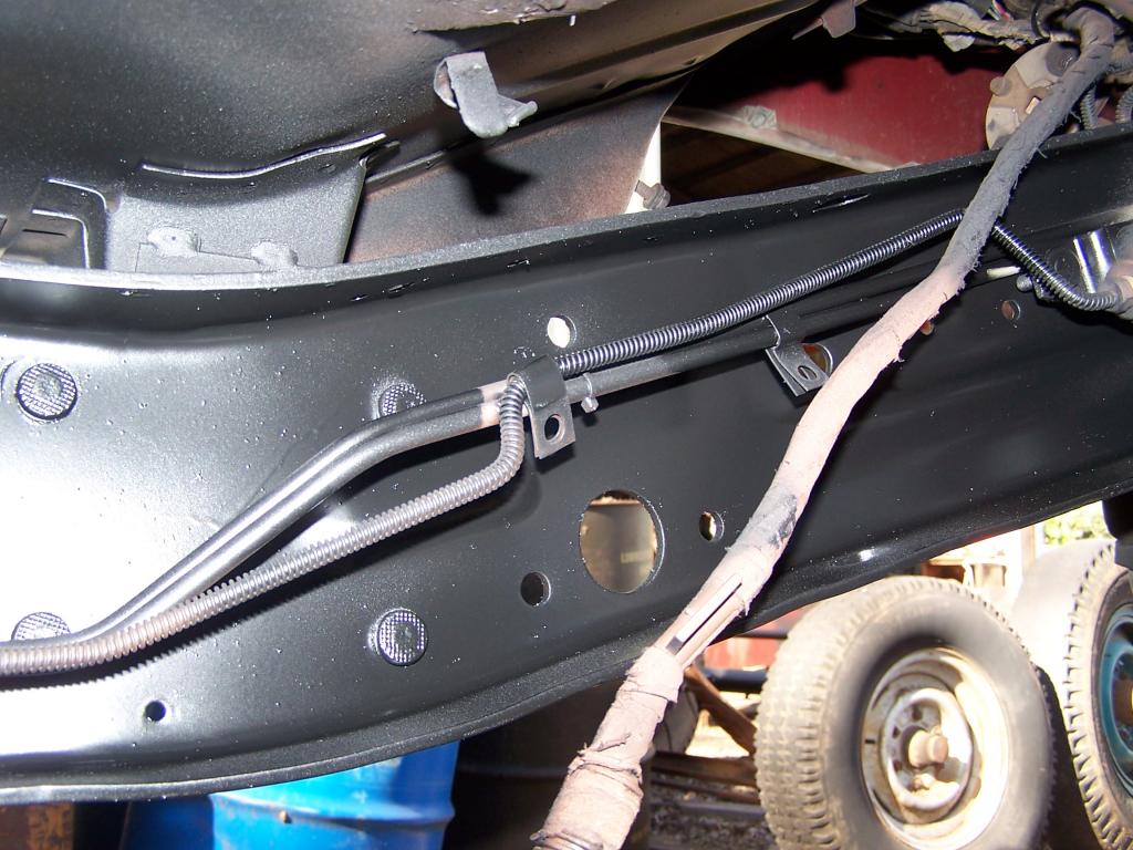

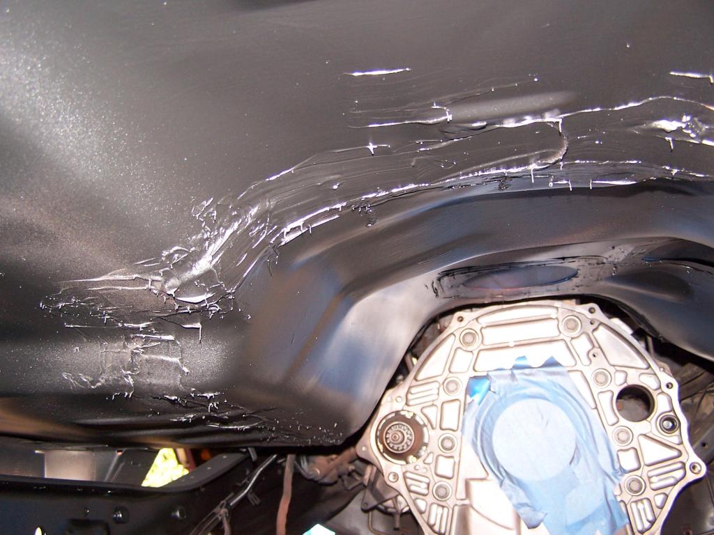

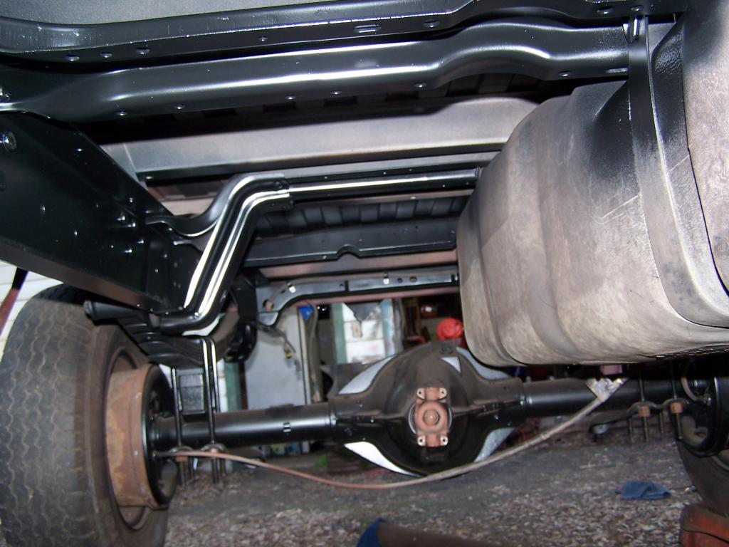

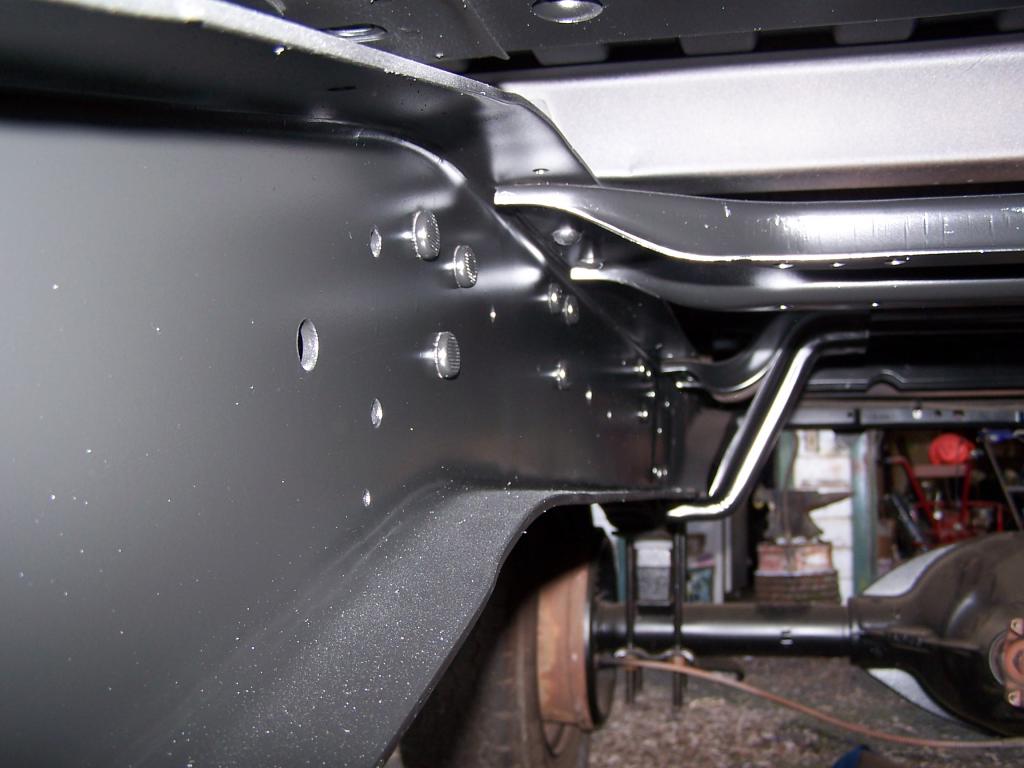

I got a little color on the frame and...

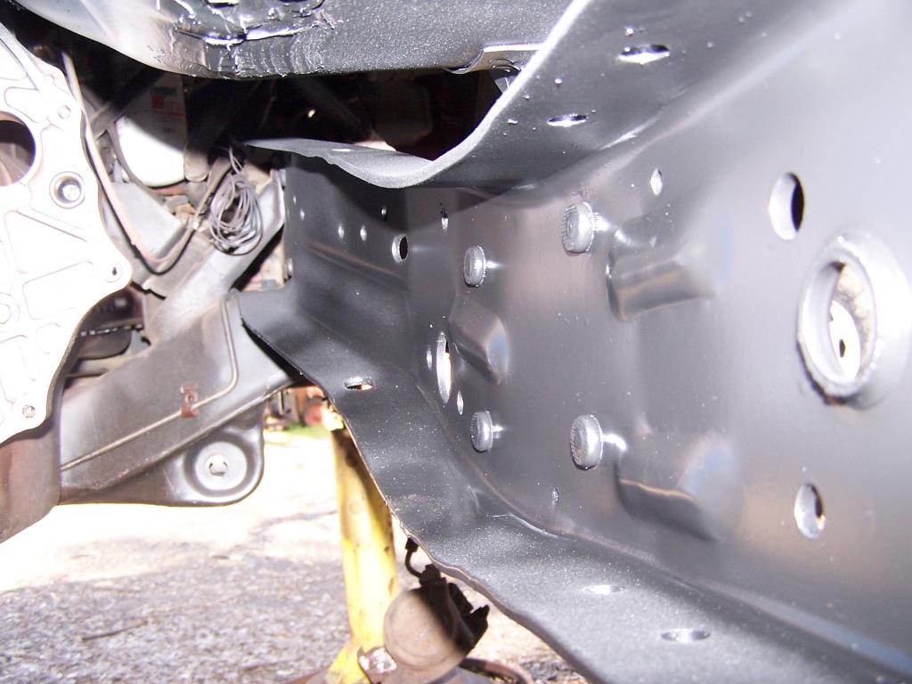

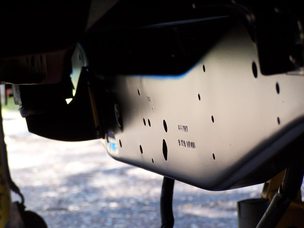

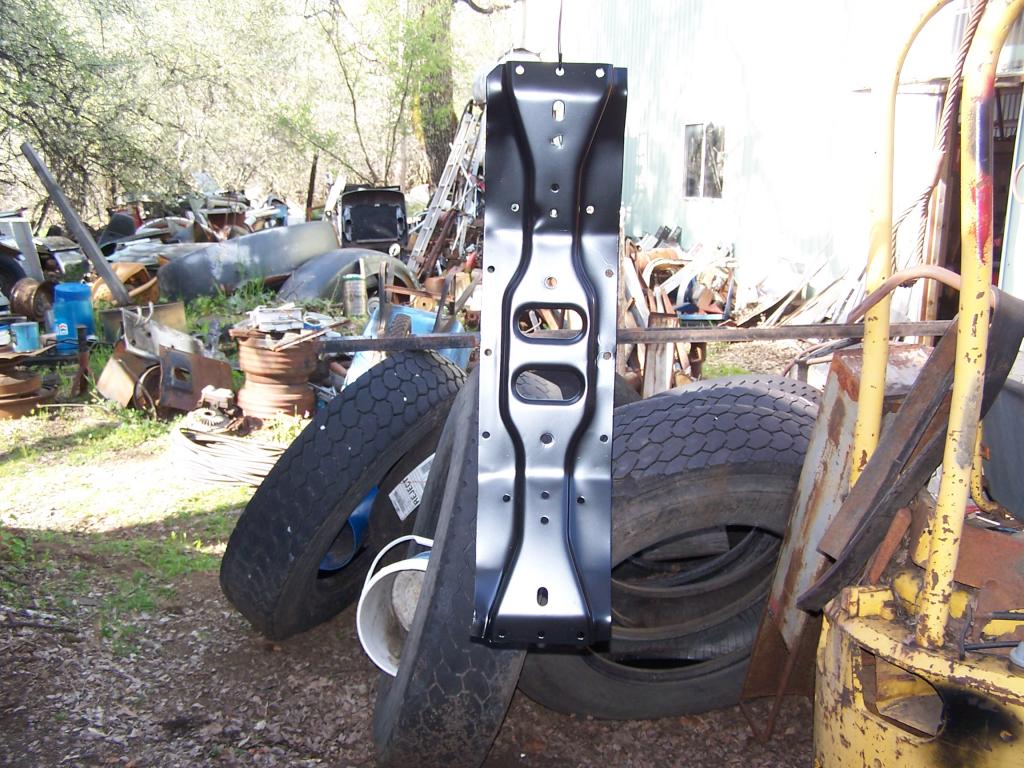

And..
Could have been better could have been worse. At least the majority is done.
