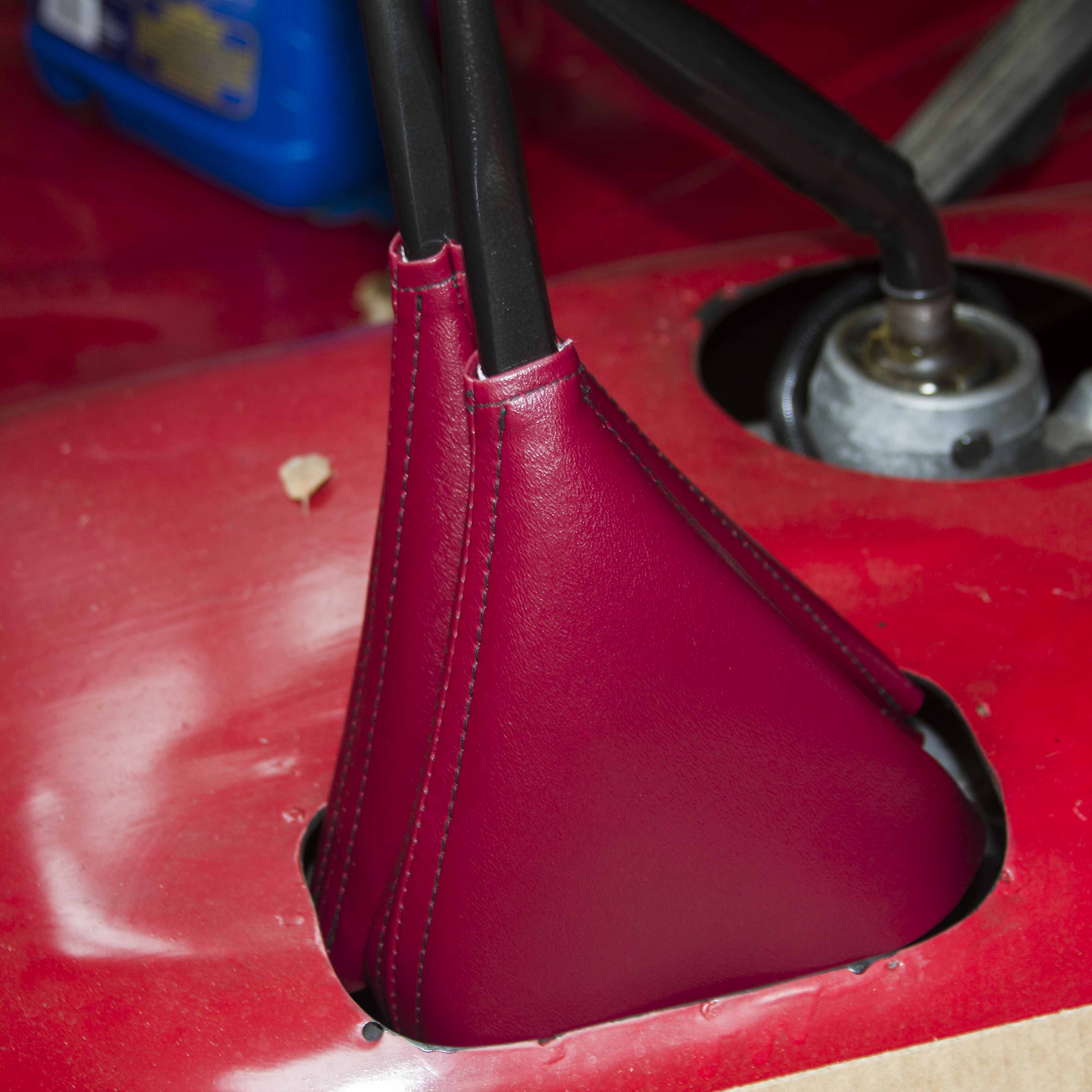

Today I stitched up my prototype transfercase shift boot. Here is a test fit. so far so good

You sew too ? Very clean looking...
you'll make a nice (house) husband for some lucky lady some day.....

Thanks T.
I 'm no expert, I am just learning. I plan on doing my Dodge for practice.
LOL my sewing machine will eat my wife's alive

Looking very nice Mark! I wish I had your skills with the heavy duty sewing machine.

Thanks Mike, I have a long way to go to get where I want to be

He isn't the only member with a sewing machine.
Mine is a Consew 206 RB model.
With our type of machines it isn't hard to attach a finger if you do an oooppppsssss.
The boots look good. You going to glue some type of sound deadener to the inside. A single ply will let a lot of road noise in.

Thanks Philip,
Mine is an old Singer 111W153. We figure it was built in the late 40s. When I got it the timing belt was a woven cotton band with what looked like staples made of round steel stock. I got a new rubber one and figured out how to Tune it now all is well.
Yeah I will glue something in the boots and maybe make a flat piece of vinyl or leather with a couple slits in it for the bottom.

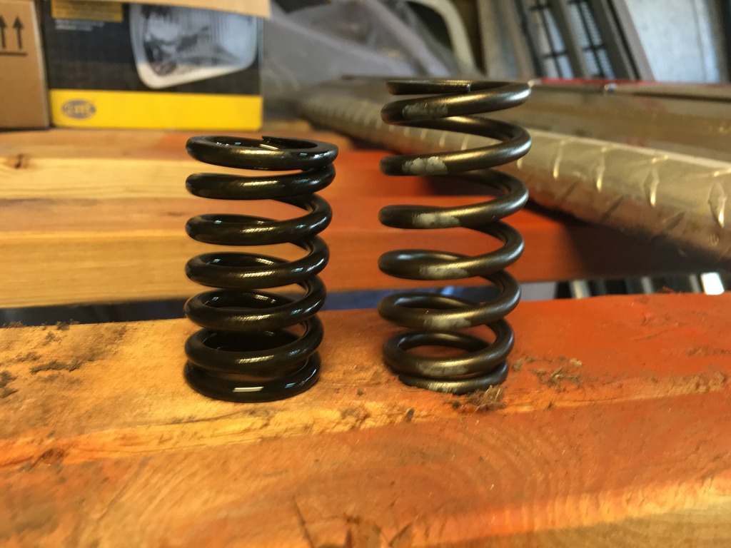

Mighty Diesel head bolts, 60# springs, valve cover gaskets and seals. and a touch of hemi orange and black paint. set valve lash to .008/.018. Truck seems to run smoother at all speeds/rpm. especially smooth on the highway at 2000 rpm. took the girl for a ride today. one of the first things she said was "did you do something to make the truck quieter?" i guess the fact that they were ~.015/.025 to start with was making a lot of extra clatter. Good news is it seems to have held together after starting, lmao. Some truck ****

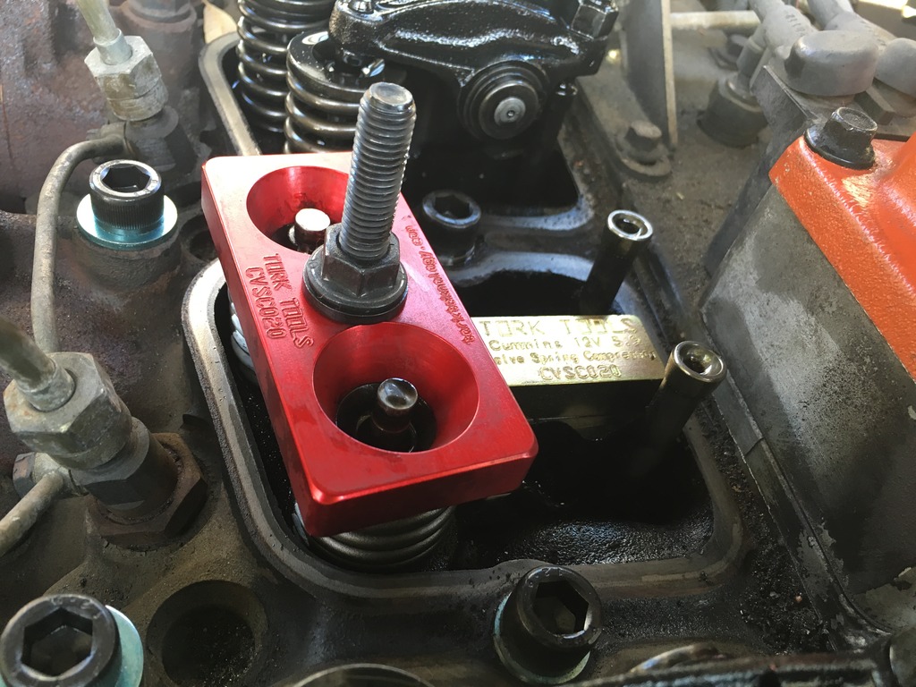

My new favorite tool

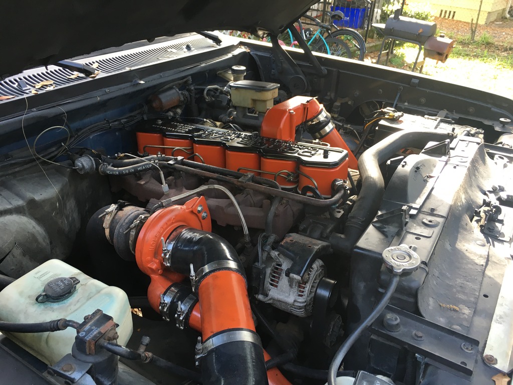

And still trying to polish a turd...
