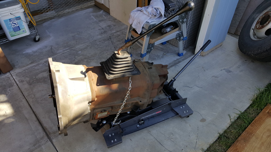

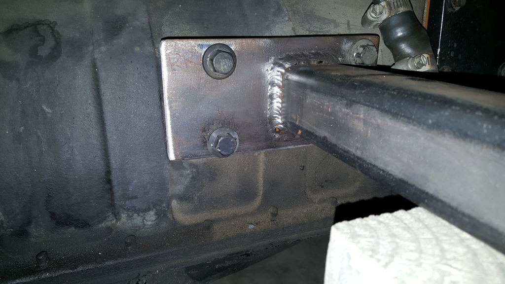

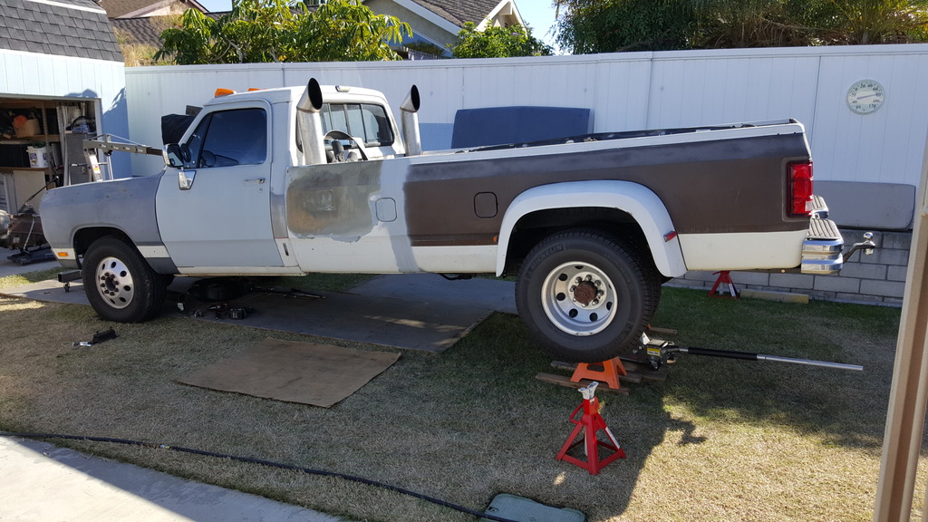

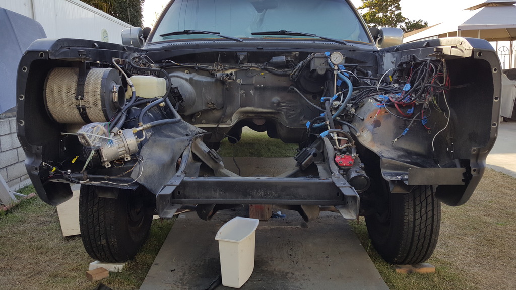

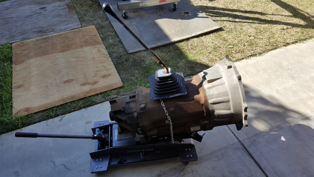

I got a lot of work done last week.

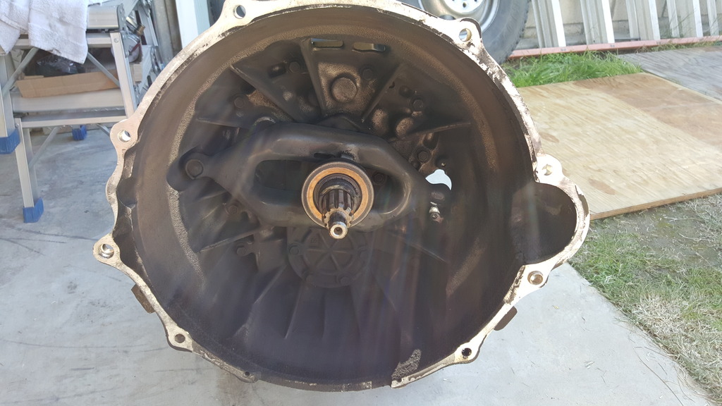

Wrestled the beastly, 360lbs. (dry) NV5600 out from under the truck.
I probably should've put the front-end up on stands . I will when it all goes back together.
The front end sitting a bit higher just from removing the transmission.

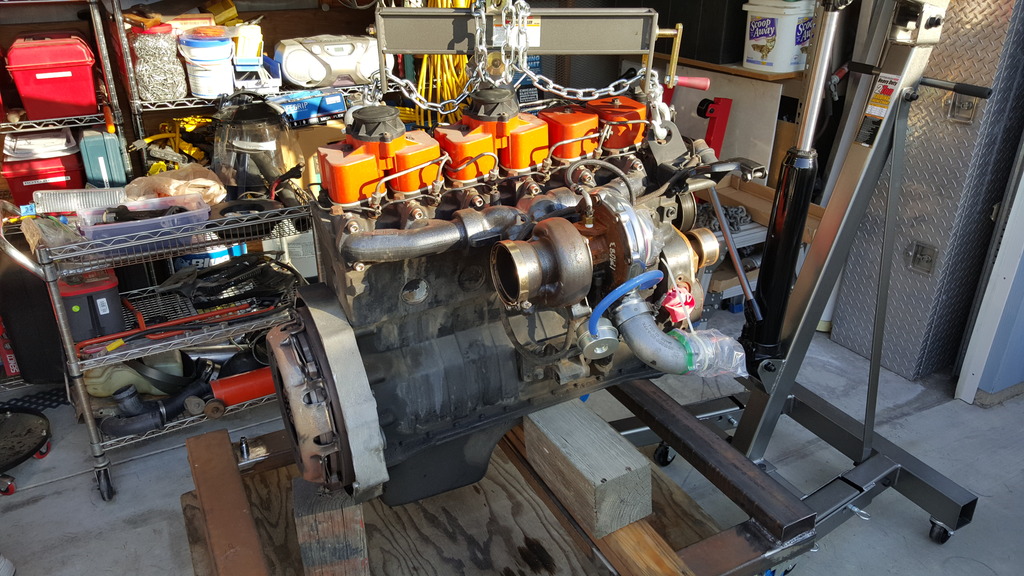

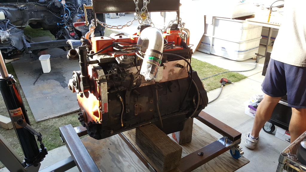

As of Friday, the elephant under the hood is out.

Looks like you've got alot done and alot to do. Very nice. I regret not going with the NV5600 when i swapped from the 47RH instead of the NV4500 That extra gear seems like it would come in very handy

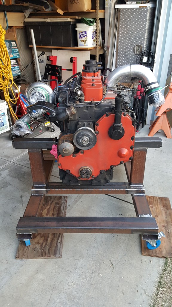

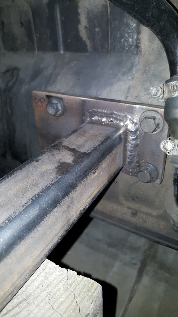

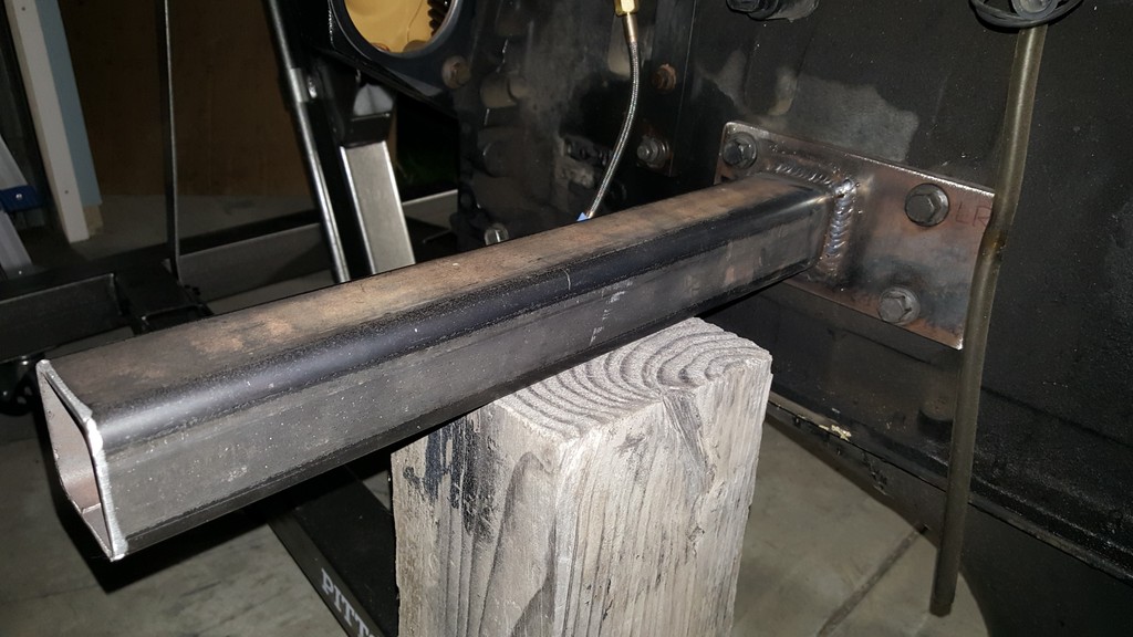

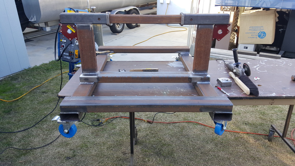

More from Friday. I fabricated the motor mounts to attach the engine to the stand I built. After setting it on the stand, I found that the 2" tube is forward of the balance point of the motor. I should have either centered them or set them towards the rear some instead. It's not a big deal though because I'm going to build supports for either the front and/or rear to secure it better.
The engine stand is mostly complete. Still need to add some gussets in a few spots as well as front and/or rear supports to better secure the engine.
