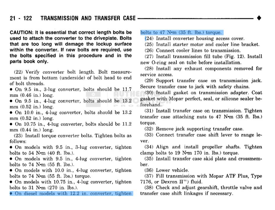

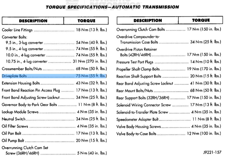

Can anyone here confirm the torque specs for the driveplate (we call it a flexplate) as the numbers I'm reading seem so light.
According to the FSM I have, the driveplate to crank are supposed to be set to 55 fl lbs, and the torque converter bolts to the flex plate are supposed to be 35 ft lbs ..
Can one of you guys confirm these ?
Most appreciated.
Attached Thumbnails What did you do to your Gen 1 today?-torque-spec-converter.jpg   What did you do to your Gen 1 today?-torque-spec-transmission.jpg

Well you miss a day and look at all the posts....
T-man....hope all goes well, and Augie has some darn good points in his essays.....
As for the the torque ratings...that seems about right.

Thanks.
I have an offer from a guy I know from another forum who said I could bring it to his shop and we'll knock it out in a jiffy. Just ordered all new bolts from the dealer he deals with as he wanted to replace all the hardware during the changeout. 15 bolts and one reinforcement ring were $108.78
