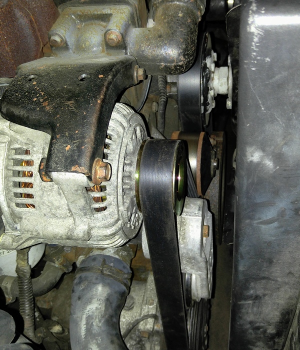

Today I'll be installing a new alt pulley to see if J. Martin is correct why my belt squeals from a worn out pulley.
Post results later

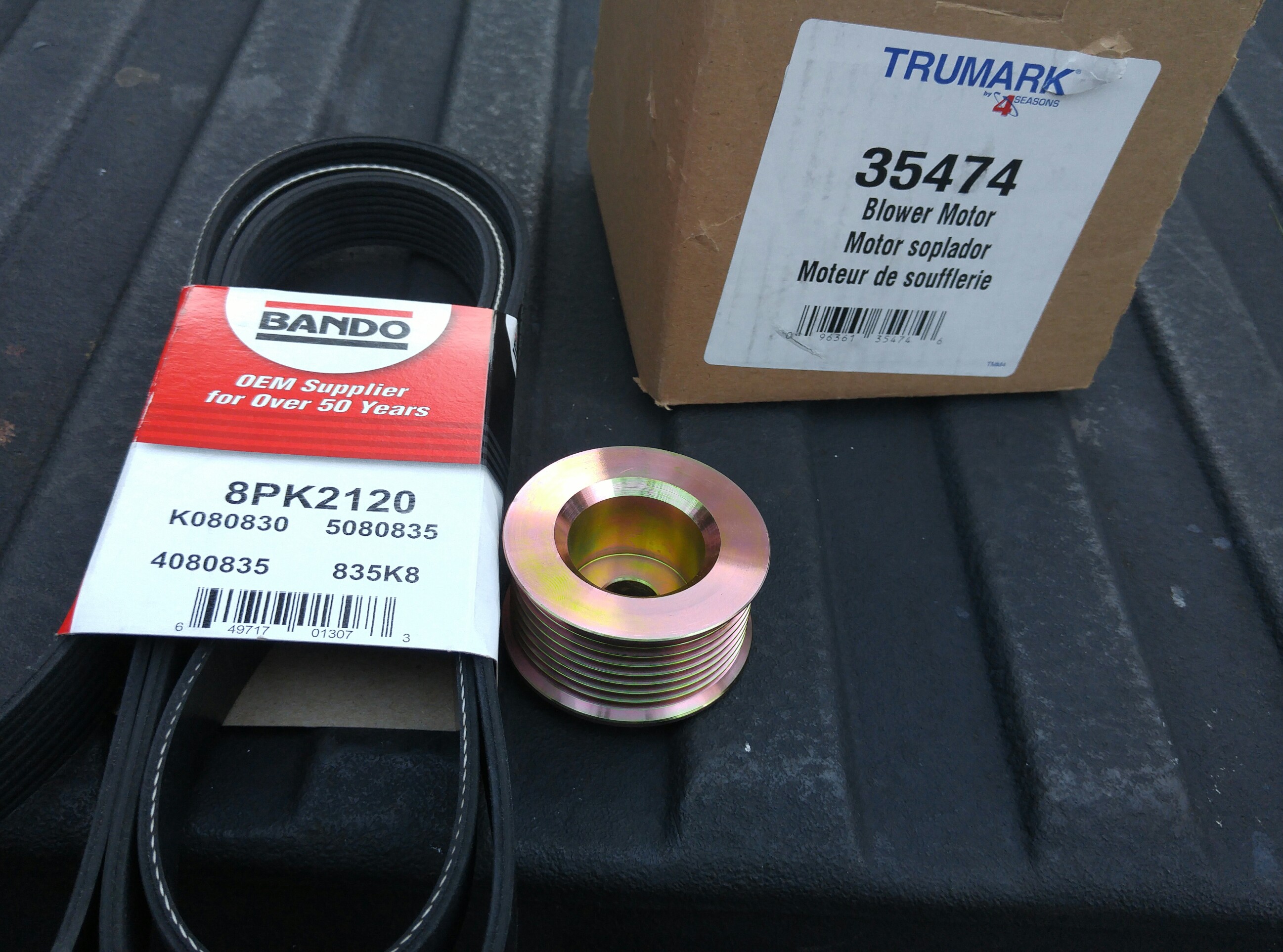

Today, I (besides having my flex plate crack) replaced my alternator pulley and belt.
Replaced just the pulley, and the squeak was still there, unchanged from the old pulley.
So, then I put a new belt on it. Squeak is gone. Whatever is going on, it's definitely belt related.

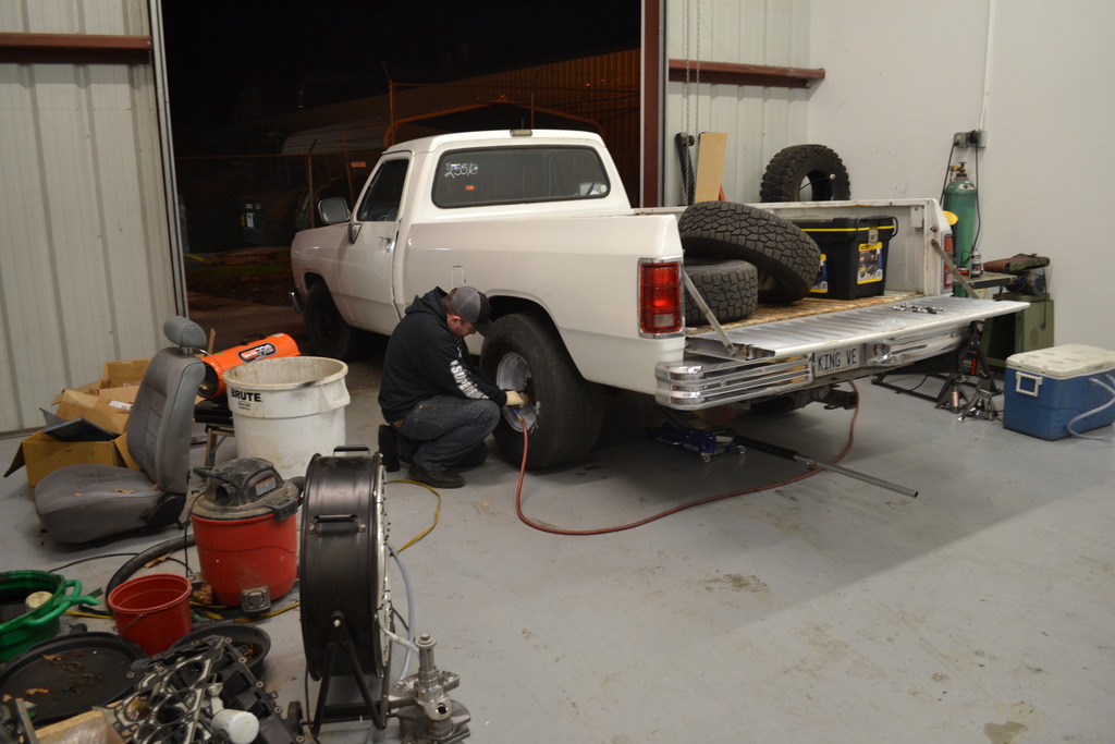

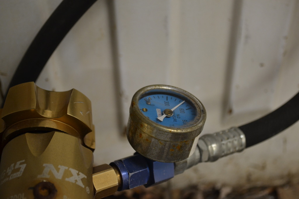

Did a little street testing....learned a little, but not too much. Ran on a data logger, 60-foot time of 2.11 (my best, but still bad, should be 1.8X) and 0-60mph in 4.6 seconds. Probably high 12's at best. Just a .032 jet to spool. Going to lower the tire pressure from 12psi to 10psi next time, do a VHT burnout, and try a real launch next time. I did get down how to lock the converter in first, spool with nitrous, and shift all the gears manually with no tach, so I consider that all to be good practice.
Needs more nitrous.
