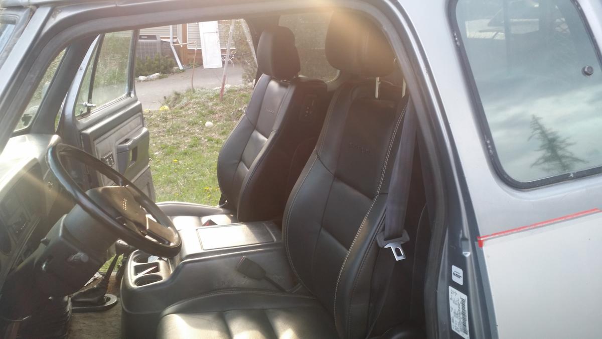

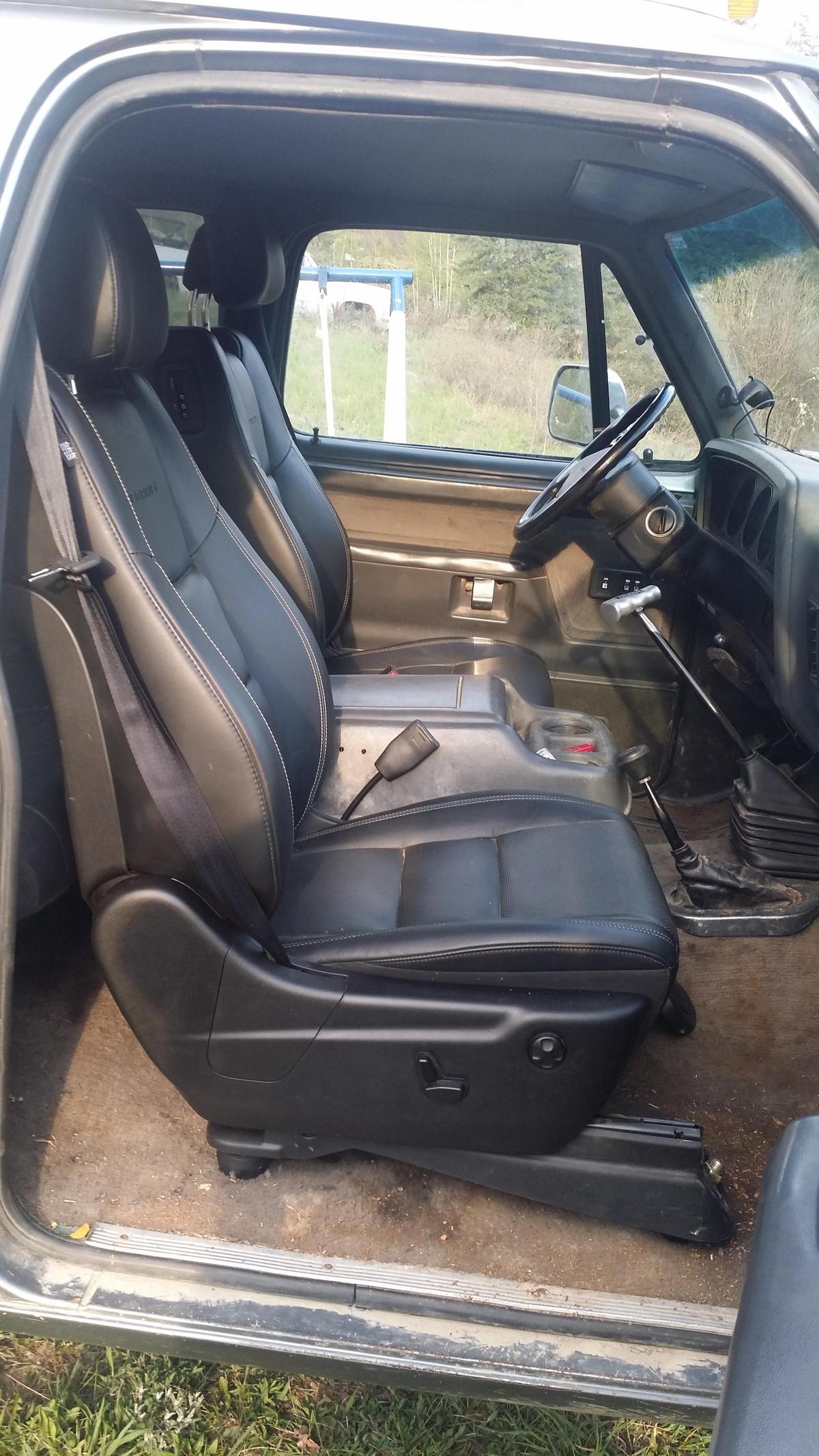

2014 durango seats, back support is real
Looks nice wish I had a club cab

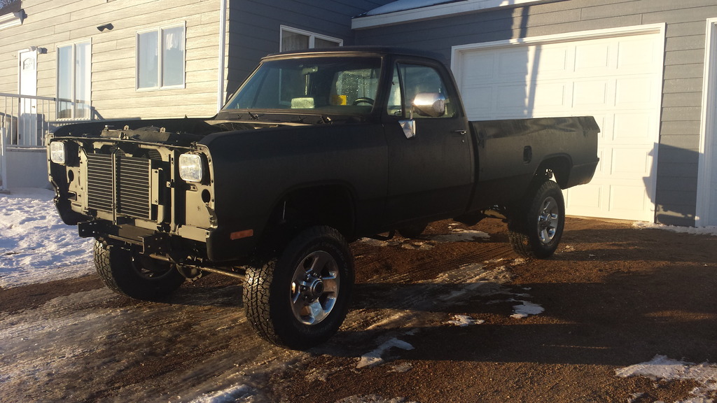

well, the life of having a straight truck lasted 4 months. not sure if I even posted the bed swap here, my build thread is on cf.com. but i had bought a d150 for the rust/dent free body and had spent countless hours shaving all of the trim tabs, filling holes, sanding to bare metal, and priming the bed to swap onto my truck. i then trailered the new bed 1800 miles to south dakota where my father and I swapped it for my old rusted bed. this was in december.
picture recap

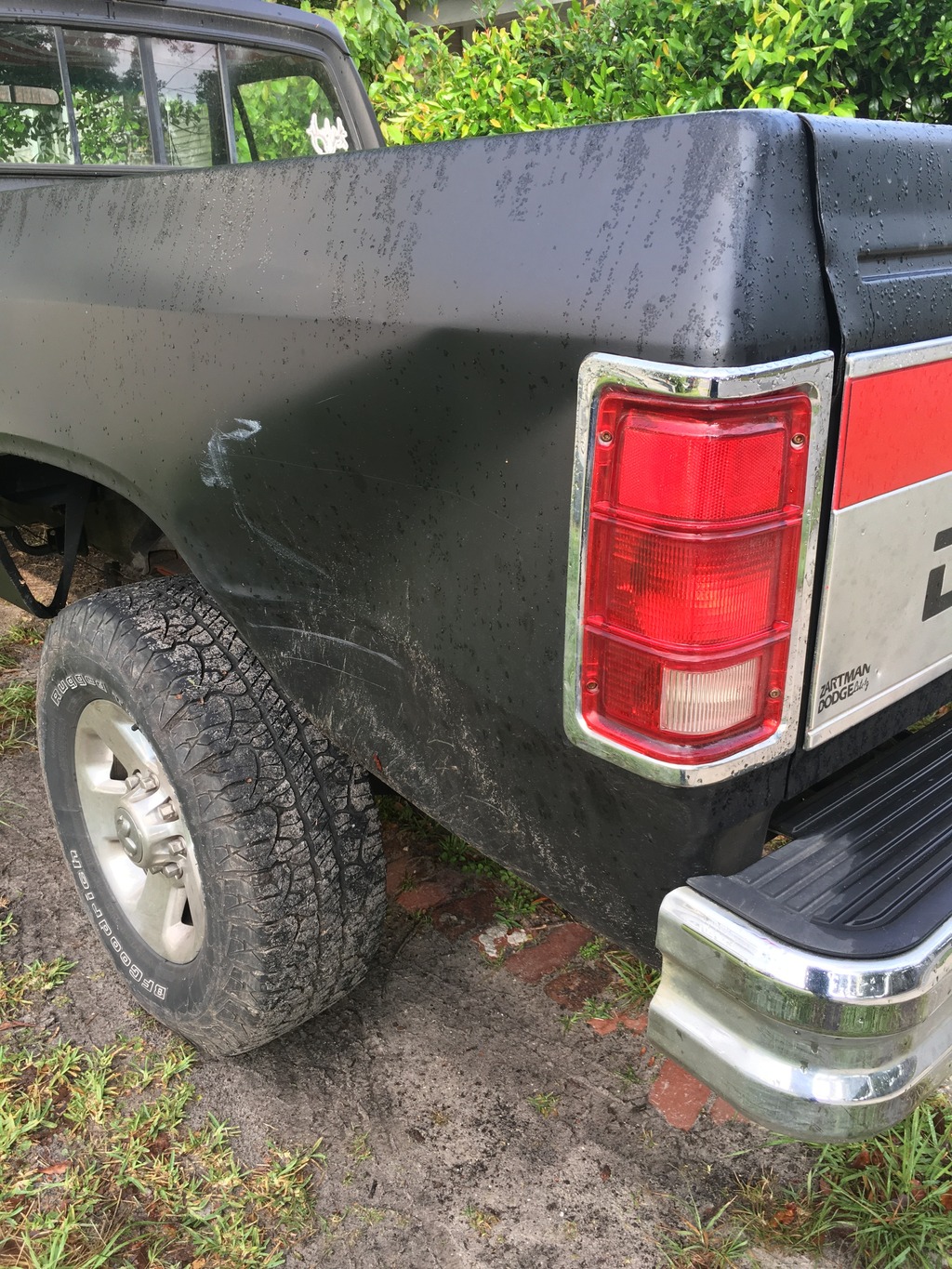

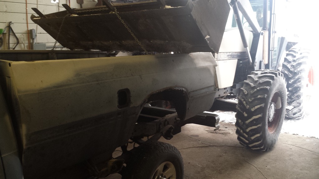

then, this happened. i hate myself and everyone around me. i'm inconsolable. i even said out loud once that i'm going to sell my truck(which was right after i said i was going to back it onto a rock pile and pull the keys). yes, i'm being dramatic, but we all know that these things are a labor of love.
picture recap
That sux

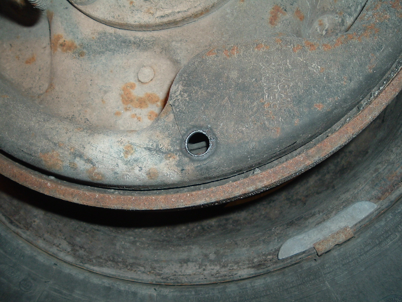

Drilled hole for brake shoe inspection
I did a search on this and didn't come up with anyone doing this. Drilled a hole in backing plate so I didn't have to pull the wheel bearings apart to inspect the brake shoes on my new to me 93 club cab W250.
Get a plastic plug then drill a 3/8 to 7/16 size hole, has to match your plug. Not as good as pulling the drum off, but gives you an idea. Mine looks like it is going to need work soon.
My father did that on his.
picture recap
Ugh...That's what terrifies me about actually fixing mine up and making it nice. I have this fear that I'll spend all this time, money, and effort on the truck and some little turd on cell phone is going to run through a light and T bone it.
Sux about the bed. Did someone hit it?
Sometimes I feel like the nicer I make something the more inclined Murphy is smite it.

Justin...that really sucks man....sorry to see that happen. You didn't mention what caused the new dent?

x2. this is the 2nd accident since i did all the cosmetic work in december.
well, atleast it was my fault. was towing my '03 ram 1500 reg cab short bed on my 2 wheel dolly. it was raining, going about 30 mph, car in front of me stopped a bit abruptly. i tapped the brakes, rears locked up, back end swung around, dolly jack knifed, bumper of truck on dolly hit me. not a scratch on the other truck and luckily didn't hit my bumper or taillight. it could've been worse for sure. luckily the car in front of me got a green light as i was spinning out of control and got out of the way in time. I did a full 180* spin in the middle of a 4 lane road, lmao. got out, assessed the damage, and drove home.
Originally Posted by NJTman
We need a "that sucks" button.
Sorry to hear about the bed. I hate it when I spend tons of time doing something, only to have it ruined for one reason or another
Hope it's not too much to fix
i think it's too much to pull out and make straight again. i have a couple options. i've found 2 parts trucks here in florida with good beds and another guy up in NC that has a good drivers bed side. would just have to drill/cut all of the spot welds and weld the new side on.
just need to decide if i want to go through fixing/sanding/priming an entire bed or just one side.
