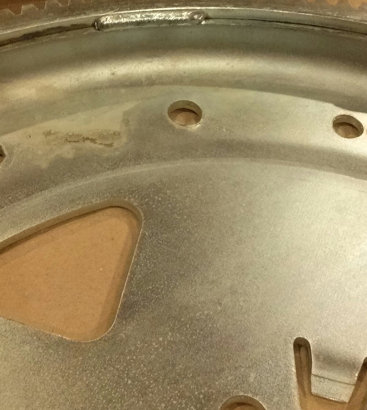

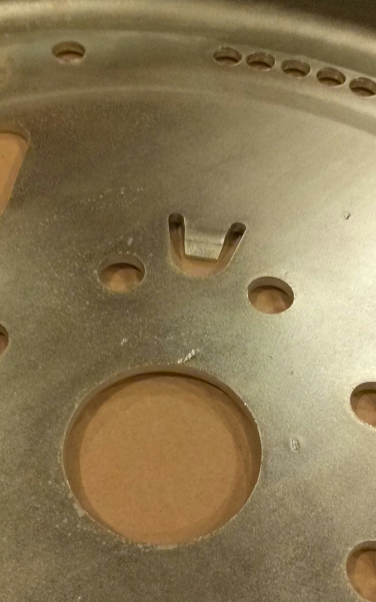

Got the new PRW flexplate today.
I'm kind of irritated by what I received. The plates holes where the torque converter is bolted is made IMO incorrectly. The bolt holes are press stamped through the steel in the outer section of the plate. Not only is ther excess steel left behind causing sharp protruding edges around the holes, but the holes are funnel shaped in the steel surrounding each hole.. Really messed up quality control issue, I do think
Oh, that's right. Box says made in China

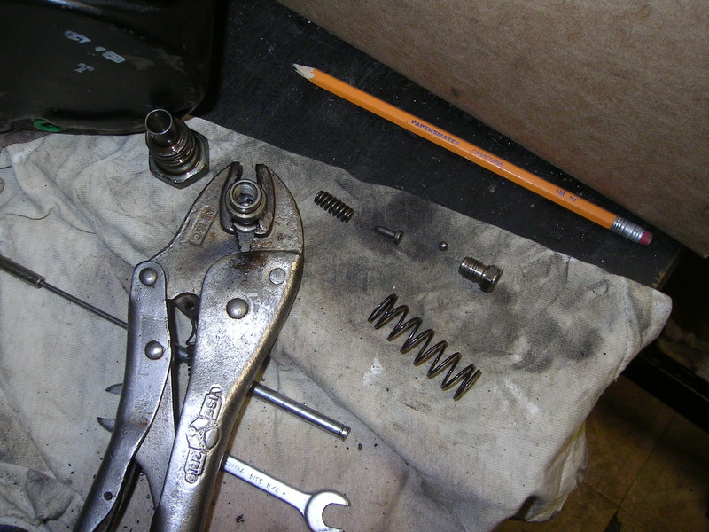

Did a few things on the crewcab today.
I swapped out the vacuum/PS pump assembly...again. I tossed in the old leaking set-up from my donor 93 when the 2nd Gen PS pump cooked after 4 days powering the hydroboost set-up. This PS pump did not work all that well when it was just power the steering box...turned out that the internal filter was virtually plugged solid!
I took the big nut off the back of the PS pump...where the high pressure line threads into...and pulled out the spring and check valve/screen assembly. Cleaned it really well and re-installed.
Here's what it looks like apart...
You need to clamp the outer housing in something...without damaging the outer bore since it is a piston. Then spin out the center filter....make sure you measure the overall size and re-install at the same measurement. I believe you can alter the hyd pressure by either turning it in/out? Also don't forget to red lock tight the screen in place.

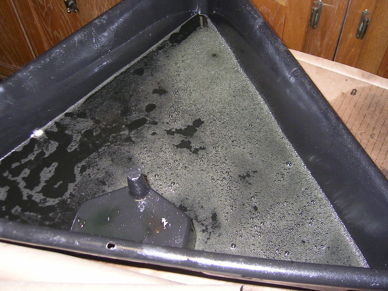

I also swapped out the dino gear oil in the rear diff for synthetic. The stuff I drained out was all frothy/foamy...never seen that before? This is the fluid the guy who did my diff work put in....so not sure why it was like this?

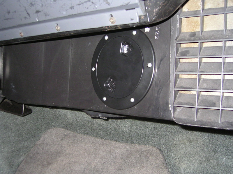

Installed the 4" Beckson (# DP40-B) Smooth Screw-Out Marine Deck Plate in my HVAC box today....as per the thread in the Sticky....

Well the oil I drained from my rear diff is still foamy today...even after sitting in the heated garage all night, and today. Here's what it looks like.....any idea why it would stay all foamy like that?
TC, I've always wanted to put one of those in, but could never locate a source that sells them locally. What company did you purchase that Beckson DP40-B?

Duh...
Amazon.com : DECK PLATE 4", Black, Screw In : Boat Vents And Deck Plates : Sports & Outdoors Amazon.com : DECK PLATE 4", Black, Screw In : Boat Vents And Deck Plates : Sports & Outdoors
Any boat store has them in stock.
get the one with the clear center plug, this way you can see the leaves and stuff without having to open it.

I saw in the sticky your pic on the clear one that you put on. Has it faded over time, or get that old plastic look? Want to go with the clear, but hate the look of faded plastic. As soon as I hear back from you I'll order one thru Amazon.... Don't be Baggin' on me T Man!! LOL

You might get one cheaper from one of the marine supply houses, like West Marine.
