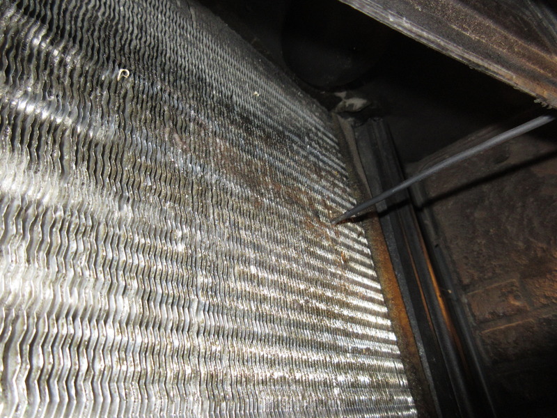

Last night I rewired a relay circuit that supplies power to my dash pod, Boost, Pyrometer and Voltmeter gauges and then after it finally cooled off, I washed my truck.
Then today,
I opened up my air box and cleaned out a handful of leaves, then I cleaned the evaporator coils.
I used an aerosol foaming coil cleaner that is commercially available,
Sprayed it on, waited a few minutes and then I flushed it out using hot water in a spray bottle after heading my truck downhill down the driveway so all of the dirty soapy water would drain from the air box.

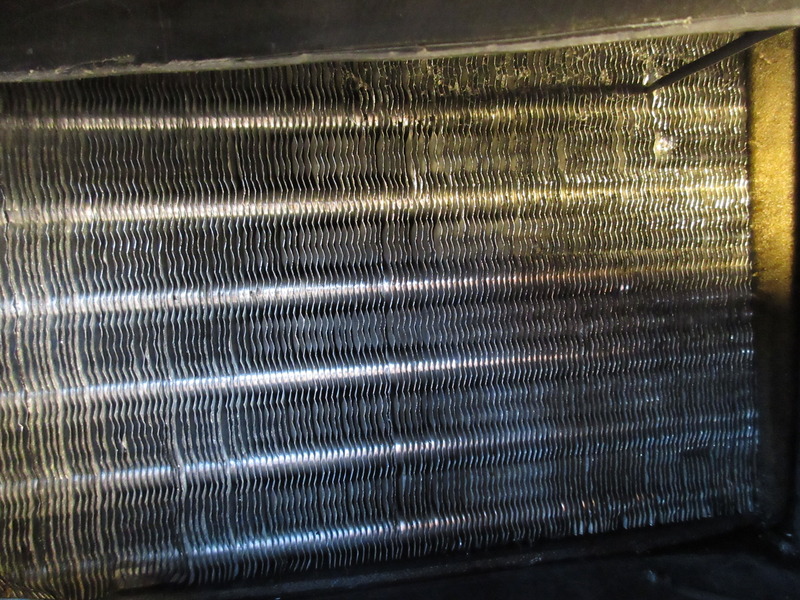

Now the cold air smells lemony fresh.
Reinstalled the cover until next time.

Other than a Slakey Bros, Johnstone supply, etc. where else are you sourcing this coil cleaner, that's lemony fresh in scent? I could use some nice scent in my rig, LOL. I have commercial grade coil cleaner that I've used on my own condensing unit at home, but no lemon scent there.
Back in 2012 our company Johnson Controls, put me on light duty work, doing inventory and putting labels on EVERY item in our shop. When it was all said and done, we probably had 80 half opened gallon containers of coil cleaning solution, as these dang lazy service techs would rather just buy a new bottle at the supply house than scourge thru the shop to find ones available. What a waste! Ended up going to the hazmat recycle. Another item that was abundant, in half used containers was refrigerant oils. No wonder our JCI branch was in the red! Shop ended up closing down.
