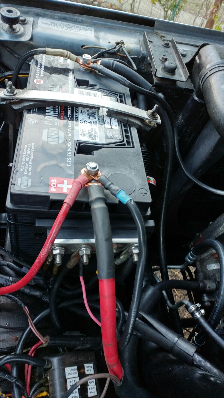

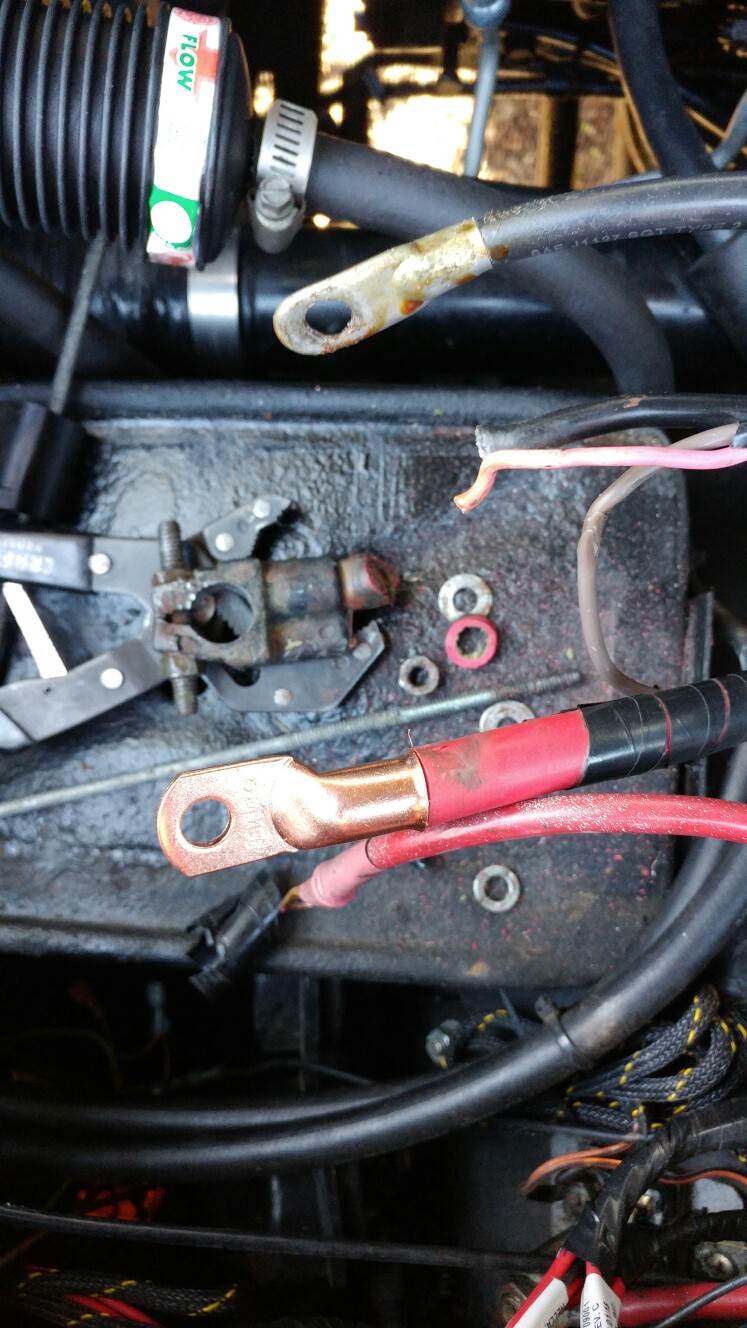

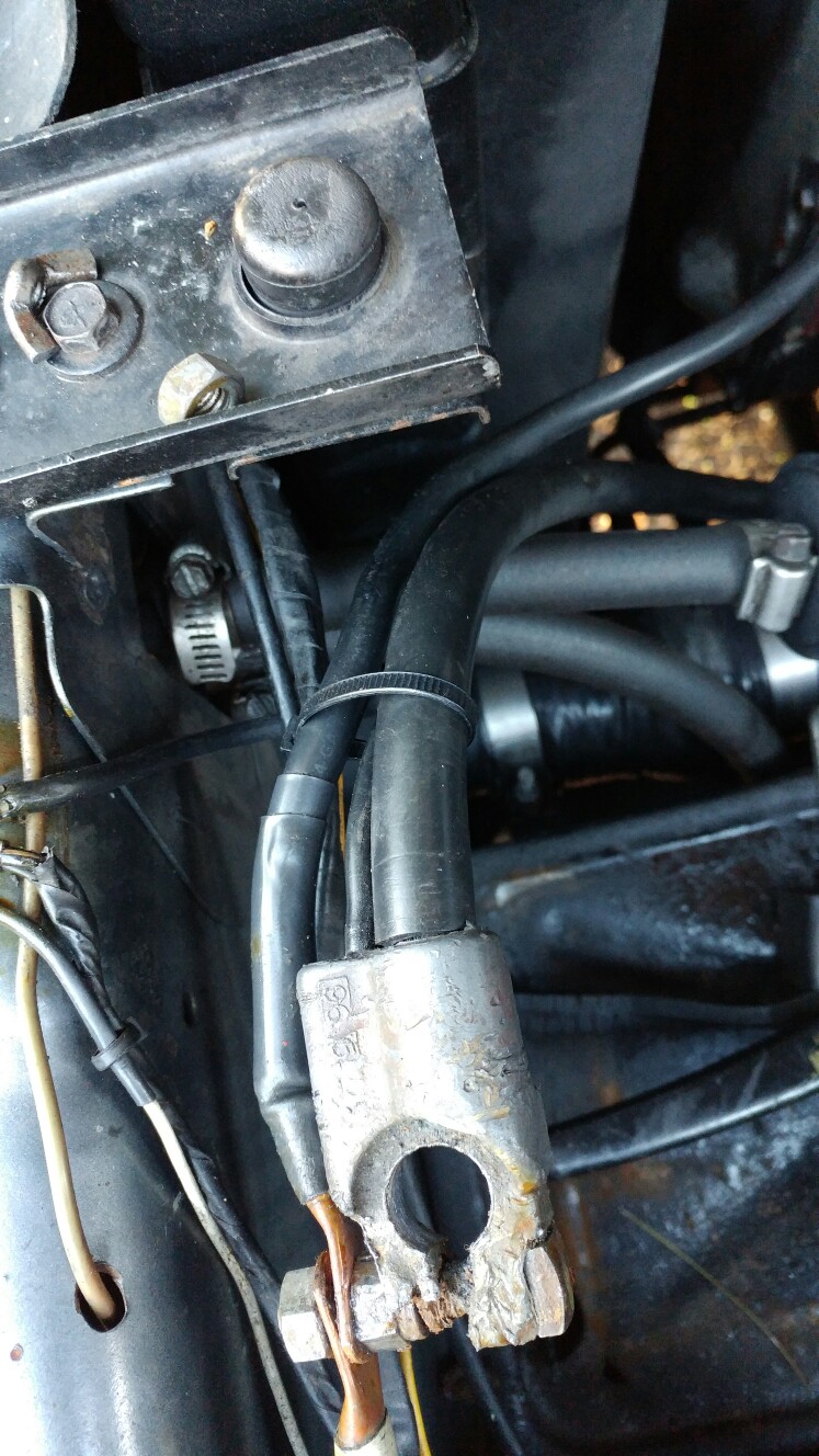

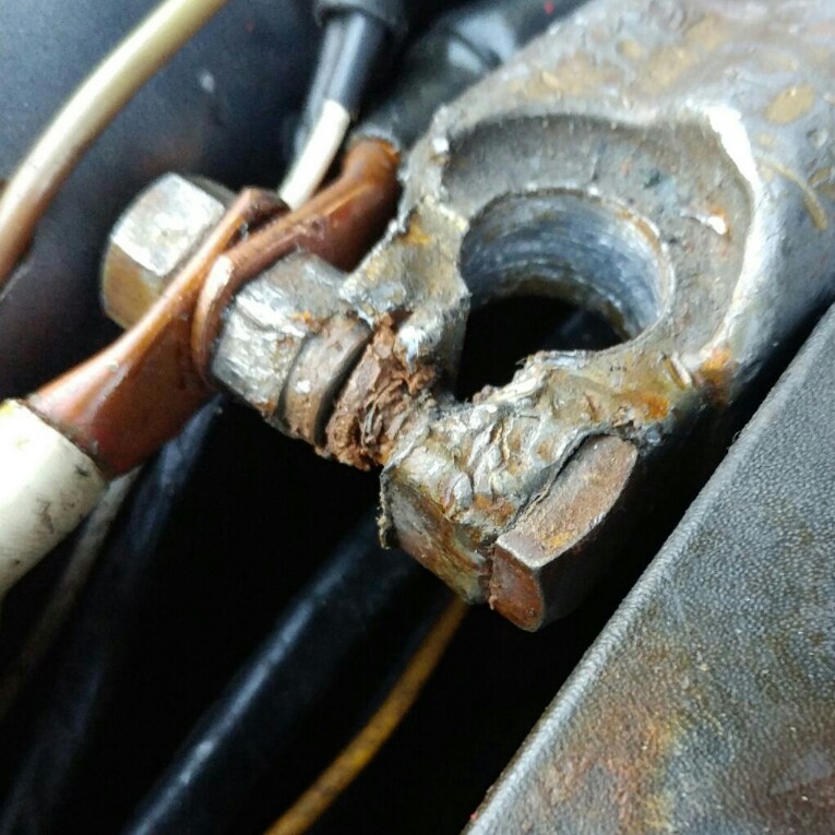

Replaced battery cable ends and installed a threaded post battery and buss bar. Once I fabricate a bracket, ill move the buss bar over off the battery. Cable ends needed were 3-0 and 4 gauge, which my local Napa stocks

Nice looking upgrade T-man.

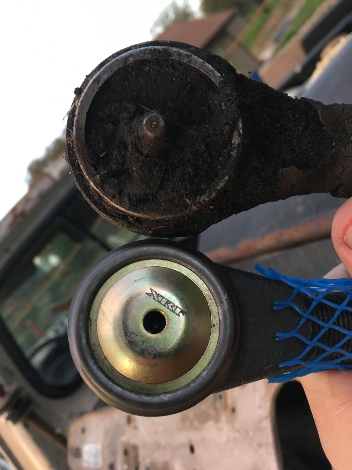

I rebuilt the upper and lower control arms for a 4K lb D250 front end. (McKnittle's old 2wd arms)
New Moog Bushings all around, and XRF lower balljoints, which look great. Haven't installed the upper BJs yet, going to bolt the arms into the frame first and then reef em to 125 FT/Lb
Also arrived was a whole complement of XRF steering components. (Centre link, Idler, Inner and outer Tie Rods and New adjusting sleeves.)
So far I'm not too impressed with the XRF steering components because 1.) Everything is made in Taiwan. (All my moog bushings and even the new 7226S springs were made in USA) and 2.) The Tie Rod Ends are puny, much smaller than stock. (yes, I double checked correct P/N and taper is correct size.) I assumed they'd be as large or larger, but they boast on their website:
"Both XRF tie rod ends and rack and pinion ends are made to be much stronger than OEM.
XRF uses SAE1045 and SAE4140 steel on these parts to give greater strength and durability. OEM stud pull-out specification is >2550kg, while XRF stud pull-out tests at >4520kg."
So, maybe they use superior metallurgy, and can run smaller and still be stronger than OEM?? We'll see. They were half the price each of equivalent MOOG big size joints. The Center Link looks ok I guess, I haven't compared the joint size with OEM though. Pics below. Maybe the best idea would be to stay away from MOOG ball joints, but get mOog tie rod ends+ everything else??

the "New" moog tie rod end is a bit larger in diameter (and made in USA) than the XRF but not as large as the OEM/old style moog.
It is shallower than the XRF and the ball has a loose spot in the socket around the center vs. the XRF which feels nice and tight.

I have seen something like that somewhere.

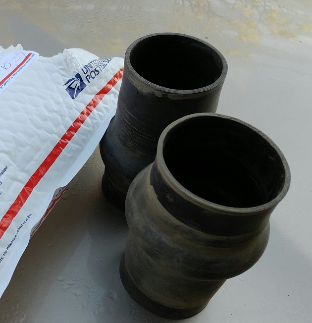

Christmas in November ?
Thanks Ollie !

Nice to have a couple spares. After my new parts truck I now have several spares.....
