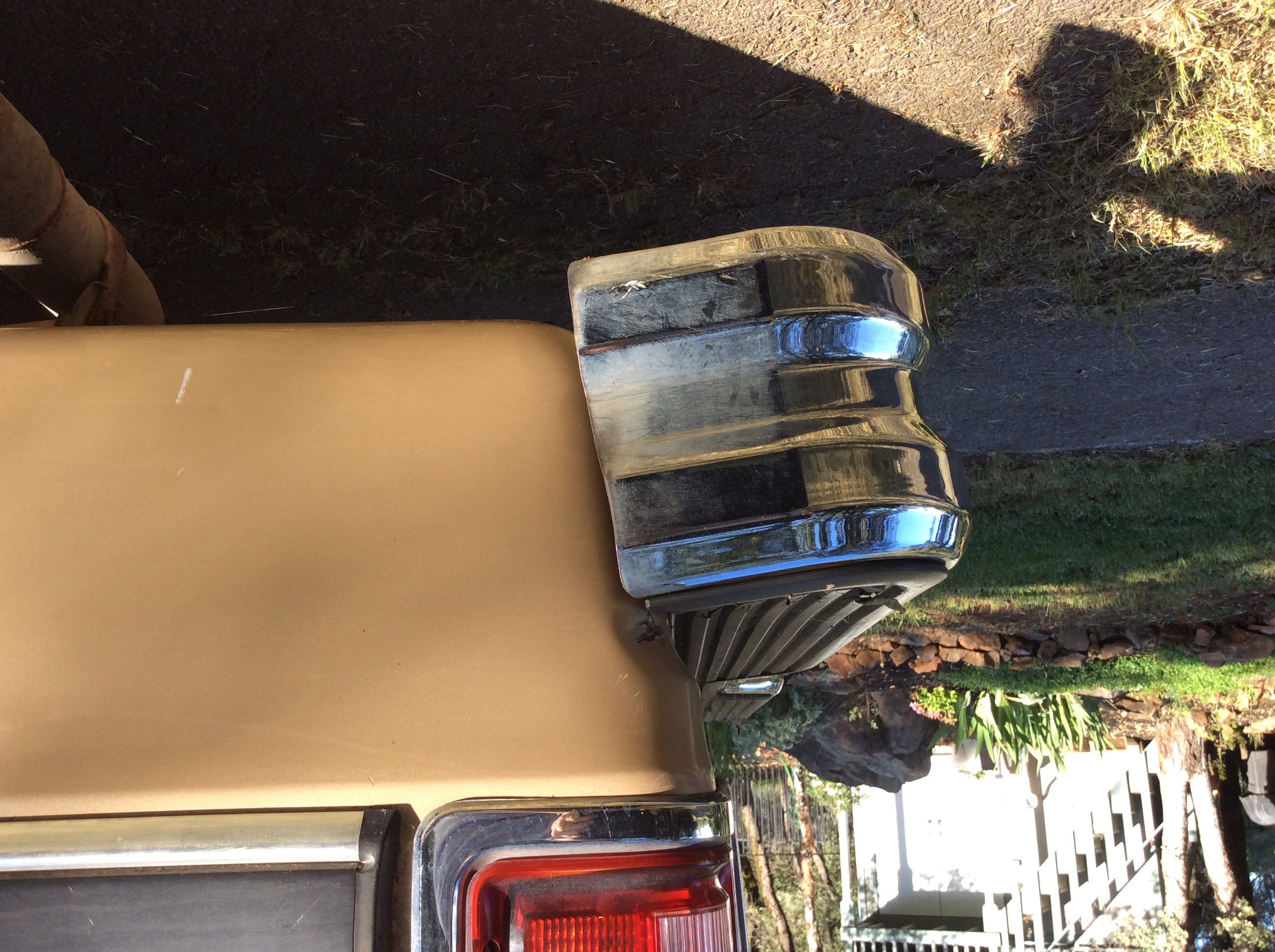

If it makes you feel better, emotionally, not phisically( blisters I don't have) that "mint" 1991.5 I just picked up? With the 26 year old, untouched bumpers? Last week, after I finished up with all the differential and transfer case fluid changes, I was backing it up to park it in its designated spot. Well, I heard a noise that caught my attention just for a moment as I was backing up, than KABOOM! The infamous bumper destroying rock on my front circle driveway decided to make out with the rear bumper! I got out, of course not a "dent" on the rock, but it sure tweaked the bumper. Now I'm going to have to mess with the come-a-long and try to pull it out. It won't fix the half dollar cave in on the body, though, just under the tail light.
The result!
Like I said, could somehow easily straighten out the bumper, but not that ding to the body.
