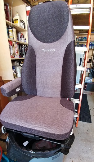

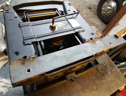

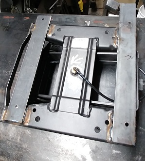

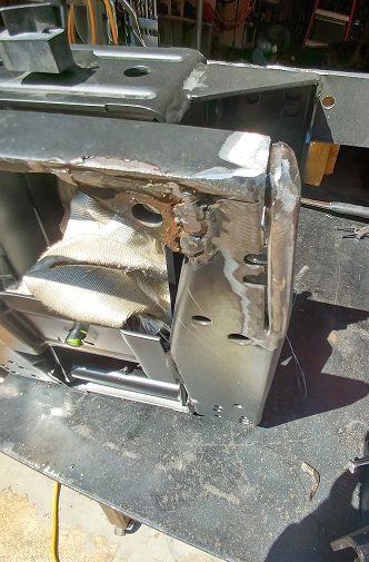

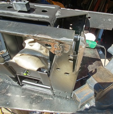

I had previously mentioned I might put air ride seat in my dodge if the one I'm installing in my Fuso worked out well.
Yesterday, I finished up the fabrication and installation. Since there is no company that makes a direct fit, I had to utilize a Ferd suspension kit, with an aftermarket seat. So far, I haven't driven it much, but the limited around the block ride showed me that I will get some lower back relief from being smashed by a "cab over" ride that I've had to deal with for so long. Better than getting rid of the truck.
So this is the air bag system I may be installing in the dodge. I'll probably use the dodge seat, but just put the suspension seat under it. I would have to install a up down valve on it, but that shouldn't be a big ordeal.
Had to "center" the seat by relocating it's mounting position, and also in order to utilize one of the original seat mount screws, I added a new mount to the suspension kit, as well as "massaging" the corner that wouldn't fit up against the floor tunnel..
Fun project. My L5-S1 will appreciate it.

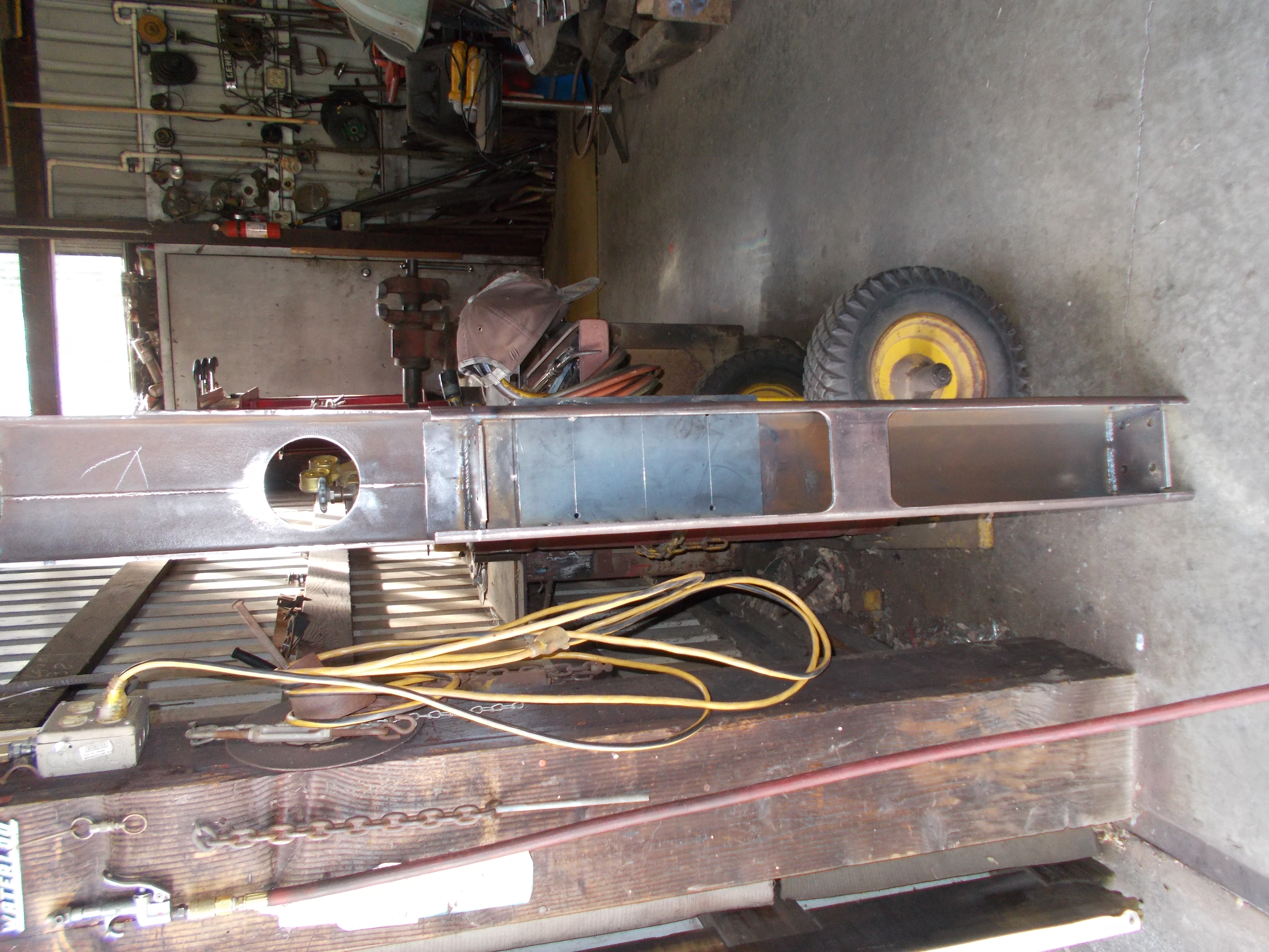

Today I worked on my trash to (cough) treasure rear bumper. The challenge is to use the old stock I had to attempt to make something worthwhile out of it. would have rather had it taller but it is what it is.
Here is the center section with one end sitting on top of it.
Attached Thumbnails What did you do to your Gen 1 today?-dscn0489.jpg   What did you do to your Gen 1 today?-dscn0490.jpg   What did you do to your Gen 1 today?-dscn0491.jpg

As always, it's looking good and I know will turn out spectacular.
Didn't know you had a full blown shop there, Mark. So organized.

We needed it when we had he logging truck working.
