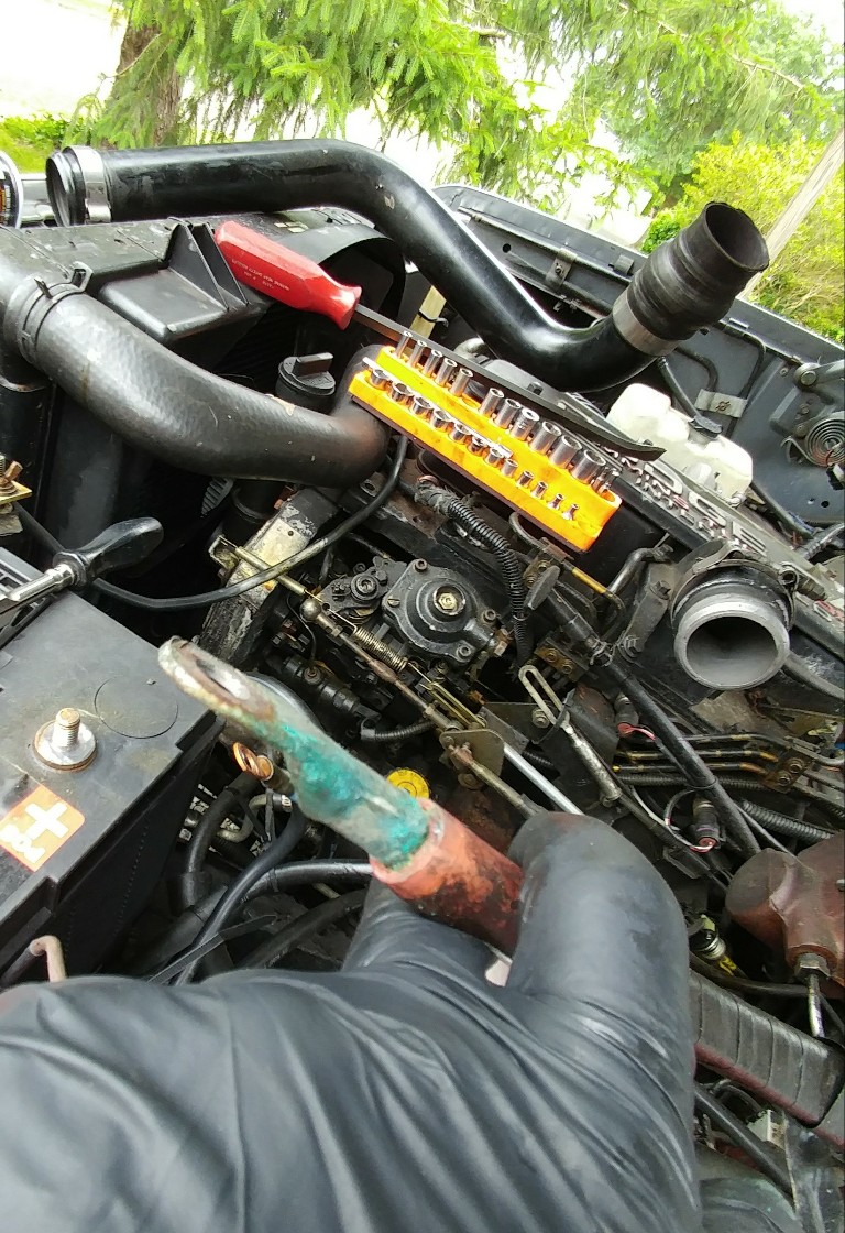

So, today, I'm up and out the door at 6 am, get to the truck and go to start it, and all I hear is ....
"Thunk"....
Turned the key off, and tried it again. This time, smoke came out of the hood for a brief second, and I turned the key off again. Popped the hood, found nothing burned, other than that darn fuse that kept popping intermittently. Put another fuse in, turned the key and NOTHING.
No engine movement at all. Must be the starter....
Go to do a couple estimates, and when I get back I dig into it. I disconnnect the battery cable, remove the cables from the starter, clean up all the green mess, and put it back together without the 12 ga lead wire from the main harness. Jumper across the terminal from the hot cable to the solenoid, and she fires right over.
Okay.... bad ignition switch or lock cylinder. Lock cylinder has felt kinda funny lately, so I assume the chinese replacement I put in a few years back crapped out. Ordered a new ignition switch and lock cyl from Dodge, and I guess I can swap them out next week.
Oh well. Another day in paradise...
