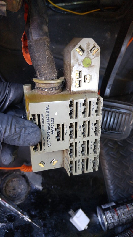

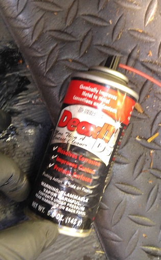

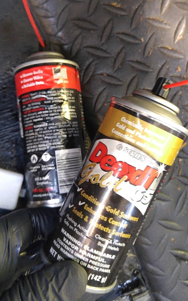

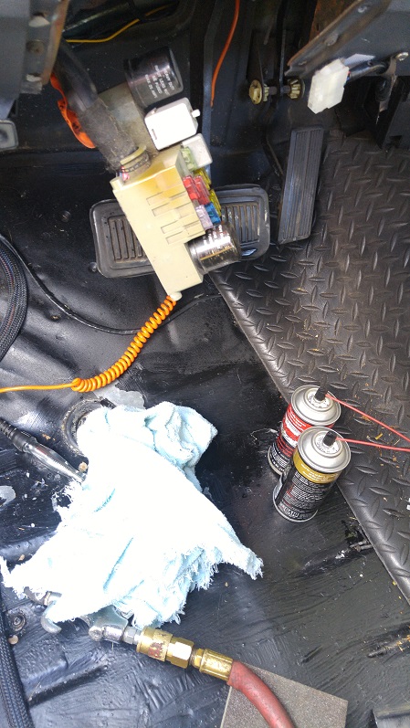

Every 2 years I do a complete electrical system maintenance program. I call it complete, but it's mainly the fuse panels and battery connections that get done. Since I live in the "Rust" state, moisture, and salt air is the enema.
So, I remove all the fuses, clean each fuse location with deoxit, clean each fuse tang, spray some deoxit GOLD in there, and put it all back together. Hard to imagine, but it does need this every few years.
Same goes with the fuse panel and connections under the hood off the battery. What a PITA.
Oh well, mostly done for now. Peace of mind in return.

Man that is a lot of work! Reckon how many hours you spend doing that? It's a shame that is required up there.

spent 4.5 hours so far. Figure another hour or so to finish.

One of the tribulations you must endure if you want to keep your old iron in good condition while driving it year round.
I need to do a bunch of maintenance on patches next summer....mostly exterior paint and surface rust starting. Now that I live up north with long winter months of driving I have to keep up even more with the OCD maintenance of the vehicle....like T-man.
