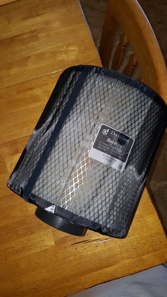

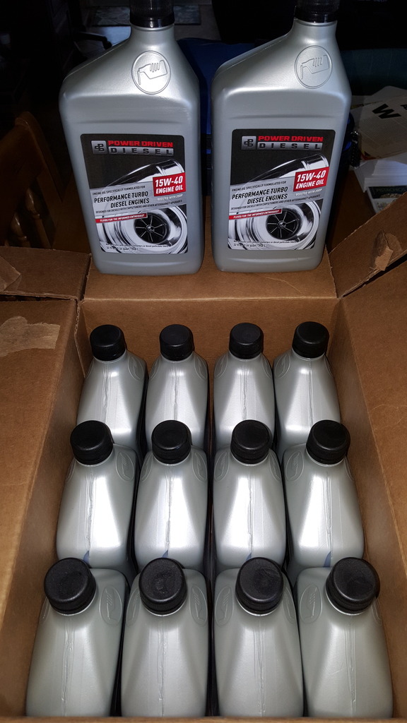

Essentials showed up on Tuesday.
Today, a replacement Donaldson air filter (aka BHAF) arrived along with an Outerwears pre-filter.

can we talk about that oil? (this is where you tell me everything you know about it and convince me I need it) haha

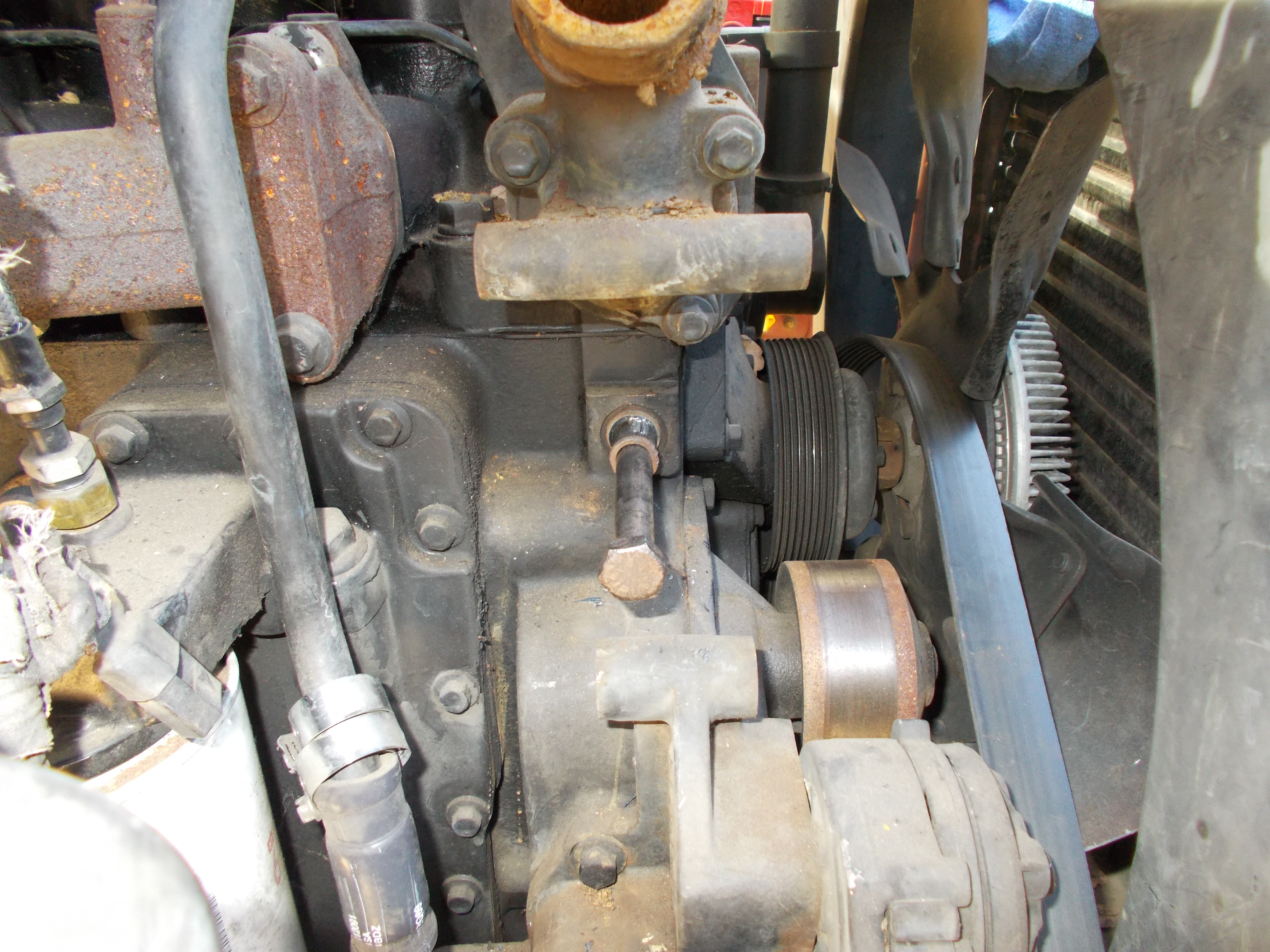

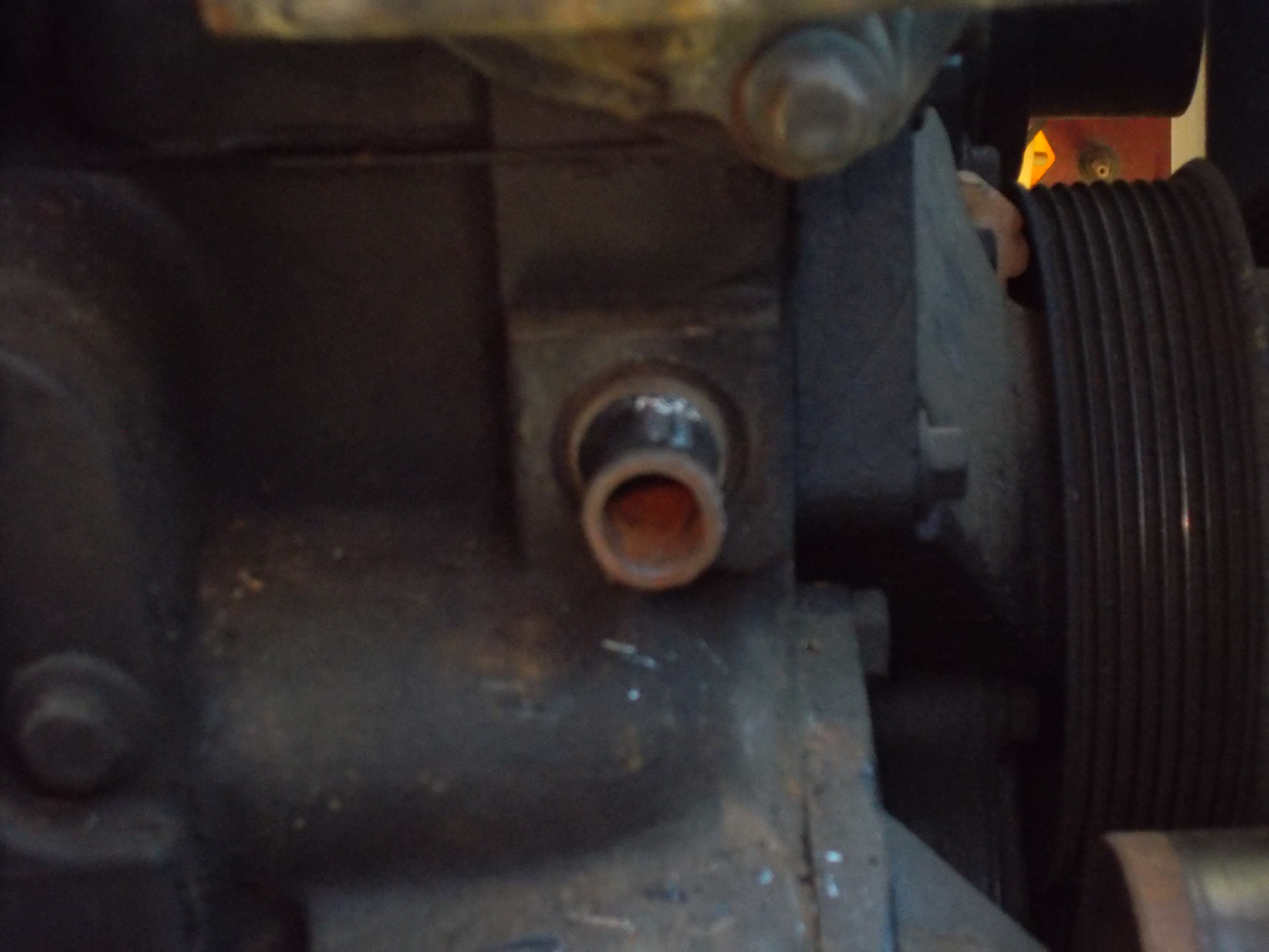

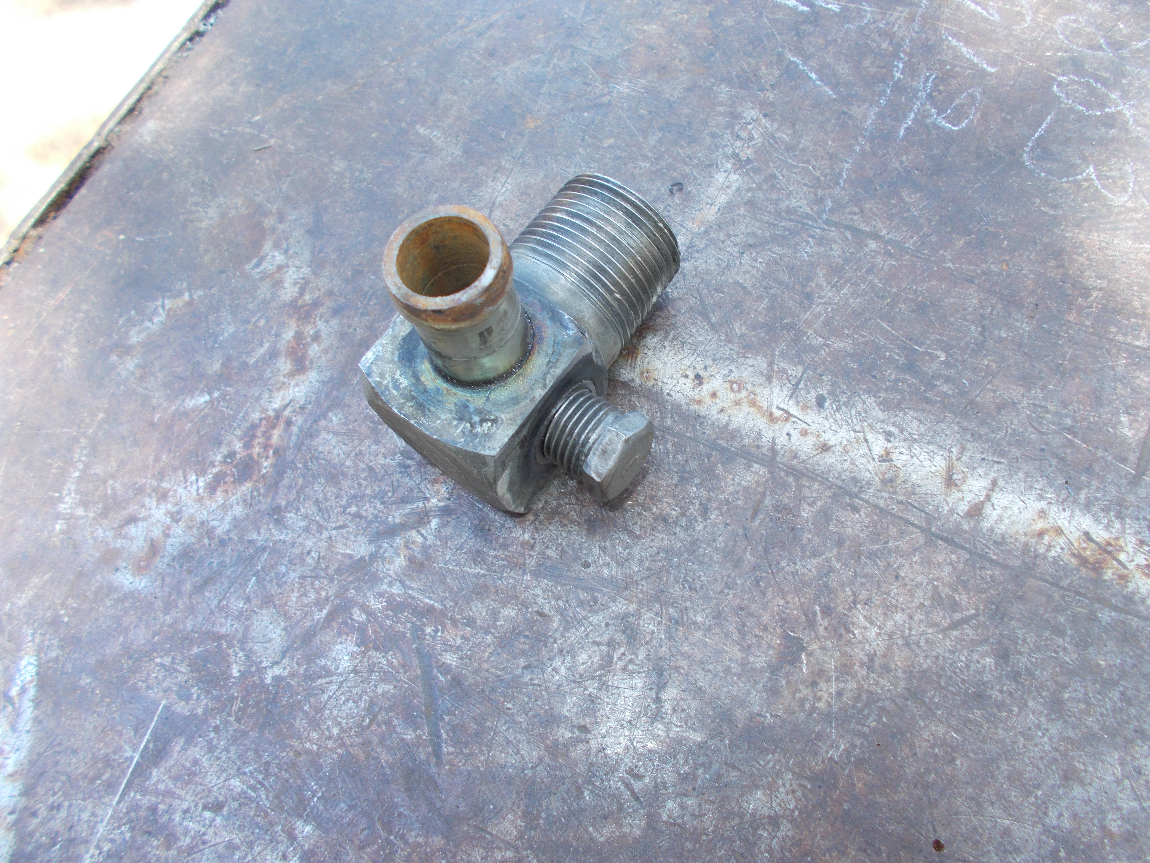

Yesterday I opened a can of worms. I pulled the heater hose fitting at the lower radiator hose.the plan is to eliminate the extra 5/8 hose nipples that ran to the trans cooler the bottom one went OK but I can't get the top one to budge. who ever invented a nipple with no hex should be shot then hung! I am about convened myself to cut the thing off and tap it 1/4NPT like the lower fitting experiment before I muff the thing up and can't tap it or get it out.
I used the 1/2" bolt to try to keep distortion to a minimum.

I was able to get a small pipe wrench on it and with some heat, it came loose. A buddy of mine welded a bolt in it, like you have inserted, and turned it out with a wrench. Just some more idears.
