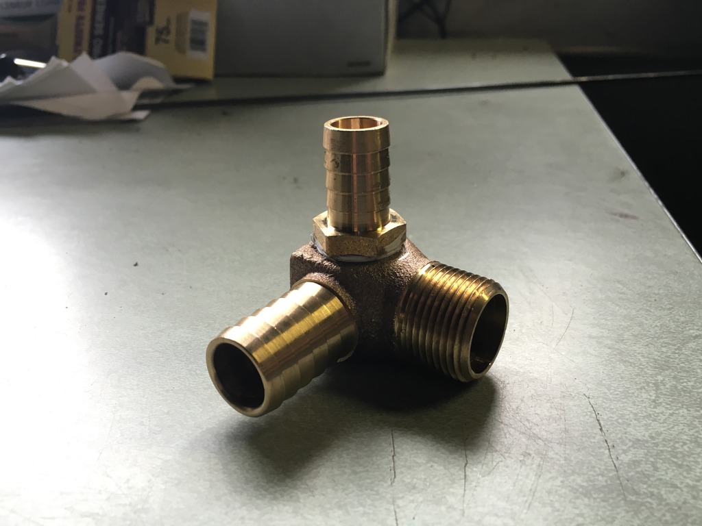

I also found new brass fittings for the lower fitting. I added a second nipple for the coolant fill tank in my project.

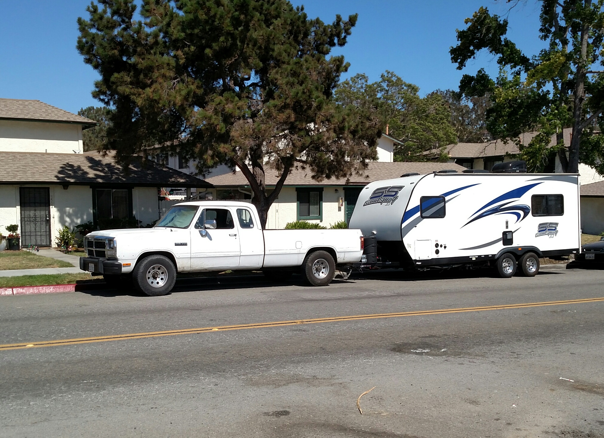

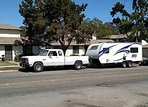

Hooked up our inhereted toy hauler to it and drove to DMV to get it registered in California.

Nice rig!!!!

Very much so

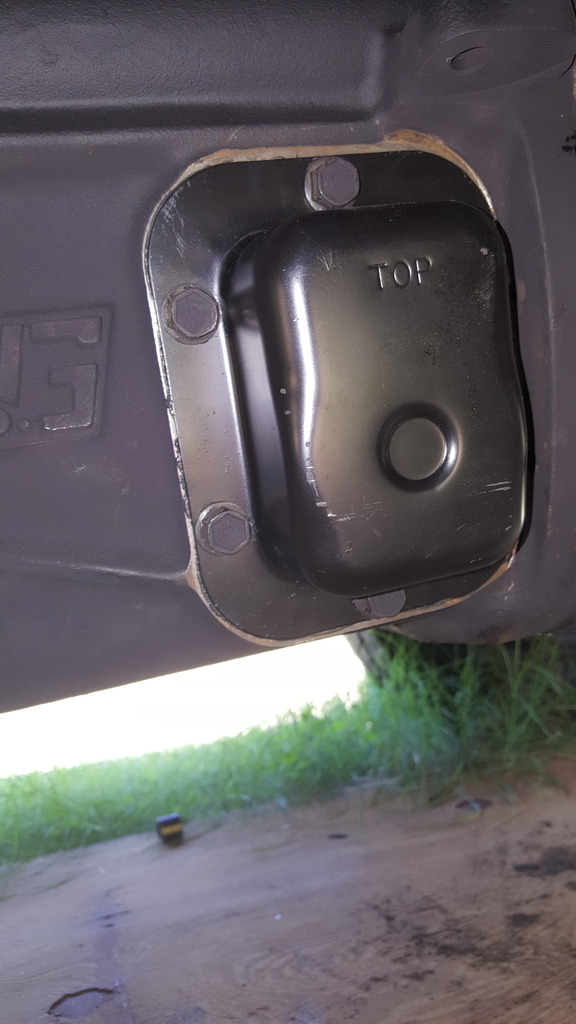

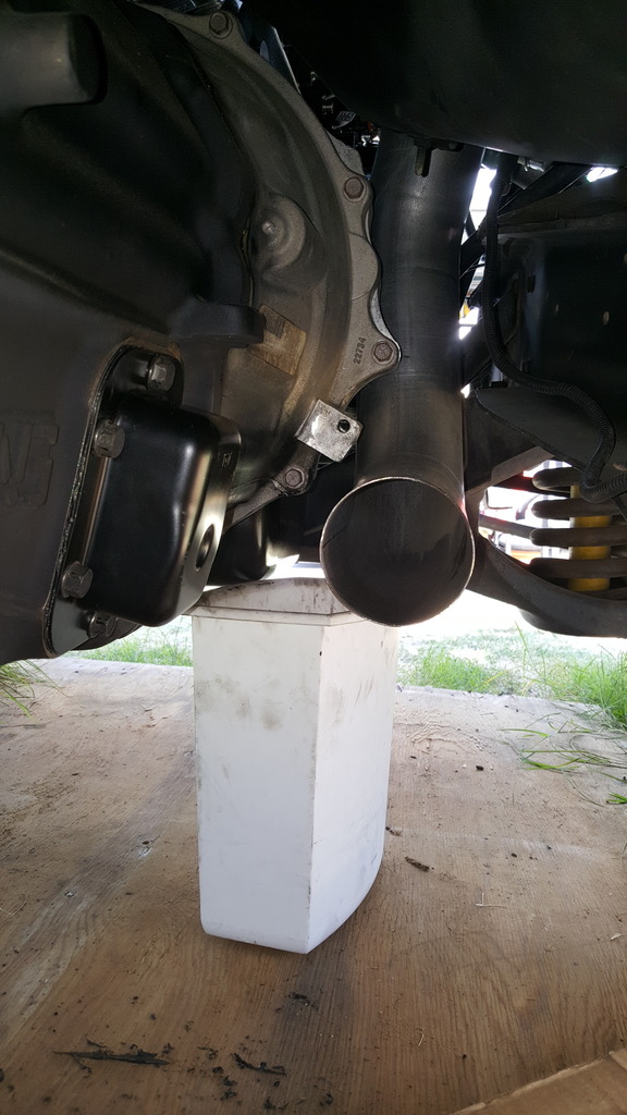

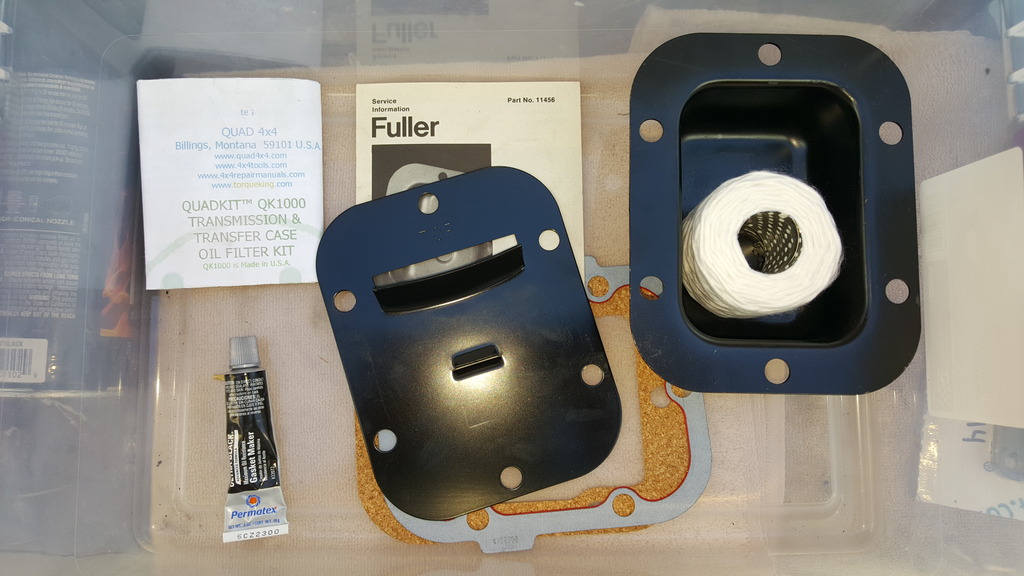

Installed a transmission fluid filter for the NV5600 from Quad 4x4. Looks to have plenty of clearance from the exhaust.

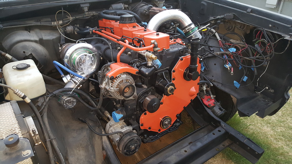

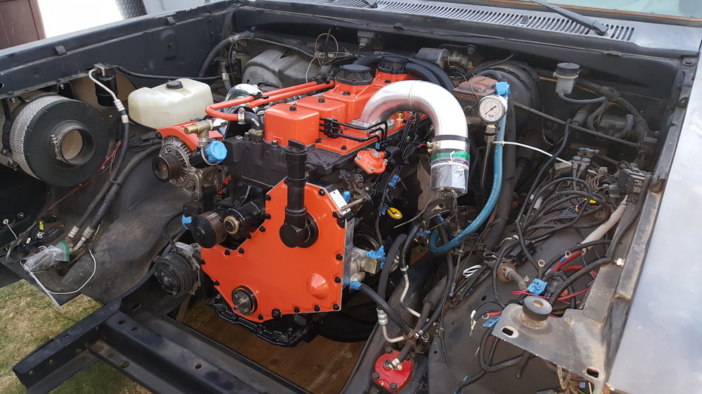

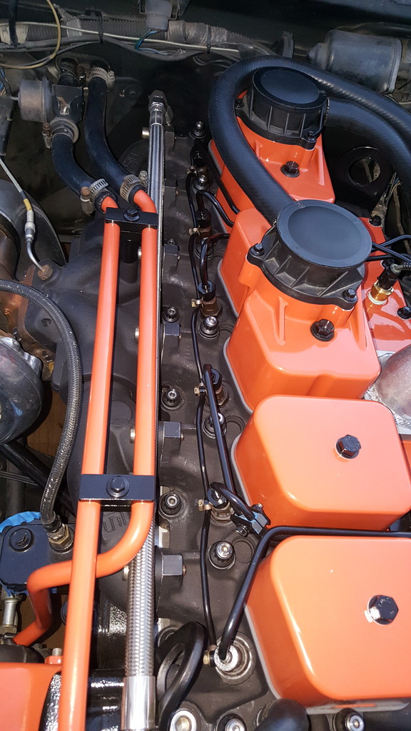

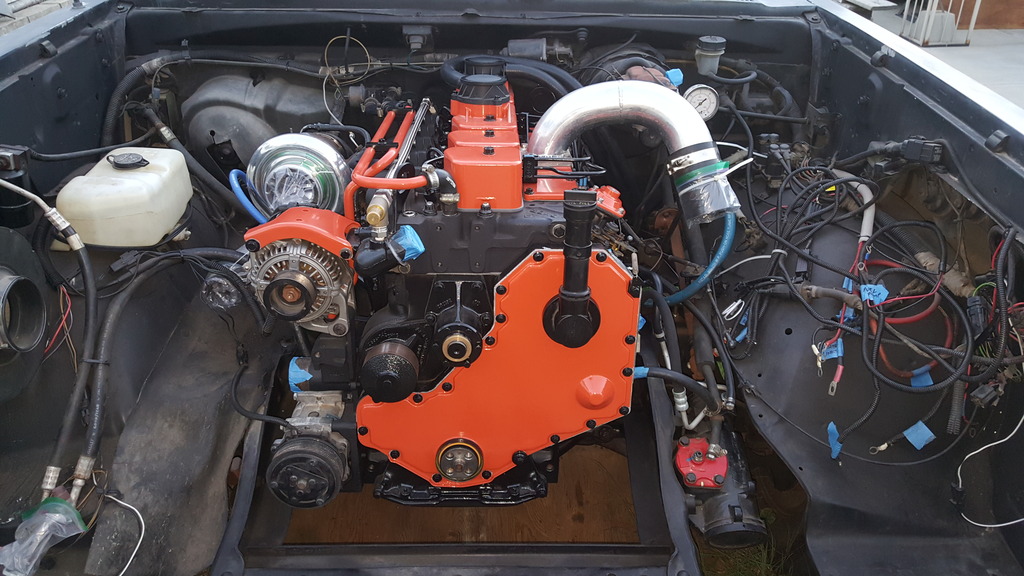

The injectors came back out to have thinner sealing washers installed, ~.022". Injector and injection pump return lines installed. Then drizzled some oil on the front gear train before closing it up with the timing cover.

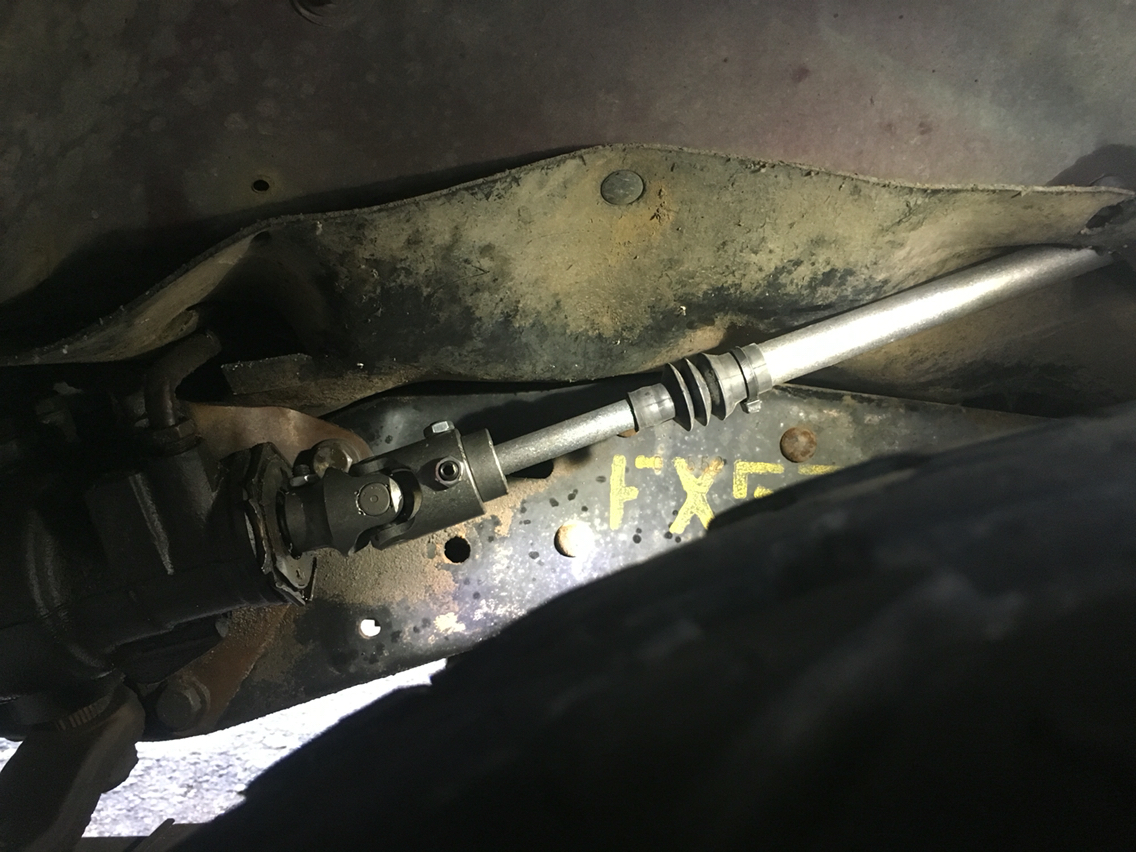

Replaced my '89 steering shaft with a Borgenson

Jimbo....I installed one of those quad 4x4 PTO cover filters on my NV4500 about 6 years ago. Changed the filter when I converted from 2wd to 4wd. I have not had any issue with it, and it does seem to grab crud out of the oil, so that can't be a bad thing.
