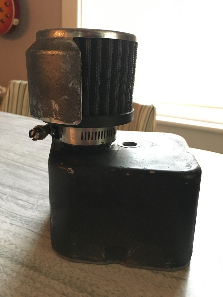

If you can weld aluminum, something like this is a fraction of the cost of the dual breather valve cover setups that a lot of folks run. Don't tell ofelas though. If he can't buy it and pay someone else to install it, he won't use it.

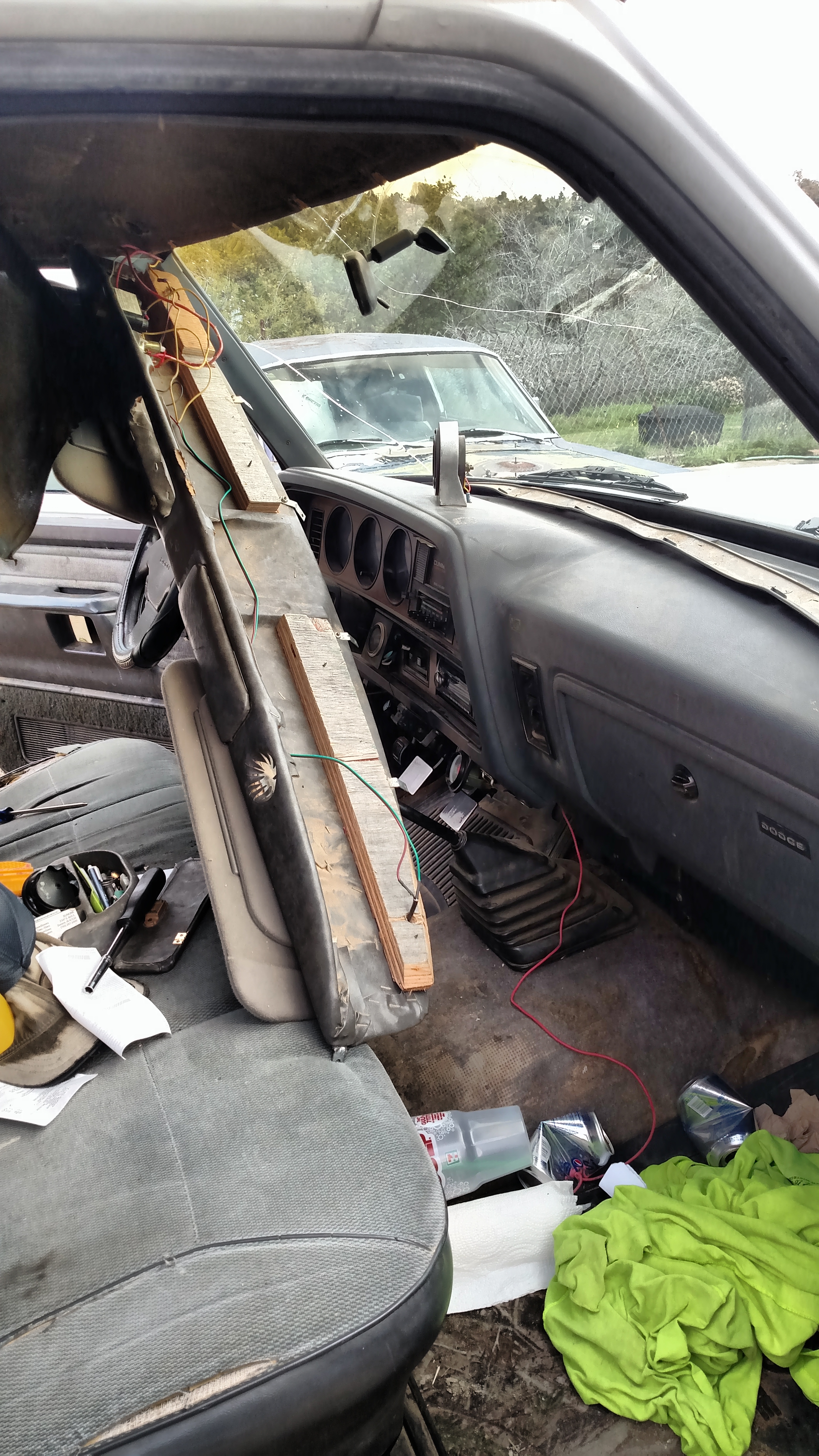

Today I finished installing the 2006 Chevrolet Suburban/Tahoe visors in the truck. My truck has a drop down overhead console so it wasn't too hard to get the mounts to work properly. While not perfect, I wish they could of been closer to the cab corners they are a nice upgrade from not having anything!
On the bench, mounting holes cut. I used 1 1/8 CDX scrap to give the screws lots of material to bite into.
Wiring finished and back to the truck.
Console back in with visors up.
Visors down with mirrors open, the lights aren't on as I zapped the wiring hooking them up to the volt meter which is always Hot. Off to get another fuse or voltmeter...
And then visors to the side with extension out and secondary front visor down.
