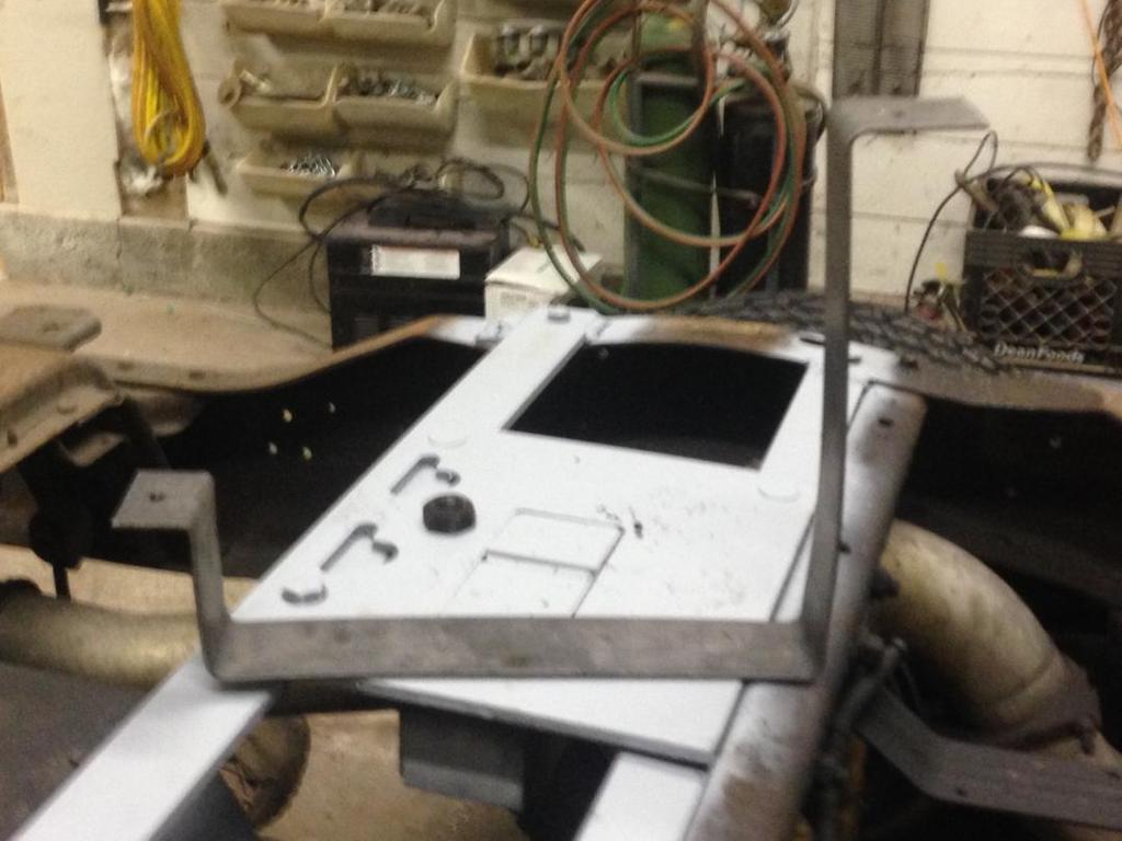

I just bent my own out of 1/8" x 2.5" plate. My frame had rusted around where the one end sits inside the frame rail.

That'll work. And when making something like that with bigger radius' you can chuck a piece of pipe in a vice to bend the strap around.

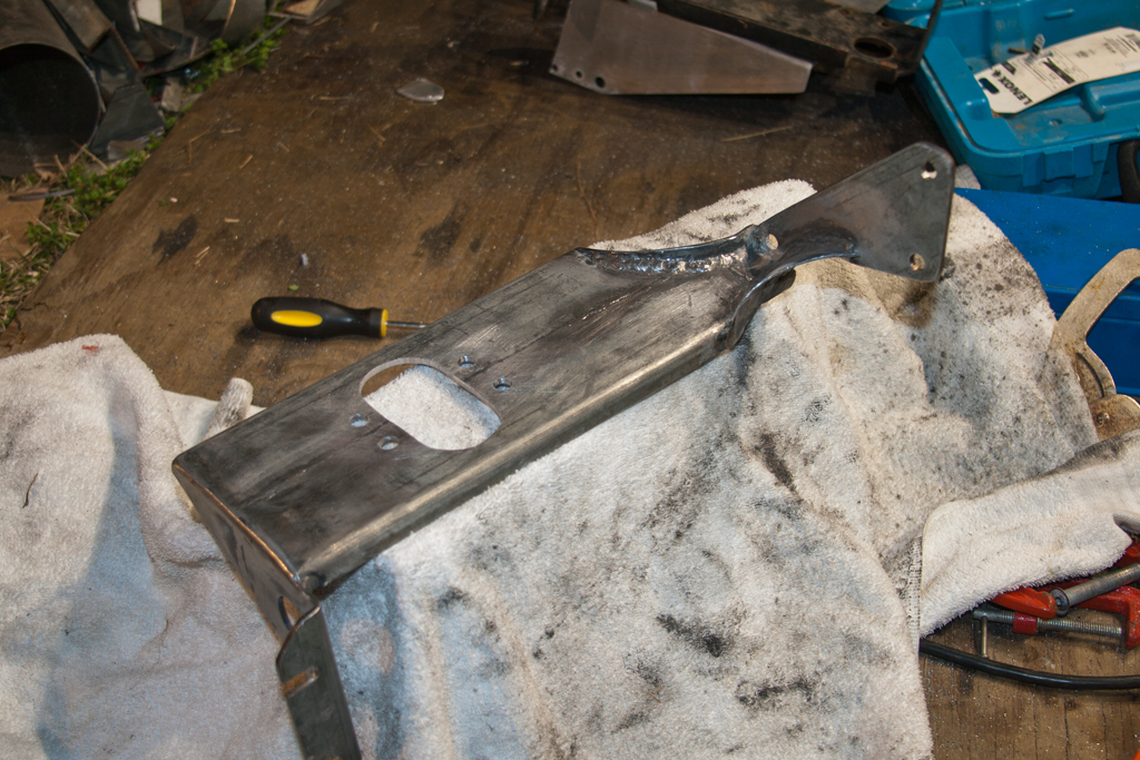

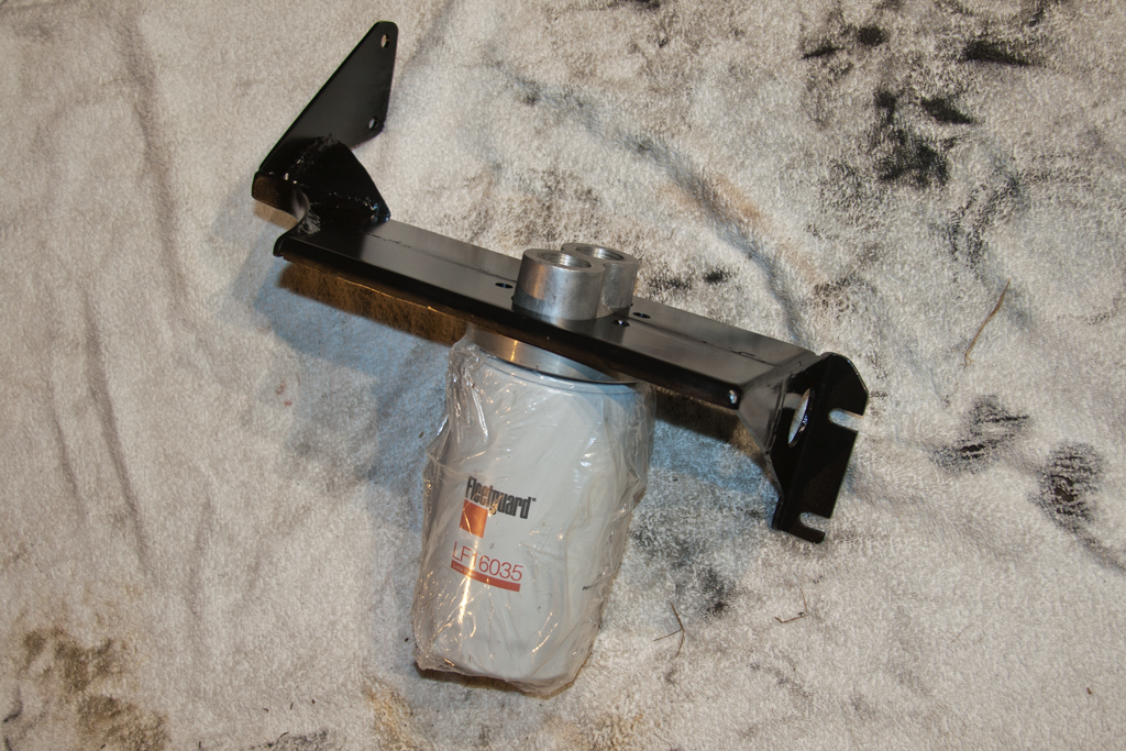

This past Sunday found me making a bracket for the remote engine lube-oil filter. It's made to use the same mounting spots of the former transmission fluid heat exchanger.

Great idea on the placement.

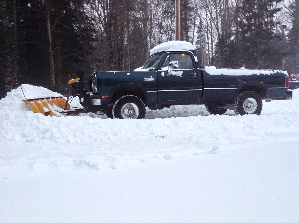

Oliver asked me to post this photo. He will fill you in.

Thanks T-man!
I just thought you DTR'ers would like to see a picture of the old 1st gen plowing some snow.
I have gotten 24 inches of snow in the past 30 HRs. It is time to fire it up again and do some more plowing tonight.

Oliver - cool picture. I like the chains (cables?). What size tires and did you have ballast in the bed? Any trouble pushing 24"?
