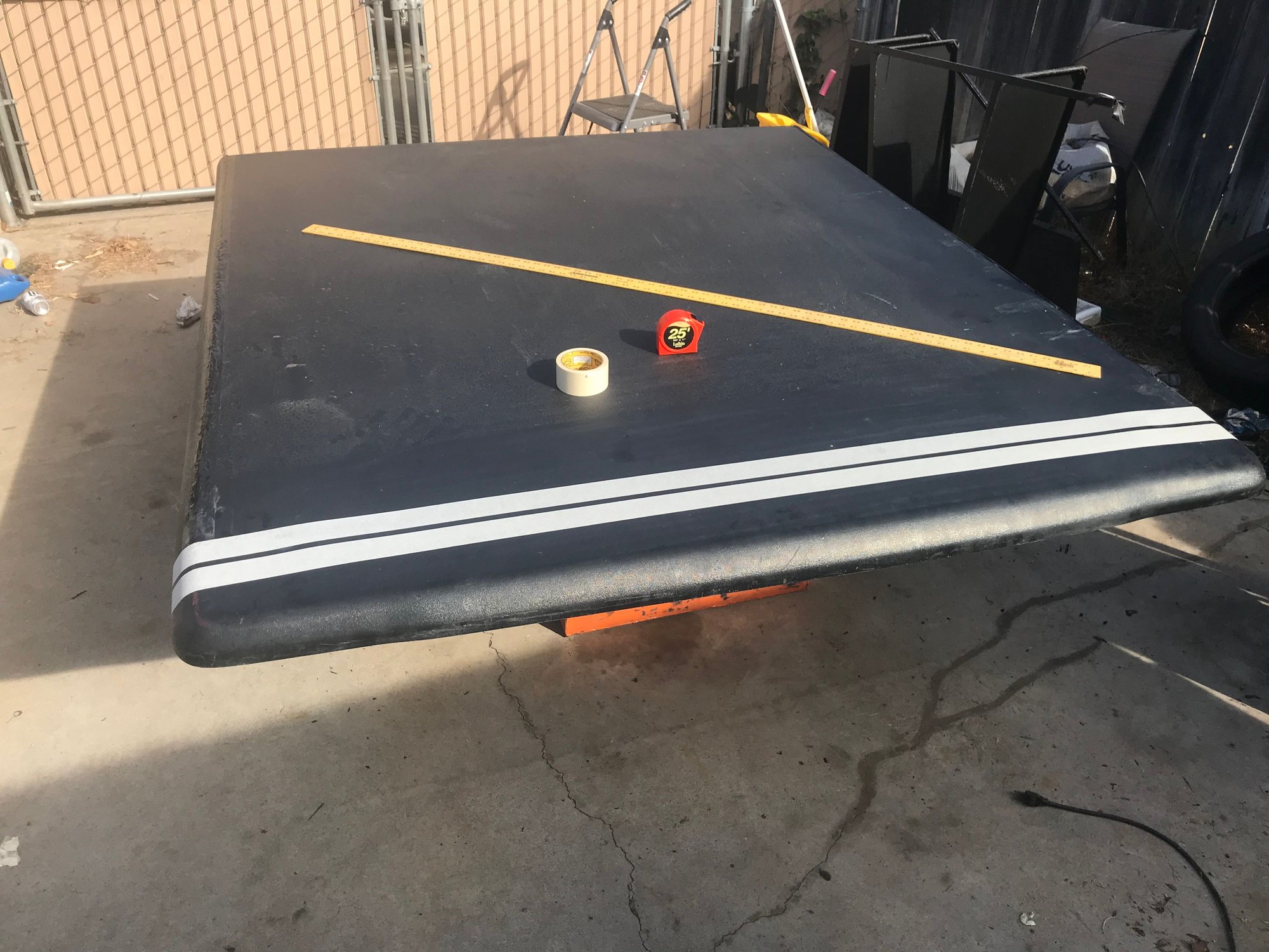

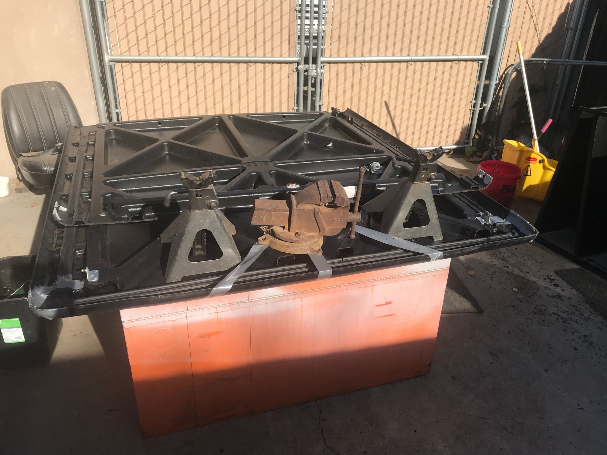

Today, I spent a little more time glueing the heck out of this ugly ABS tonneau cover (cut it down from a Ford SuperBooty shortbed)

I'm in the OC down in Santa Ana. Not that far from you. I used to live up by Glen Avon a long time ago. Your cover is looking good. I hope it stay together. Did you use small pieces of ABS to make lap joints or did you just butt everything up?

Not too far. It’s getting there and it was free. Everything is butt-glued together. The sides are very rigid, and I’m working on the back piece right now. I’ve glued the butt joint, as well as put about 1/4” of glue on the top and bottom side. Hopefully it will be fully cured by next weekend, so I can bolt it on. If it flexes at any joints, I’ll lap some pieces on the bottom side.
