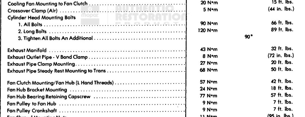

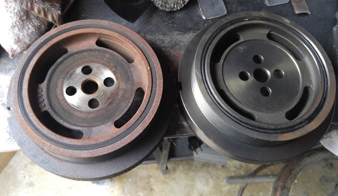

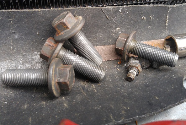

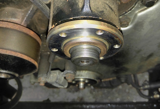

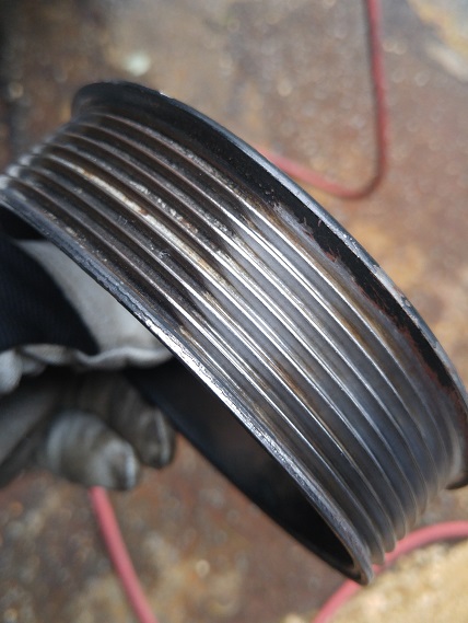

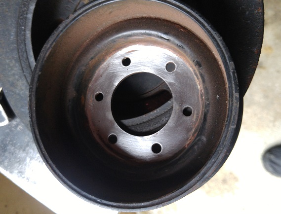

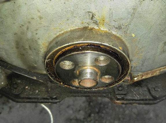

Pulled my vibration damper off today, and cleaned up the crank mounting. While I was there I pulled the idler pulley off, cleaned out the belt grooves and backside of the pulley / idler mount for a cleaner fit. Needed the barring tool in the adapter plate to crack the bolts without removing the radiator.

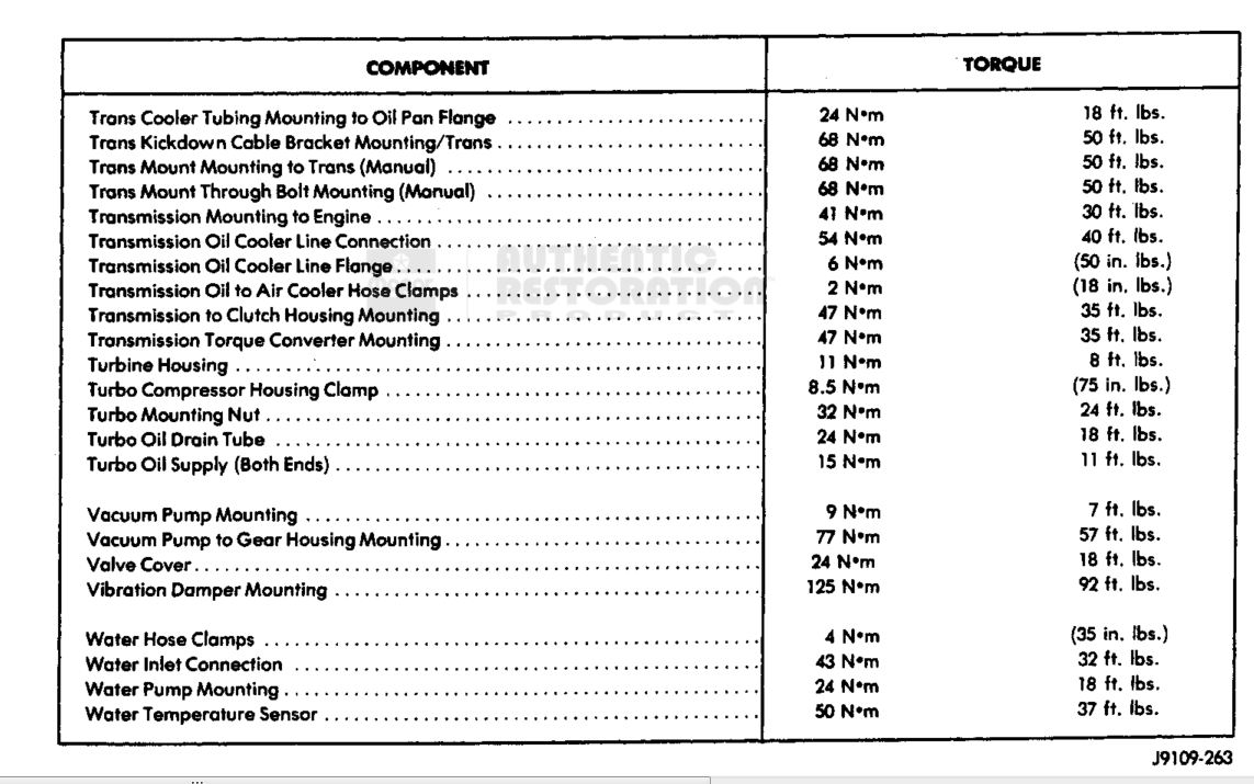

New VD is going on today, and for anyone who needs the torque spec, they're attached.
VD 92 FTLBS
Idler pulley 7 FTLBS

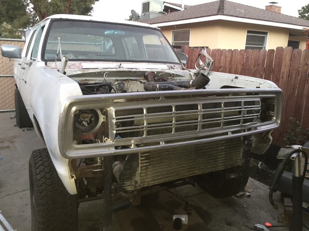

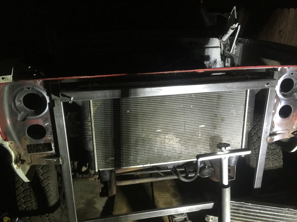

I managed to stuff a 2nd Gen radiator and intercooler behind my early 70's grill...still have to get some tabs welded on the intercooler tomorrow and paint everything. It's a REALLY tight fit, I see now why so many guys switch to the 91-93 front end.
A/c condenser as well ??
I was under the impression that a/c would make it impossible to fit
Love those early grilles . bird bath hood next ?
