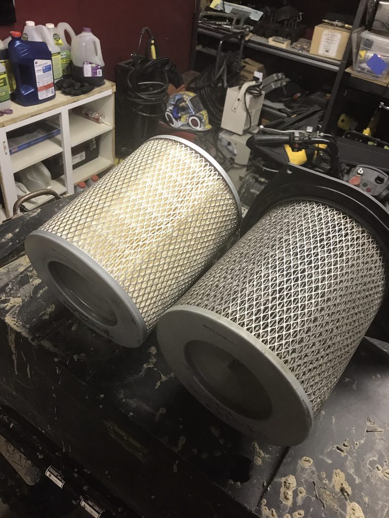

Rolled up another 5K km's on the truck...365K km's now...so swapped in another new filter, that's over 15K km's since about April, rolling some miles this year. Also decided to change the air filter since I couldn't remember when I did it last but was sure it could not have been more then a year and a half....well I put the date and mileage on my filters when I install them so I was a bit surprised when I pulled the air filter out and I installed it back in November of 2016 and mileage was 302K km's. So 33 months and 63K km's it was definitely time.

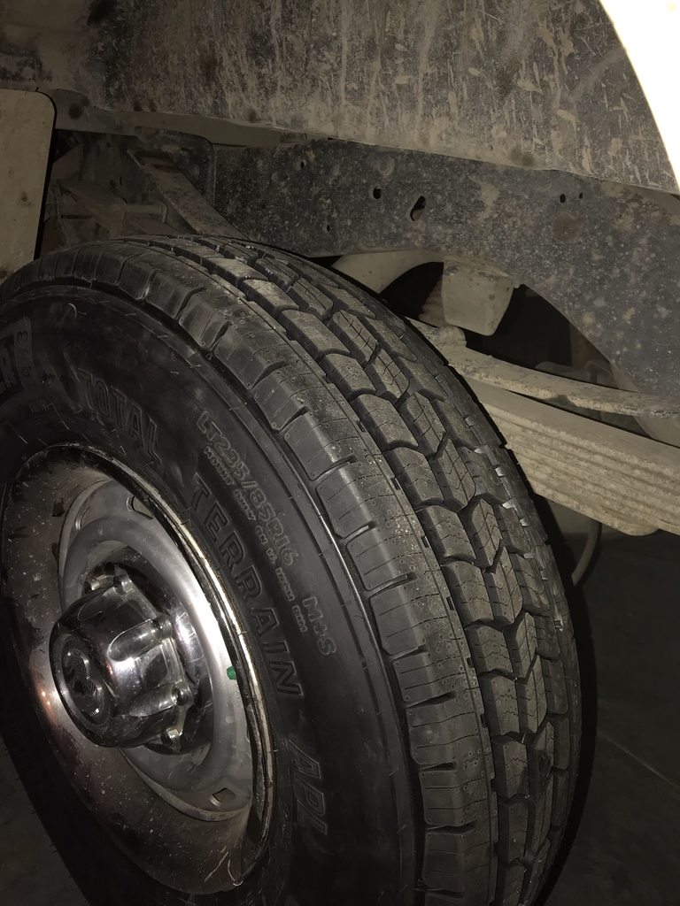

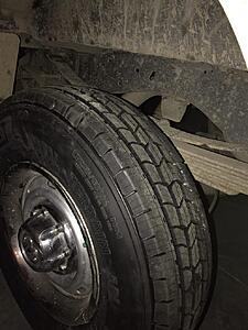

Also put some new summer skins of the truck, the old ones were worn down to almost slicks. Couldn't afford high end tires this time since I have had to buy 2 good sets of winter tires for the daughters cars since their winter driving safety is very important. But these tires are made by Cooper but are sold through Canadian tire under their Motomaster brand, and they were having a sale on the 235/85/16 tires so got a screaming deal on them as well. Read a bunch of reviews and they all said they were pretty decent tires of thread wear and ride quality....we will see I guess.
