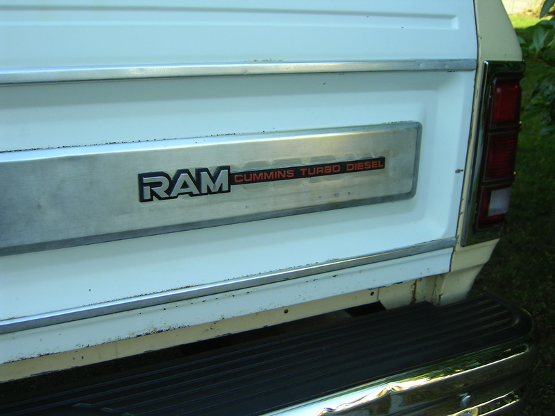

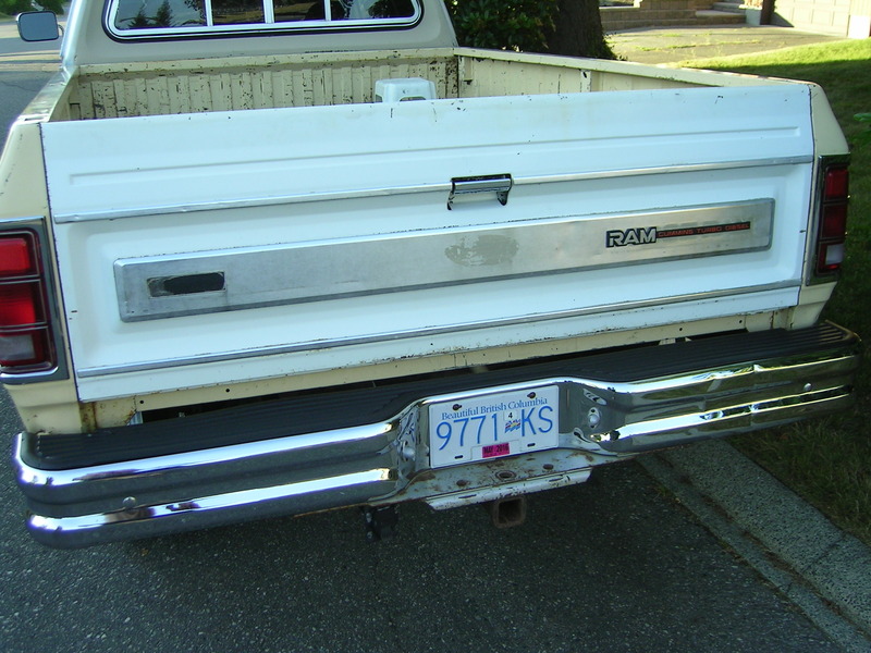

I also swapped out my 93 LE tailgate since the latches were starting to fail and only the RH side was actually grabbing...barely. I swapped for one of my earlier tailgates. The center brushed aluminum trim panel was missing the "Dodge Ram" emblem, so there were 3 holes visible.
So I dug through my box of misc ram emblems and made this up. I had a set of "Ram 150" emblems, so I cut off the 150. And the "Cummins Turbo Diesel" was cut off a junk set of "Power Ram 250/cummins turbo diesel" emblems. A little black paint along the edges where they were trimmed, and some 3M trim tape and voila!

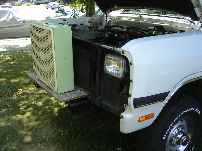

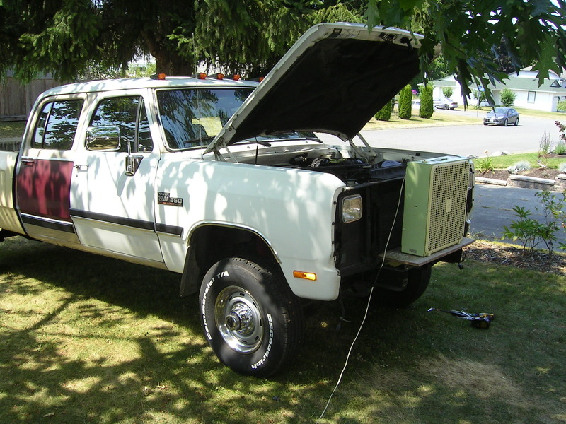

Did some AC diagnosis today. Wanted to see if the AC would blow cooler with no Power Stroke Intercooler in front of the condenser. So I pulled the front of the truck apart, then stuffed an old fan in front to help blow air across the condenser.
It was 37*C (approx 105*F) and with no IC in the front I was seeing about 57*F from the vents. After reassembly I ran the truck again and the temps jumped up to about 65*F.
So clearly the Intercooler is causing the efficiency of the system to drop.

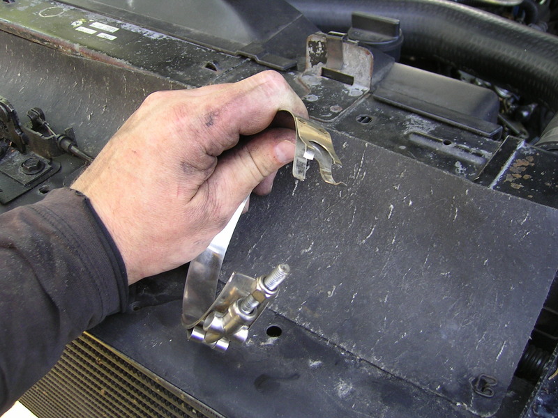

Thankfully I had a spare big one from ??? That worked as a replacement.
