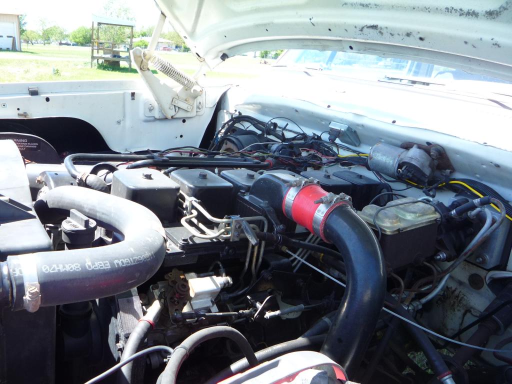

I have checked out as many threads on the Hydro boost swaps i can find on our 1st gens. The plastic MC reservoir basically sits up against the intake tube.
Been thinking about if I could make my own shorter bracket, and then make an adjustable push rod from the original Hydro unit, and one from an old brake booster?
That's th way I did my jeep. I used a flat plate. that way it is about the same liength as the vacuum booster.

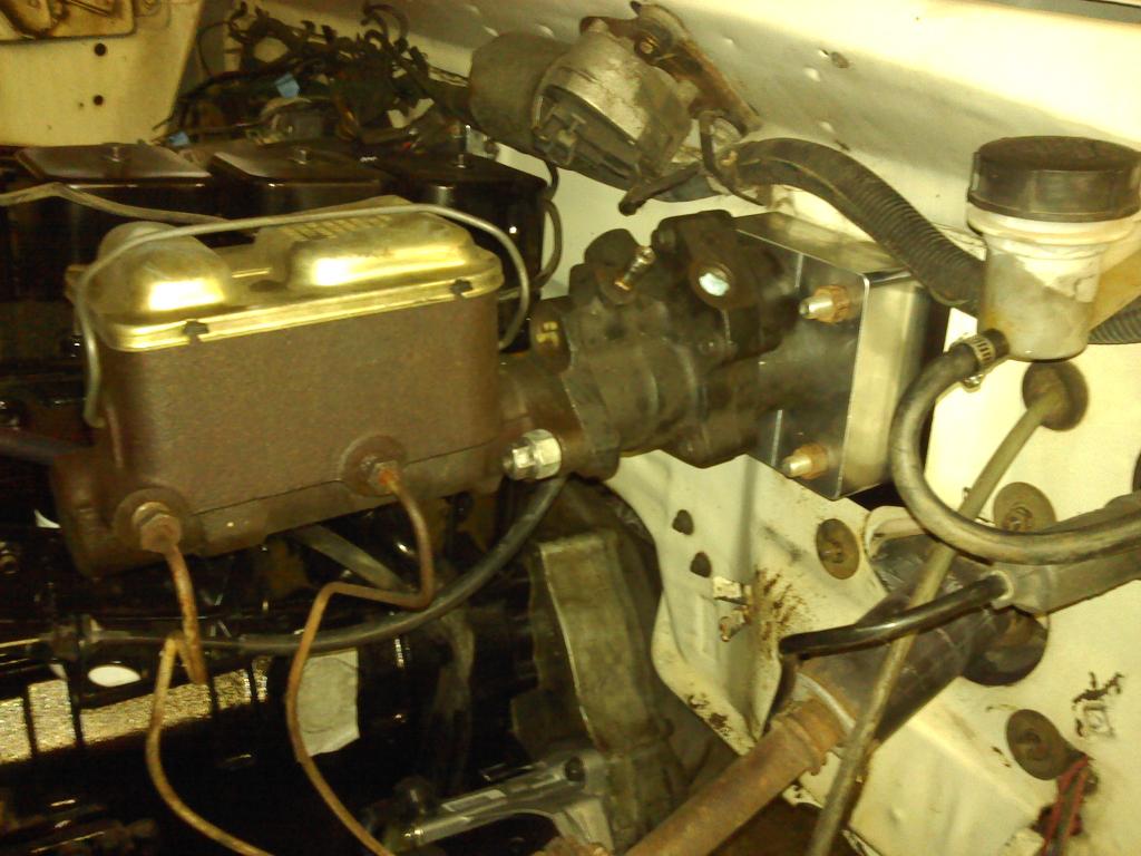

Here is some food for thought... I used an early 80s Chebby booster and master on my crew cab. It uses the rod that it came with, the aluminum bracket is used to bolt the assembly to the firewall and space it so the rod length is perfect. I used the same setup on my extended cab BUT I had to run a 1998 Chevy 1 ton aluminum master with the plastic tank to clear the P-Pump, I do not have a picture of the P-Pump setup. I hope this helps somebody.
