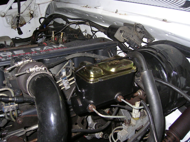

Well today I swapped in a NEW Napa Master Cylinder. I was going to get one locally here in BC, but the best warranty I could find was a 1 year only! Just across the boarder at the US Napa I could get a new unit with a lifetime warranty! Seemed like a no brainer to me.

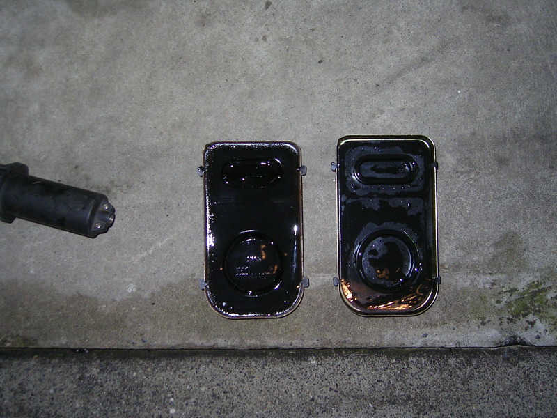

Gave it a coat of paint, but as other s have found the lid leaked before I even got it on the truck.
Here you can see the reason for the leaking. The old "Made in the USA" seal vs the new generic no name brand.
I cleaned up the old seal and installed it on the new cap and so far no leaks.

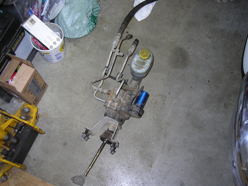

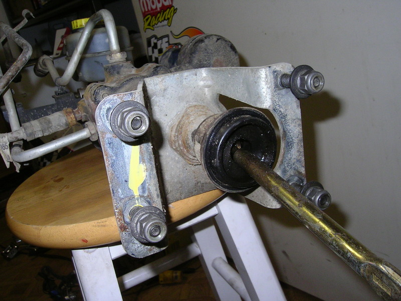

The other night I started obsessing over a Hydro boost conversion for my crewcab. I then saw a craigslist ad for a 2000 cummins ram being parted out. Several E-mails, and a phone call later had me over at the guys house pulling a hydro boost set-up!
Was a little disappointing that it was leaking out the back once I got it out and could inspect it.. So I wasn't going to take it, but he was willing to sell it at core charge value. Figured I went 45 min out to his place I may as well return with something.
Nice guy, he bought a nice 90 2wd 1st Gen with the insurance settlement from his 2000. We chatted diesel trucks for a bit before I headed out.
Now to see if I can find a reseal kit for this unit, and then a "How to" on how to Re/Re it.

It looks so long in the pictures! Almost as if it'll extend beyond the intake horn . I'll be watching for your installation how-to, Brian!
Old Apr 7, 2015 | 08:25 PM
  #898
I have checked out as many threads on the Hydro boost swaps i can find on our 1st gens. The plastic MC reservoir basically sits up against the intake tube.
Been thinking about if I could make my own shorter bracket, and then make an adjustable push rod from the original Hydro unit, and one from an old brake booster?
