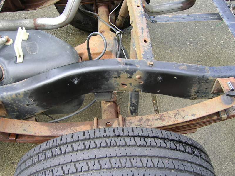

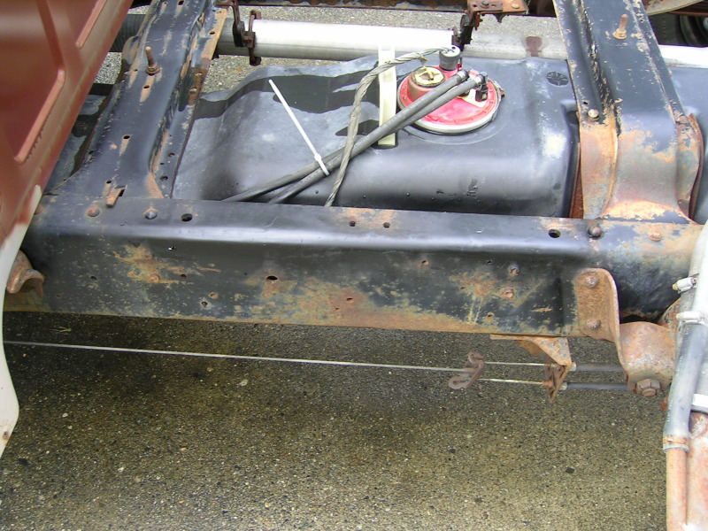

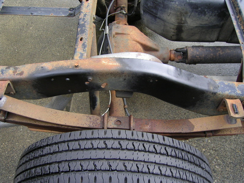

Old Aug 25, 2012 | 01:47 AM
Now you can see all the brackets that were welded to the frame...5th wheel brackets, goose neck bar etc. Now I have to cut these off and clean up the frame...tomorrows job.

Here's a frightening pic....goose neck bolt...one or two booger welds away from failure.

Old Aug 25, 2012 | 01:48 AM
Got the frame all cleaned up and painted. Took a couple hours...ate through a few grinding disc. Found out that they tend to explode if you get them too hot....
