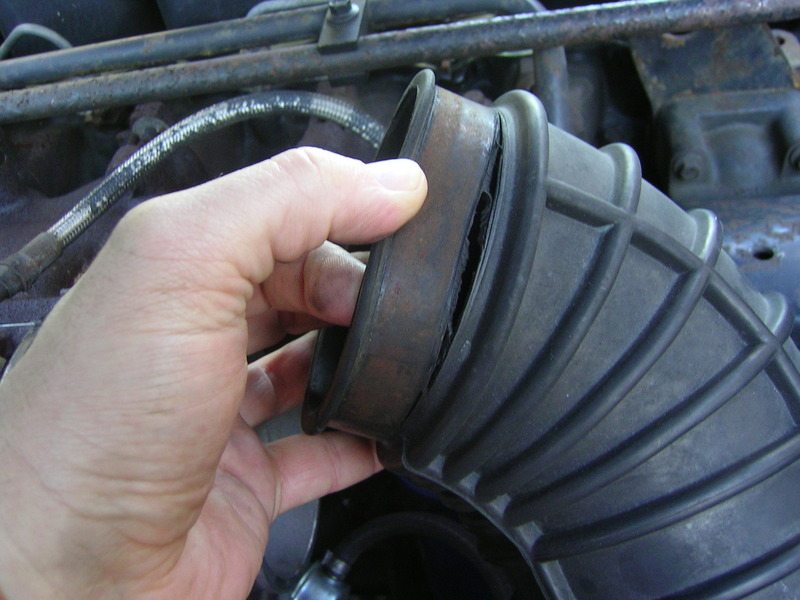

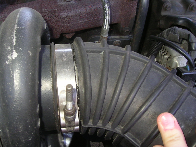

Rolled over my oil change interval when I was traveling, so today was service time, and clean up the 'Ol beast from it's winter travels....especially since it was going to be about 16*c (68*F) and clear and sunny!
So I changed my oil, with a WIX oil filter, and tossed in a fresh G2 5/16 fram fuel filter. While removing the air box to turbo tube to give me some room to do the oil filter, I noticed something wasn't right.
Luckily I had a spare one in my parts horde....
I also rotated my 5 tires, and flushed my brake fluid. Was a good productive day!
