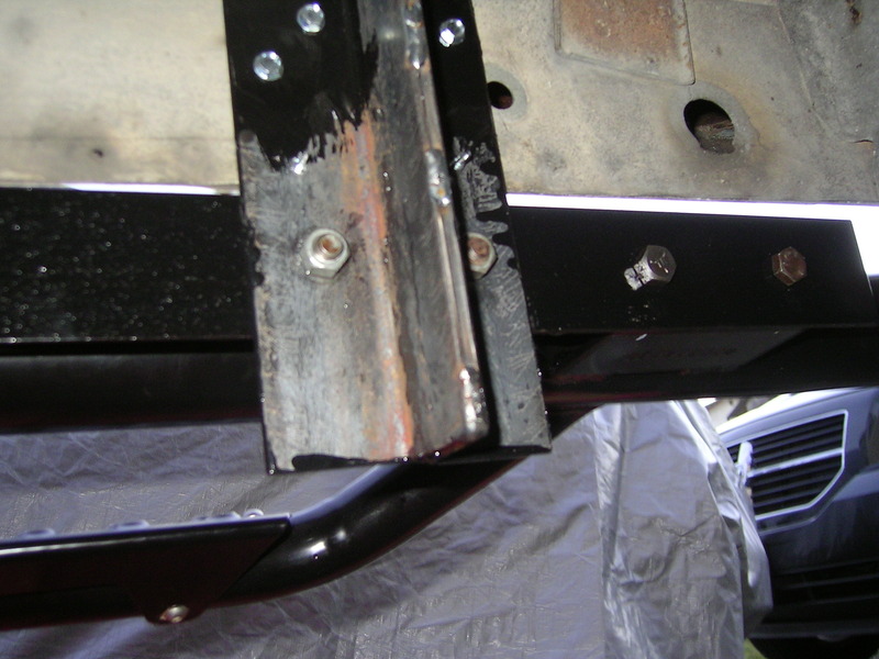

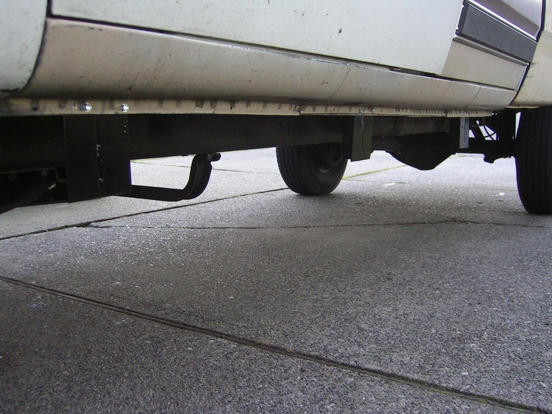

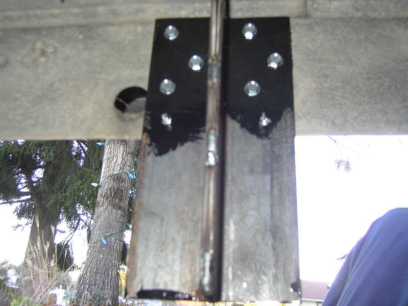

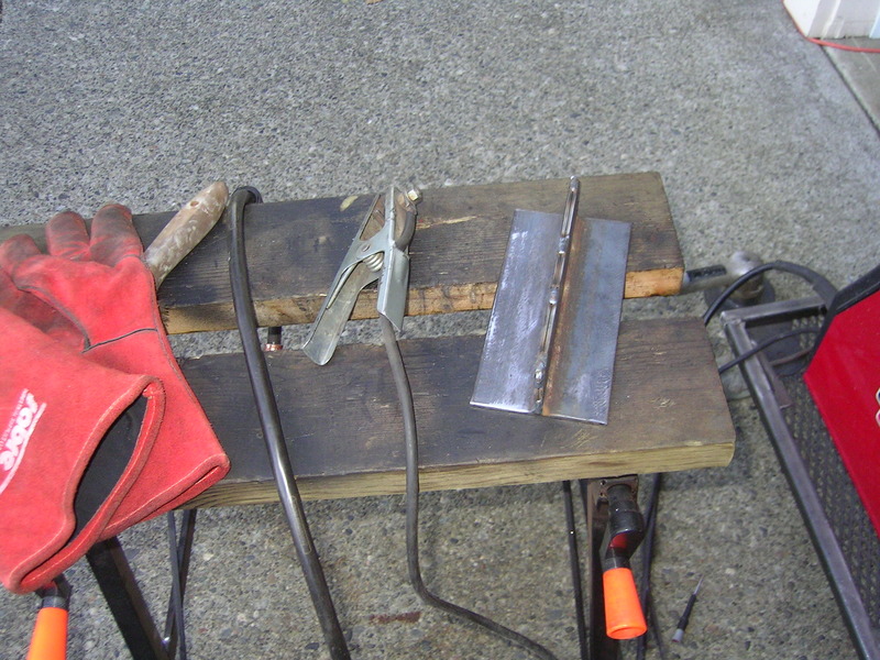

I had to figure out brackets and how I was going to mount them, since they did not come with brackets, nor would they have worked due to fact that the bars were being used on the opposite sides.
So after thinking and pondering this, and looking at how others have mounted steps and bars, I decided to use a bunch of 2" angle iron.
I cut 12 pieces or 2" angle at 8" long and welded 2 pieces of them together to make the brackets from the body to the steps.
Drilled 6 holes in each bracket and used some self tapping screws to hold them in place.
And once in place I screwed 2 more from the front side through the pinch weld seam at the bottom of the rockers, into the bracket....very stable and secure now!

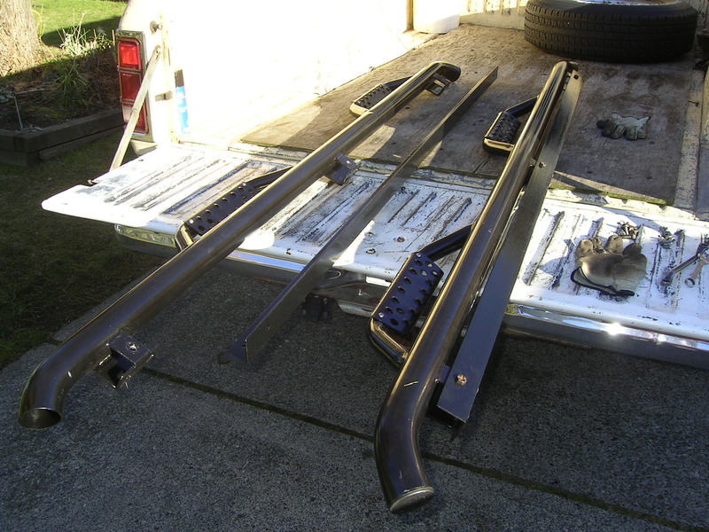

Once the brackets were in place I had to mount more angle iron to the steps themselves. Had to mount them with clamps and then drill holes to line up with the holes in the brackets on the steps. I also added an extra bolt through the top of the step mounting brackets.
Coat of brush on Tremclad and then mounting the angle iron brackets.
The idea was that the flat brackets off the body, and then the angle iron on the brackets, would give me a nice flat surface to get the steps positioned easily. Just clamp them in place once everything looked right, and then drill holes to mount them permanently.

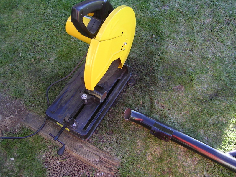

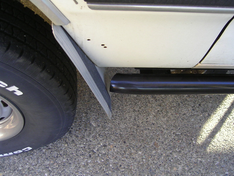

Once I was actually able to hold them up in place I found that the front section of the step bar tubing was to long, so started by cutting off 4".

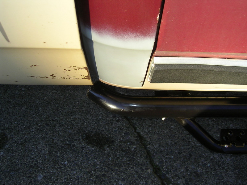

I eventually had to cut off another 2" and then grind the front edge flat to clear the mud flaps.
Clamped in place.....
Drilled and bolted in....

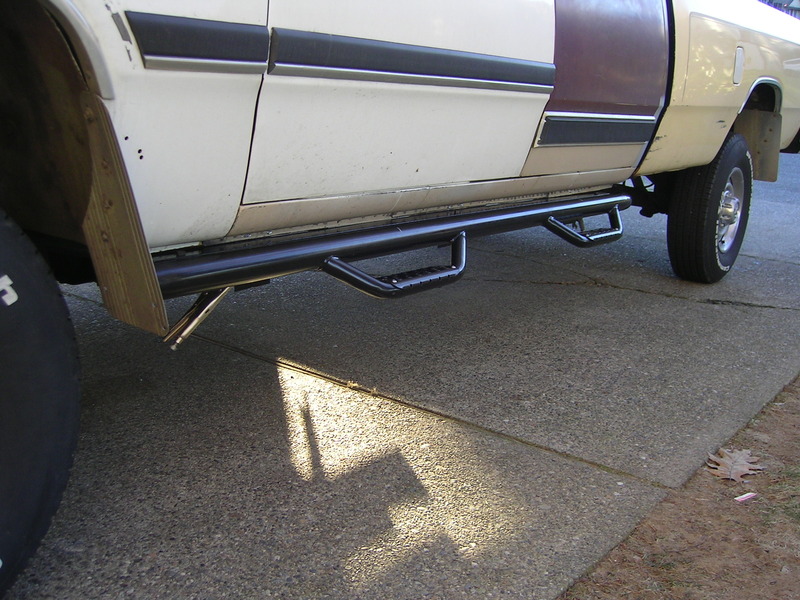

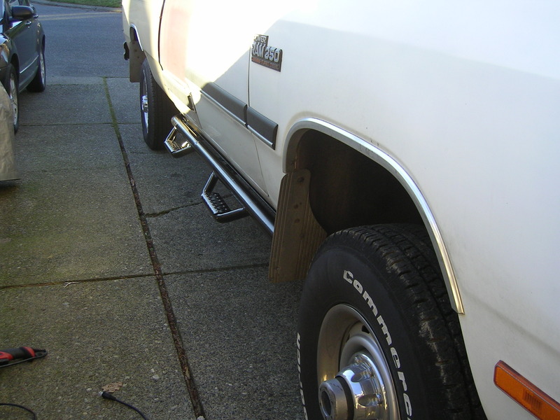

And all done....

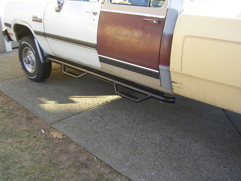

I like how the rear section (actually front section... ) of the step bars follow the body line of the cab!
A bit of flex in the steps...but I think it's because of the thickness of the long angle iron piece on steps...seems to have a bit of rotational flex....the body to step brackets don't move at all.
Over all Very happy with how it turned out!

Looks good! Those are some slick steps. Looks like they were made for the crew now :P
If there is still too much movement in the step would you be able to make a support that bolts to the frame with a rubber body mount? I think I might be paranoid of anything or anyone bumping the steps and damaging my rockers but maybe that's just me.

Thanks Dan and Mark.....wanted something a little different. You don't see these ones too often, at least around here.
