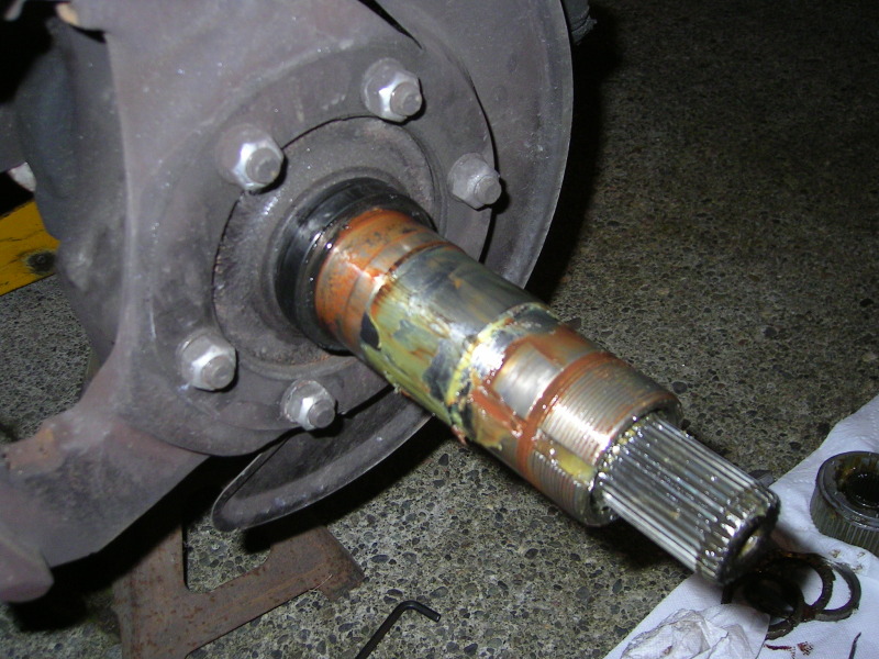

Well I have been having some weird diff issues for a while now, been getting worse over the last few months. Felt as though the power loc unit in the rear D70 was not working right, or was failing...which it shouldn't because I had it all rebuilt when I had the diffs re-geared back in Nov/2014.
But it also kind of felt like it could be coming from the front end. Since we have a 1000 mile trip planned in the crewcab in a couple weeks I wanted to check the front bearings and seals to make sure they were all good. I figured in two years since the big front end rebuild that this would be a simple check, toss some new grease in a few places and be done with it....well things seldom go as planned.
Here's the pass side....
Front bearing.....

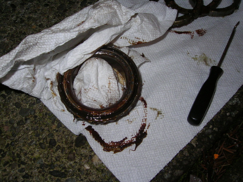

you can see the inner seal was cooked right out!
Lot of water had made it in.
The drivers side was a lot better...no rustiness, but still a lot of dark contaminated grease.

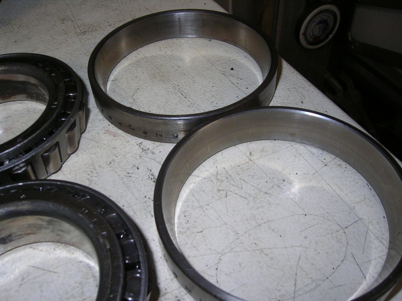

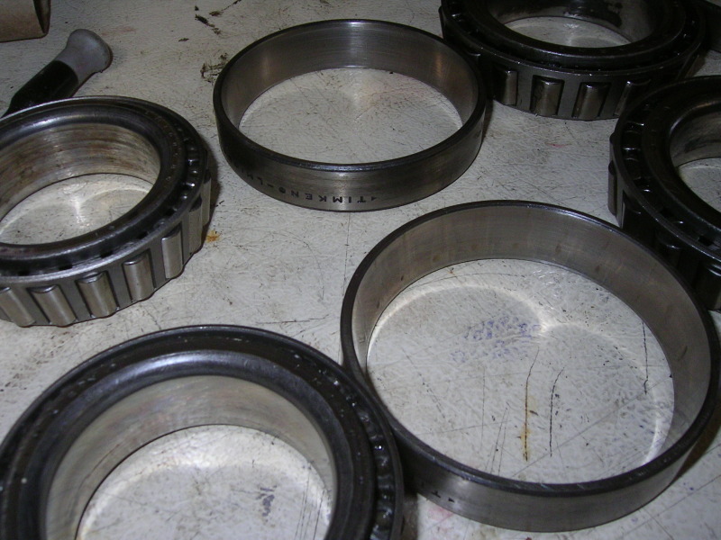

It was about 6pm yesterday evening and luckily the parts store just up the road from me was open until 7pm. Was just planning on doing the rear seal, but the old Timken bearings and cups were looking worse for wear, so figured I'd grab all new ones. I had forgotten that I did not replace them when i re-did the front end before.
Unfortunately they did not carry timken bearings...SKF, and made in China/Japan...But I couldn't be picky right now.
