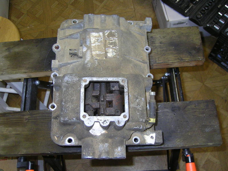

Well I've been scrounging up parts for some time now to change out my top cover on my NV4500 from the 94-96 bottle top shifter, to the 97-02(?) 4 bolt removable shift tower top.
I scored a good deal on a nice top cover, but it was missing the shift tower.

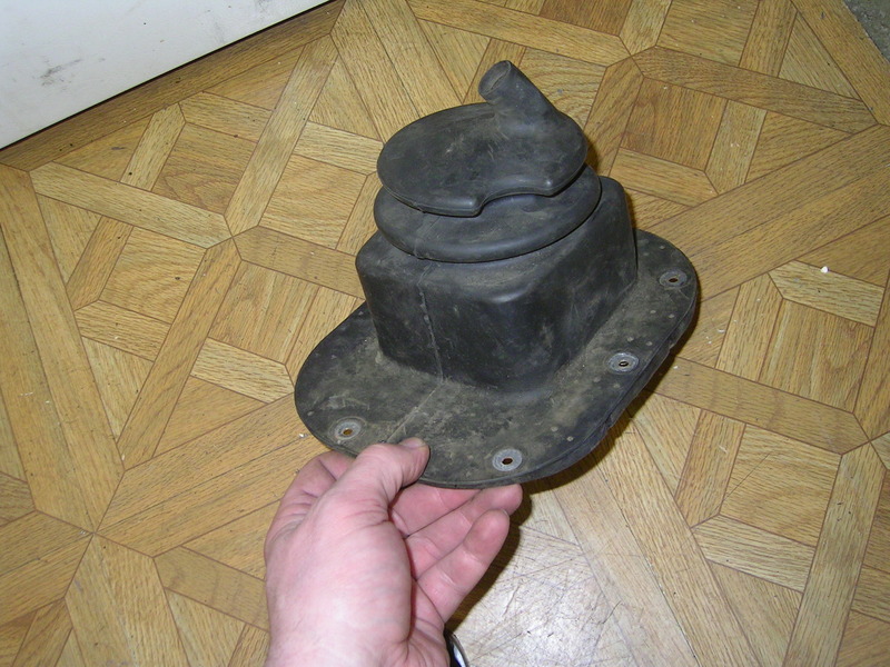

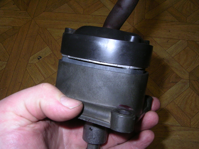

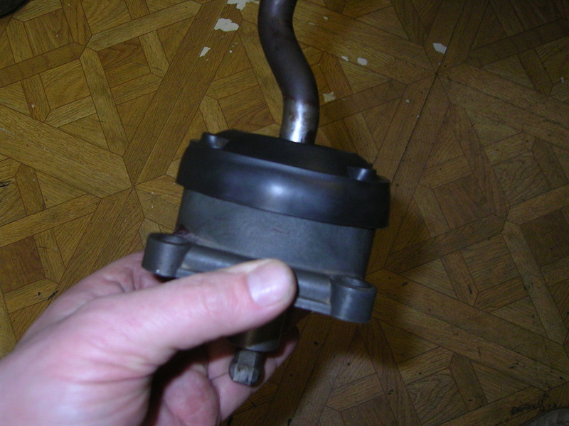

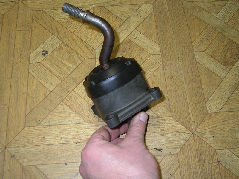

I have been searching for a decent used OEM shift tower for some time now. I finally got a complete set from a 99-02 is Ram. Here's what I got.

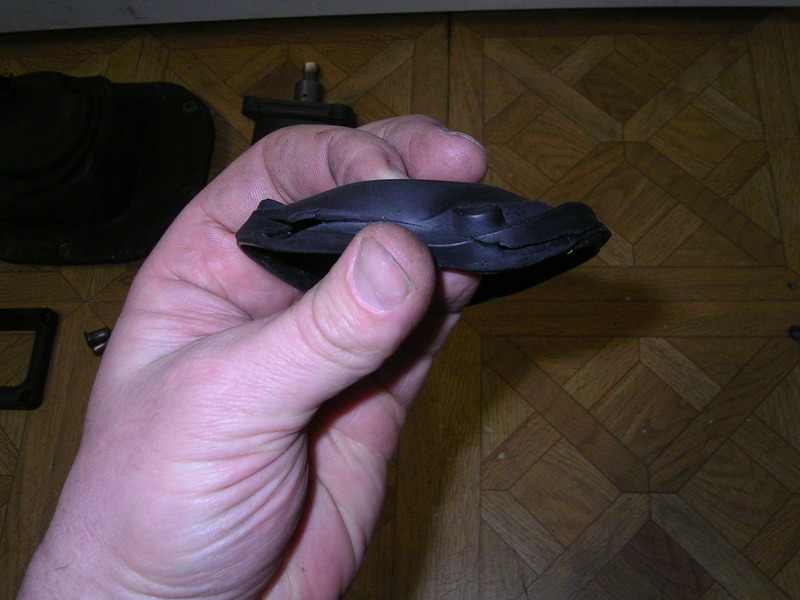

Everything but one bolt. Not in bad shape overall, but the darn shift tower boot was torn. I specifically asked the seller about it, and was told it was good, but clearly not.

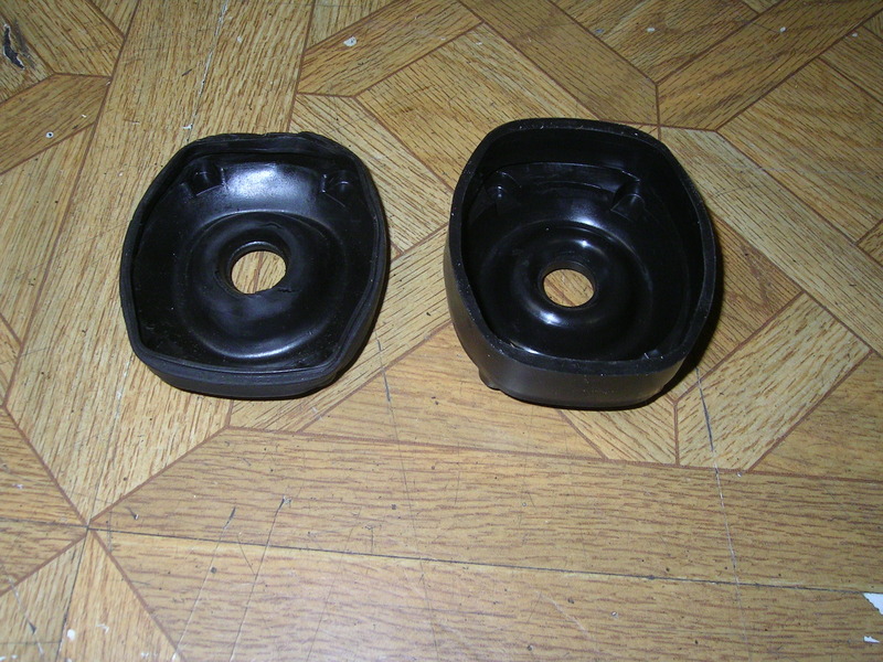

And the original OEM NV4500 shift tower dust boot vs the NV3500 shift tower dust boot.
As you can see the NV3500 boot is slightly longer/taller then the NV4500 boot. But other then that it's identical.

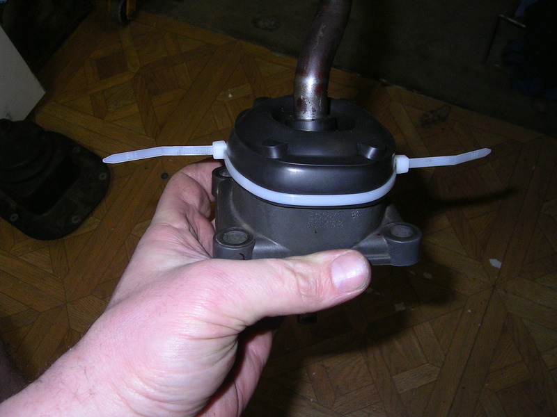

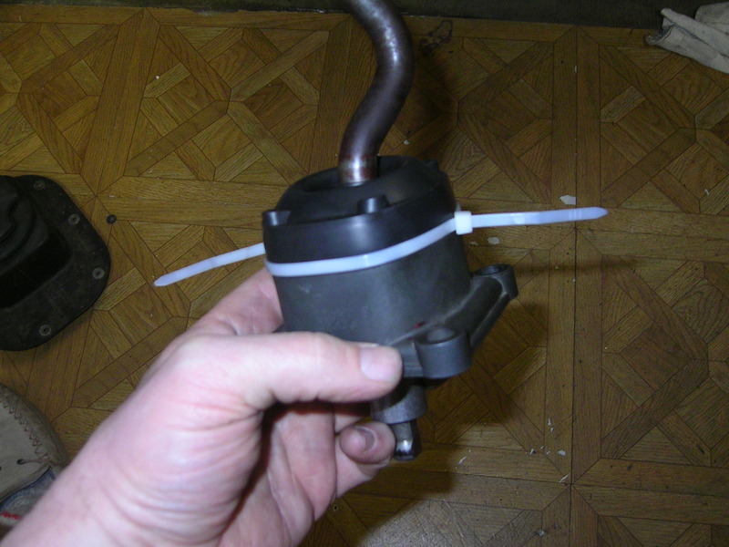

I tried to think of a way to hold it in place...considered filling the groove with silicone, or some sort of adhesive. But thought that it might cause me grief down the road. Then I thought a couple zip ties might apply enough pressure to hold it in place.
This I think could work.

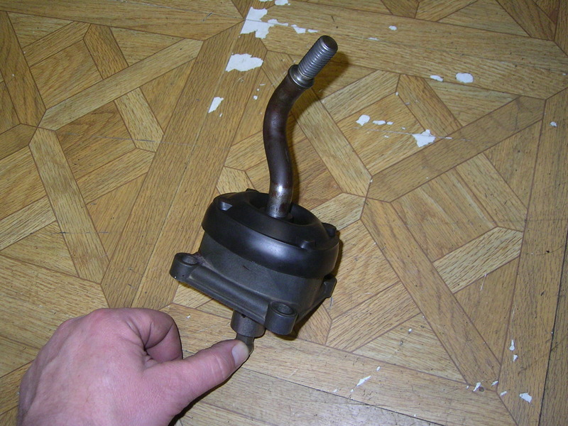

I then squeezed the boot down all the way over the shift tower body, so it was as close to sitting in the OEM location as the original piece. The groove in the upper portion of the NV3500 dust boot is very close to fitting, but due to the "stretch" over the body it is distorted enough to not "snap" into place.

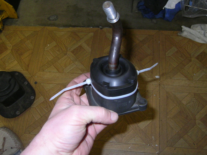

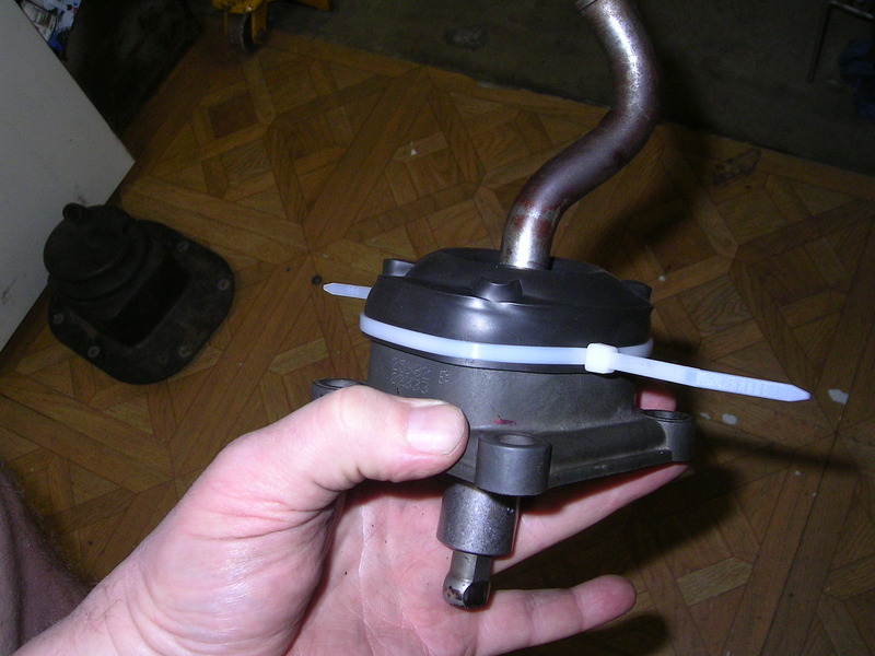

I then decided to try the zip ties in this orientation. I like the way this sealed up better then the early set-up.
I think this is the arrangement I'm going to try. At least it seems to seal properly, and should stop any dust or debris from getting into the tranny.
