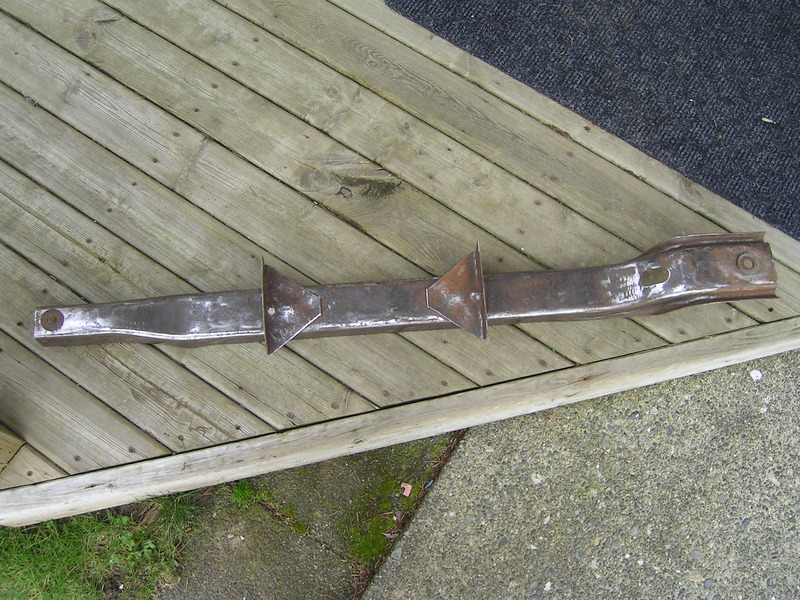

Been working on the main bathroom reno's, and put down some mud so decided to do a little work while waiting for it to dry.
Pulled out my spare tire holder and hit it with the knotted wire wheel on the 4.5" grinder.

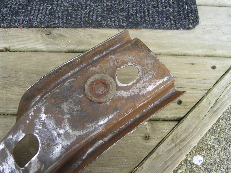

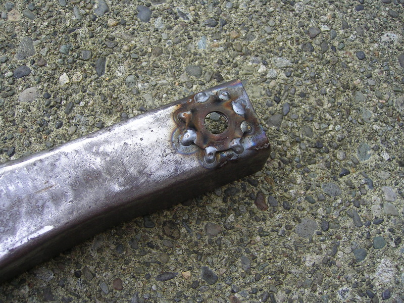

The holes where the rods run through were wallowed out...figured I'd weld on a couple washers.

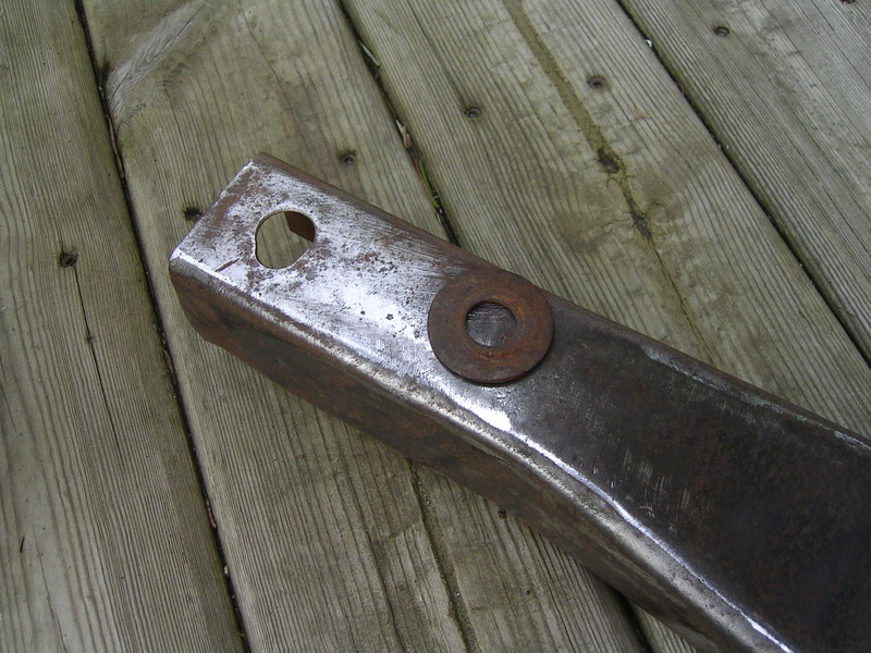

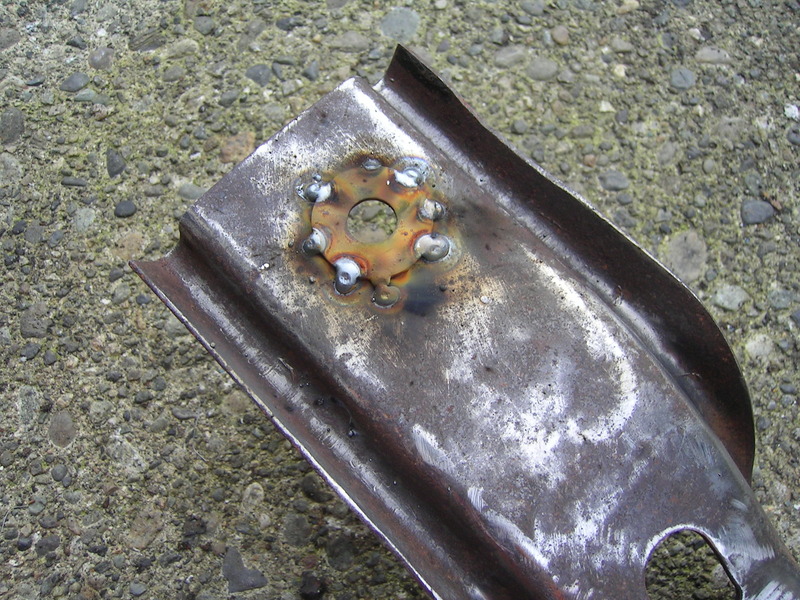

And washers welded on.

It's in the garage now getting a couple coats of Tremclad paint.
