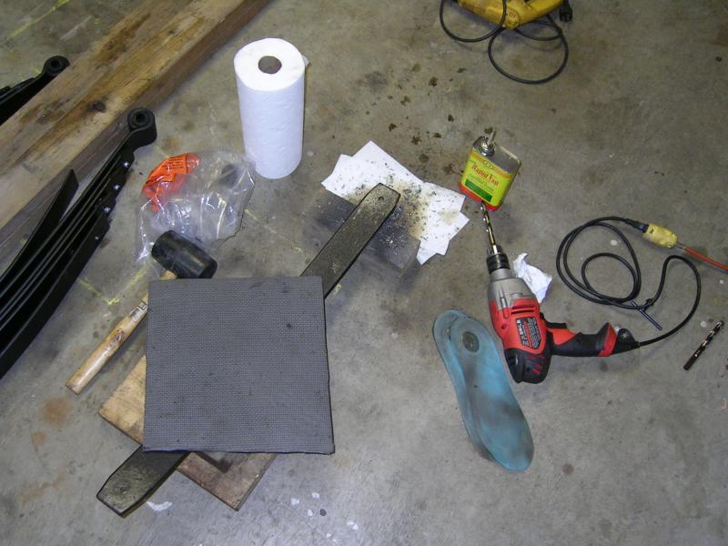

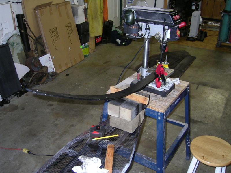

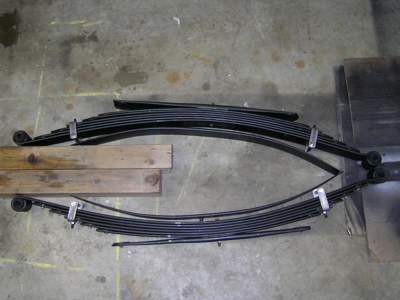

Been working on getting the rear springs all back together.
I thought my neighbors drill press had a slow slow setting...but ti would only go down to 800rpm. I drilled 3/8 pilot holes at that speed first using some areo space drill bits I picked up at a swap meet...worked really well.
Once the small holes were drilled it was on to the big 7/16 bit. Couldn't find any decent cobalt bits...so went with some bits designed for Stainless Steel. Worked pretty good. Slow speeds and lots of cutting fluid. But since the drill press wasn't slow enough I had to do all the big holes with the hand drill.
That sucked...legs and back hurt a lot.

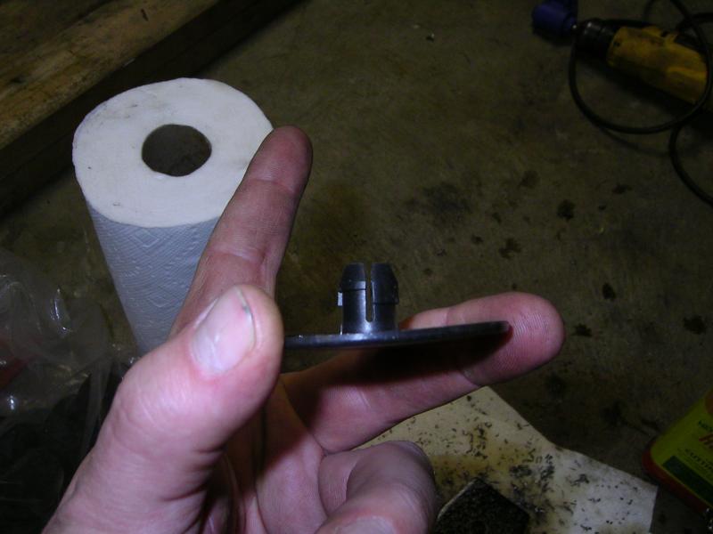

I had bought some wear tip pads on-line...thought they would do the job. Went to install them and they just wouldn't sit nice and snug. Even though they said they were for 7/16" hole. So I went down to my spring shop and bought some of the ones they use...nice and long...and work in 7/16 - 1/2" holes.
These are the ones I originally bought....
And the here are the ones I got from the spring shop...
Got everything drilled...new wear tips installed, and then bolted them back together. I re-used the old Zinc liners since they were in decent shape. Once I had the spring packs together I had to take them back down to the spring shop to get the pack clamp brackets (???) installed.
Just need to paint he brackets and they are ready to go in.

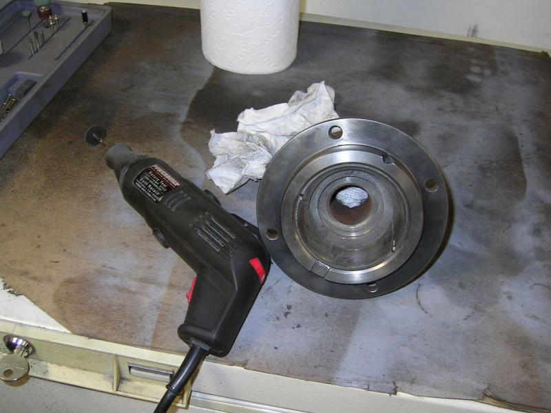

Since the springs are now done I decided to attack the last thing to remove on the NV4500. It is the input shaft bearing retainer race. I thought I would just slowly cut through with the dremel in two places and then tap it out.

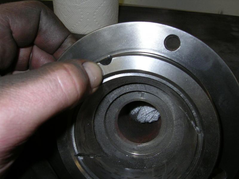

Seemed like a good idea in theory....but I guess with all my banging and hammering to try and free up the old race and get it out of the way I ended up cracking the bearing retainer...
Cracked at the oil feed hole. I'm assuming that the bearing retainer is toast now? Anyone have any thoughts on this?
I don't want to half a$$ things...if it has the potential to fail and cause me grief I'd just as soon replace it.

I was searching out new bearing retainers last night...The price on them is very reasonable. I was also looking at the outer surface where the throw out bearing rides....looks pretty worn, and I can feel slight depressions. SO I think this crack is a good thing, as those depressions could be why the old throw out bearing would hang up from time to time.
