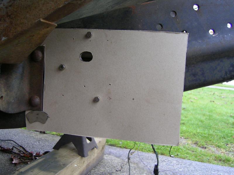

I made a couple templates and got the rear spring mount holes punched, and drilled.

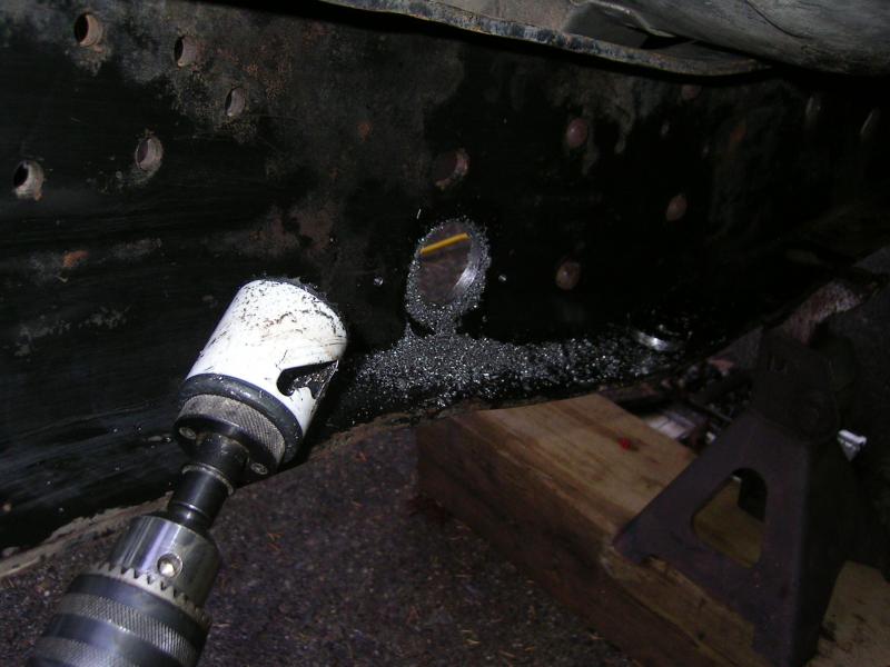

Bought a decent 1 3/4" hoke say to make the big hole in the frame. I used tons of cutting fluid, and then only cut in 10-15 second intervals before adding more cutting fluid. Took a good 5 minutes or so to, each side, to cut through the frame, but my hole saw still looks almost new.

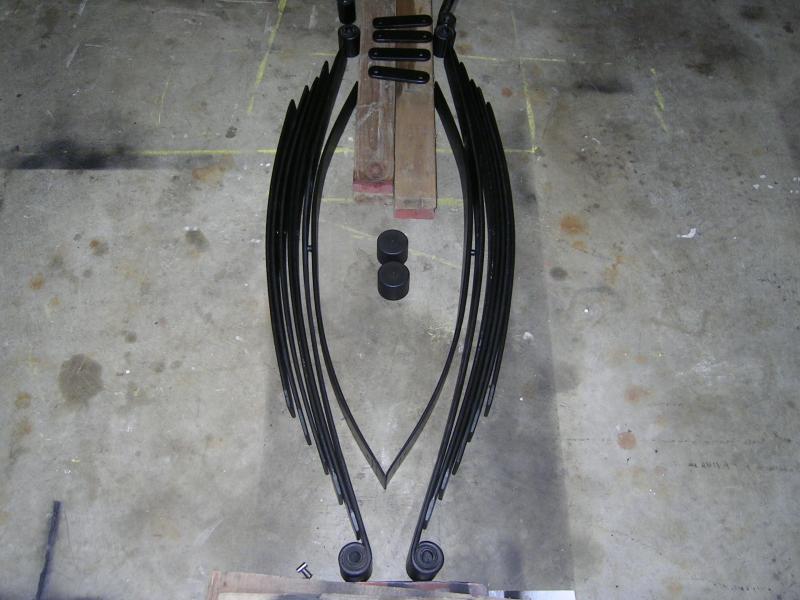

Got all new bushings installed in my springs. Got them all smoothed out with the 60 grit flapper discs, and then painted. Now I just need to drill all the tips for the poly wear pads and reassemble.

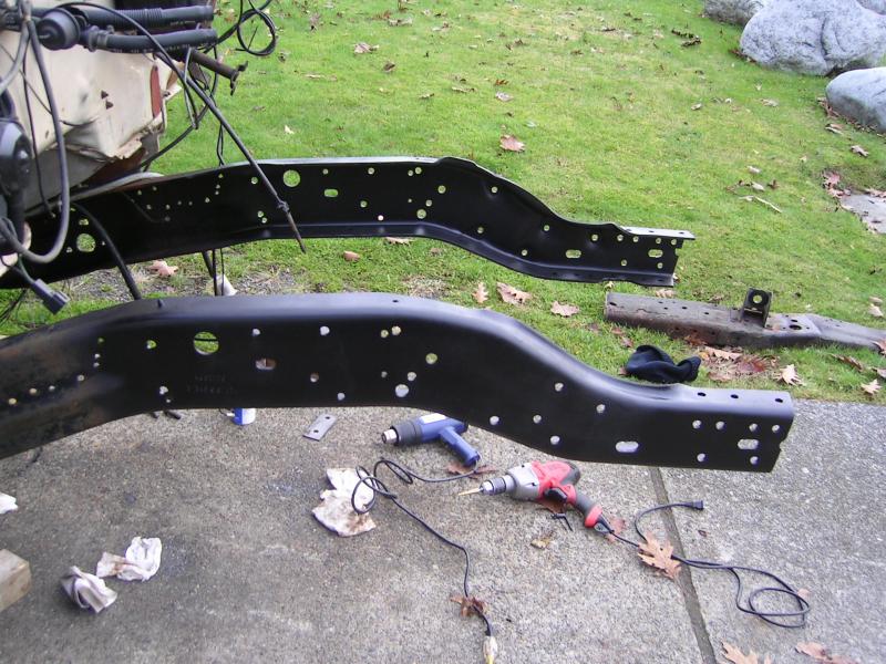

And since it wasn't raining today, and was a balmy 6*c (45*F) I spent all day today with a heat gun and a can of paint working on the frame rails.

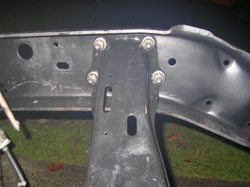

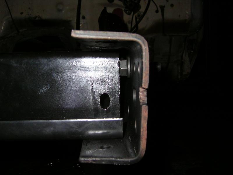

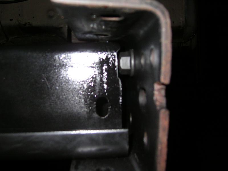

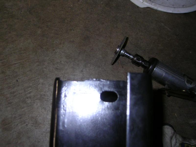

And with my flange head nuts and bolts in hand I couldn't wait until tomorrow to start assembling the frame. Got the rear spring hangers in first, Loctite 242'd and torqued. Then it was slide the center cross member in place and then start on the front cross member.

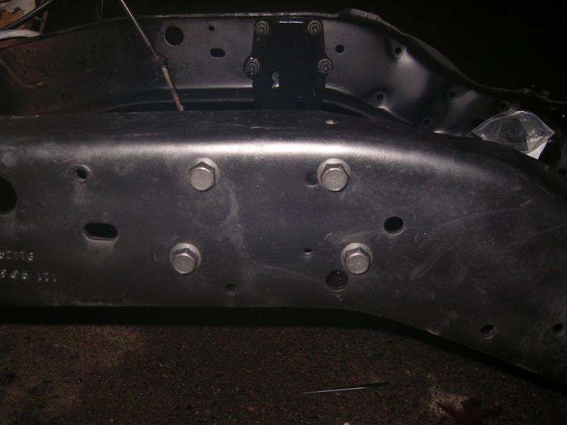

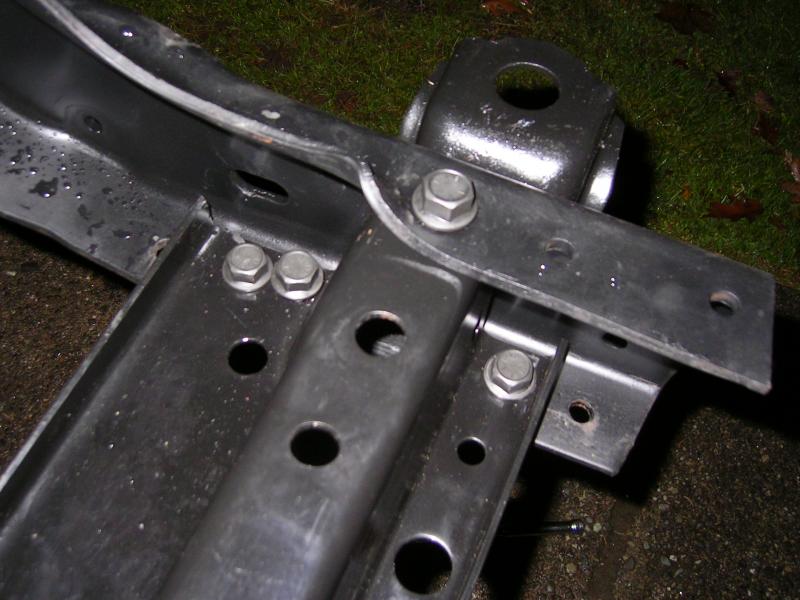

First thing I discovered was that things have to be assembled in a certain pattern. The three bolt that are behind the cross member have to go in first. I discovered that I needed to notch the cross member to clear the head on the upper/forward bolt head.
Few minutes with the die grinder and I had lots of clearance.

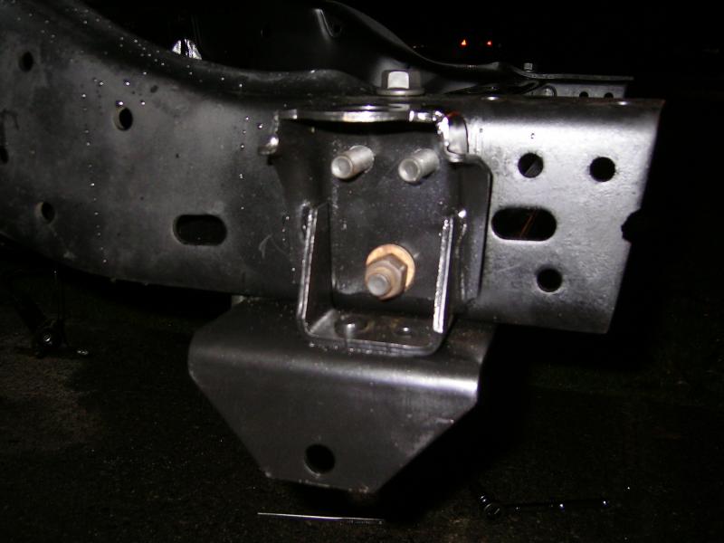

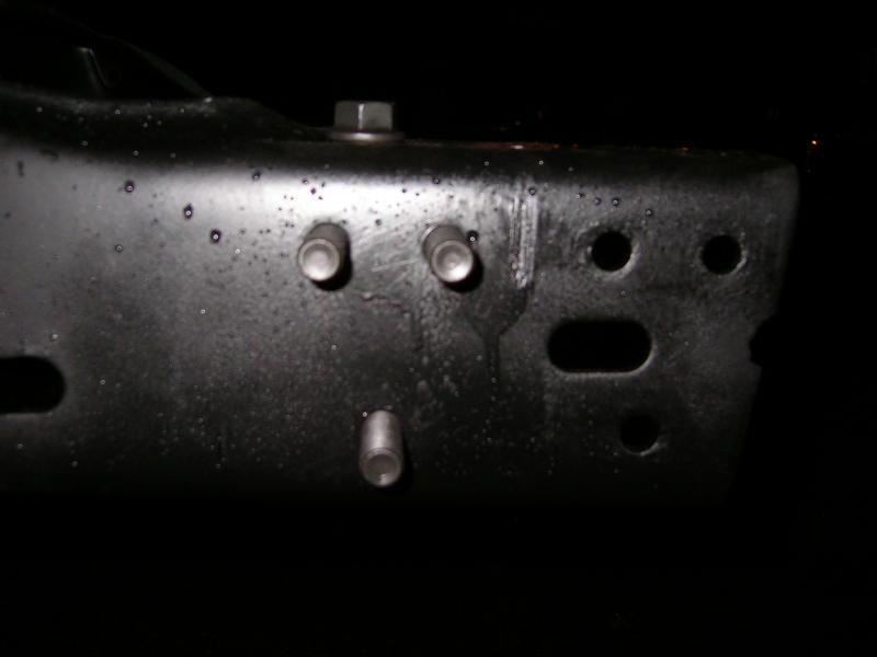

Then it was the front spring brackets that need to go on next. Slip it over the 3 bolts and then down under the frame rail.
To get it to suck up tight(er) under the frame and align with the holes through the cross member and frame, I installed a nut and washer on the lower bolt.
This got things "close" but it was still a lot of banging with the rubber mallet, and prying with a tapered round pry bar to try and allign all the pieces to get the bolts through.

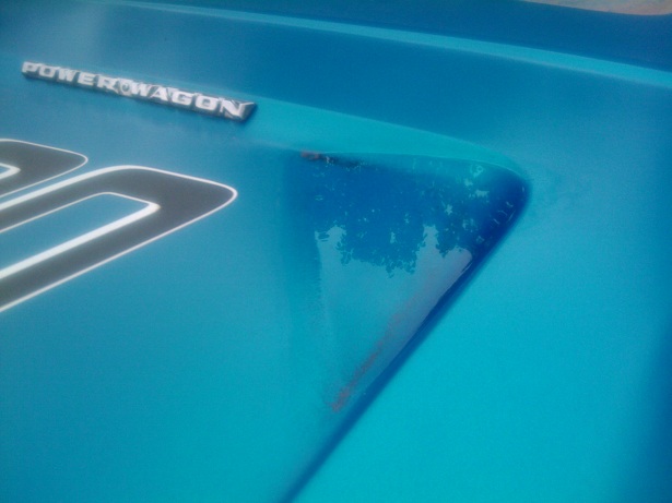

I just went back to the beginning of this thread I am really liking the bird bath hood. Are you going to put Powerwagon
Emblems on it. I am thinking of doing mine that way.
Nice work!
Nice work!
I will be using the stock white hood off the Donor 93 for now. But will eventually redo the birdbath hood. Will probably run either of them from time to time...as mood dictates. I would probably run small "Cummins turbo Diesel" emblems instead of the power wagon ones.
