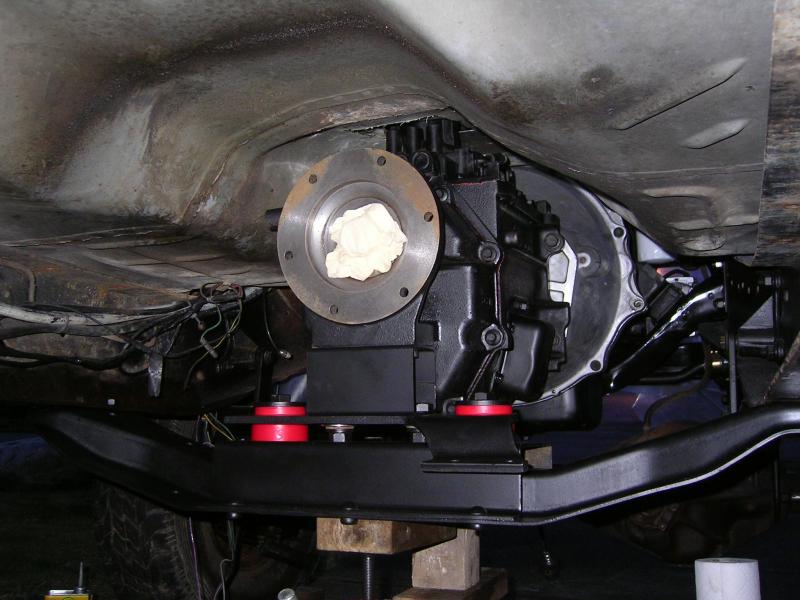

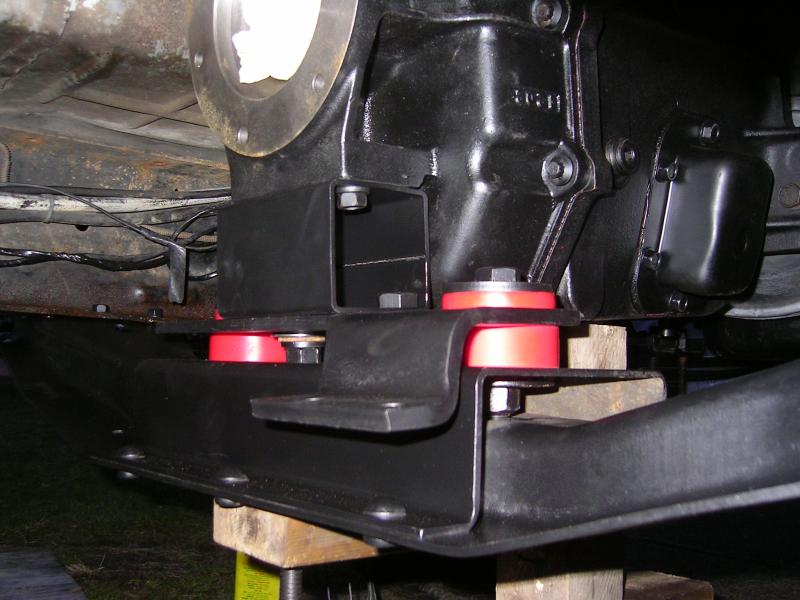

And today I got the tranny mount in...mostly. I had hoped that at least a couple of the existing holes would line up with the bracket....nope. So will have to drill all 12 of them.
I still need to get the upper brackets in, and then those 6 holes drilled.

I have been working on a few things as I find the time. As the above updates mentioned, I got the lower portion of the tranny mount/cross member in. Yesterday I got the rest of the holes drilled for the upper portions.
Drilling upwards, inside the frame rails $UCK$!! I had to cut down one of my big drills to fit...and the fact that I have no real idea how to sharpen it properly afterwards caused me all kinds of grief. I eventually got them all drilled, and the rest of the supports bolted in.

Where did you get those transmission mount bushings? Energy suspension?
They're from a small manufacturer of mopar poly bushings...PolyBushings.com
Here's the link...
http://polybushings.com/pages/1604.html
