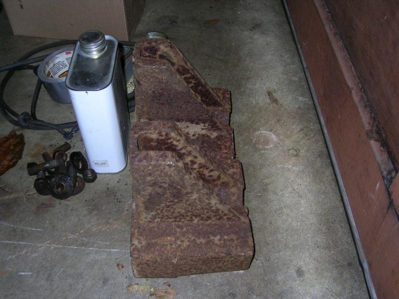

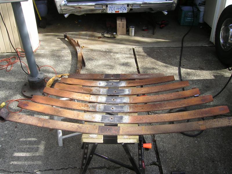

Well been working on a few things. Pulled apart the rear springs...to clean and drill for the wear tips to smooth out the ride a little. Man are these springs rusty! And they had worn their tips into the upper springs on most of them.

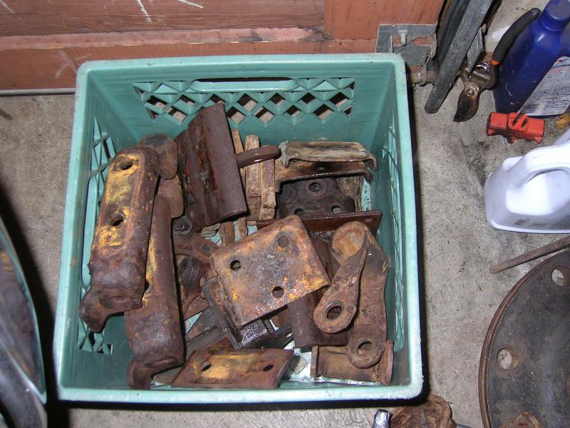

Spent about 3+ hours cleaning things...and still was not close to being finished. So I said F-it and took the springs, and all the rear axle pieces, and 4wd frame brackets to the sand blaster. Should pick them up later this week.

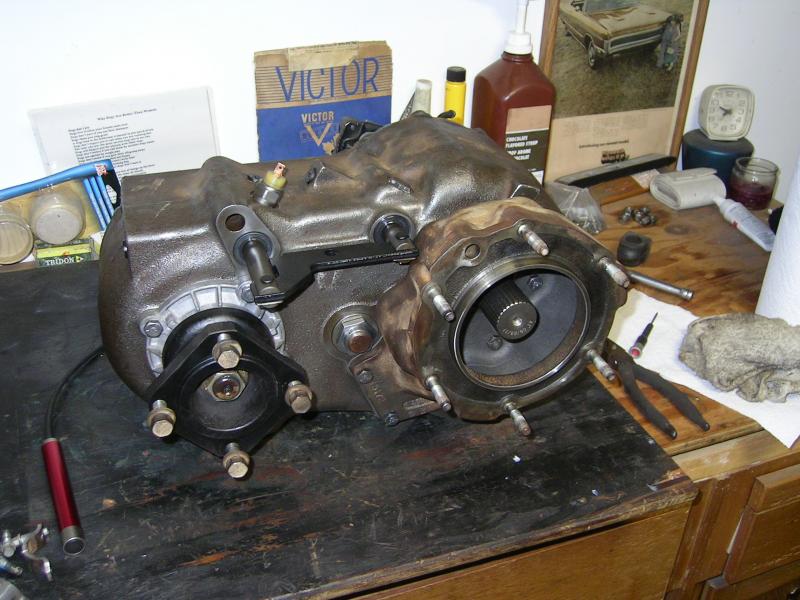

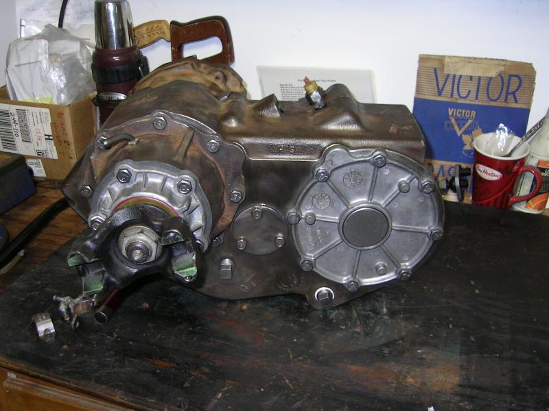

Transfer case is all done.

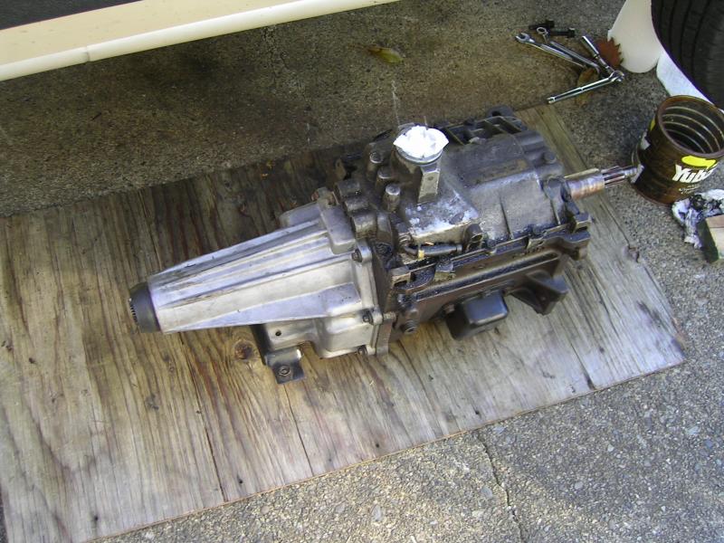

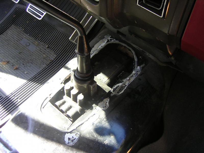

So today I official started tearing down the old crewcab. Pulled the 2wd NV4500 today.
You can see the hole butchered in the floor.
Think I will be finding a new tranny hump from a donor truck to make a complete removable hump.
Tranny out....
Came out pretty easy. Removed the fan from the motor so I wouldn't crew up the rad. Good think I did I had to lower things a lot so the bottle top shift tower would clear the floor pan.

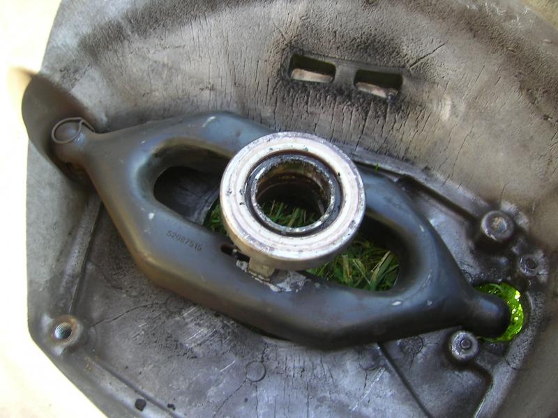

The throw out bearing was in rough shape. Think this why I got a growl, and scream, from it every once in a while.

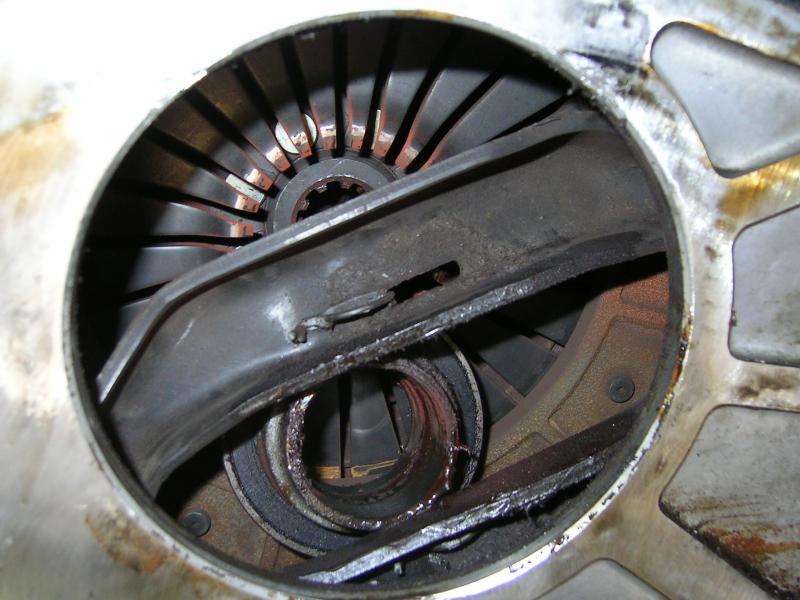

I spin it and it's a little crunchy.

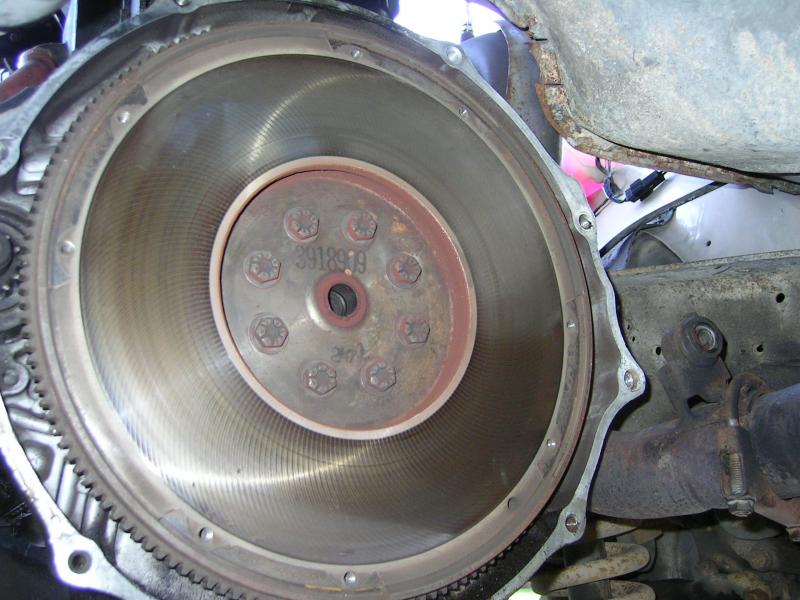

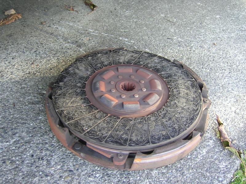

When I bought the crewcab the guy claimed it had a new clutch assembly installed. I think he was right. Clutch, pressure plate and flywheel are in great shape and appear to have been replaced....even though I've personally put about 30K miles on the truck so far. Guess I'm easy on the clutch.
So I'll be replacing the Throw out bearing, and installing a new pilot shaft bushing. The re-install everything. Glad I waited to order a new clutch assembly...saved a few hundred.
