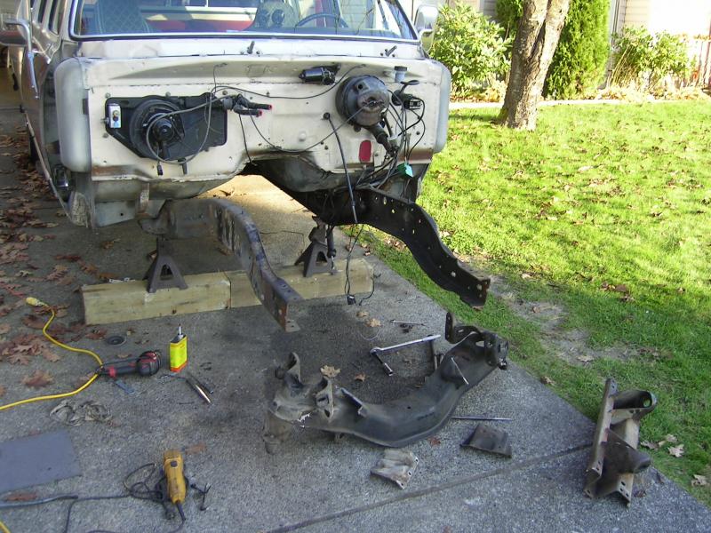

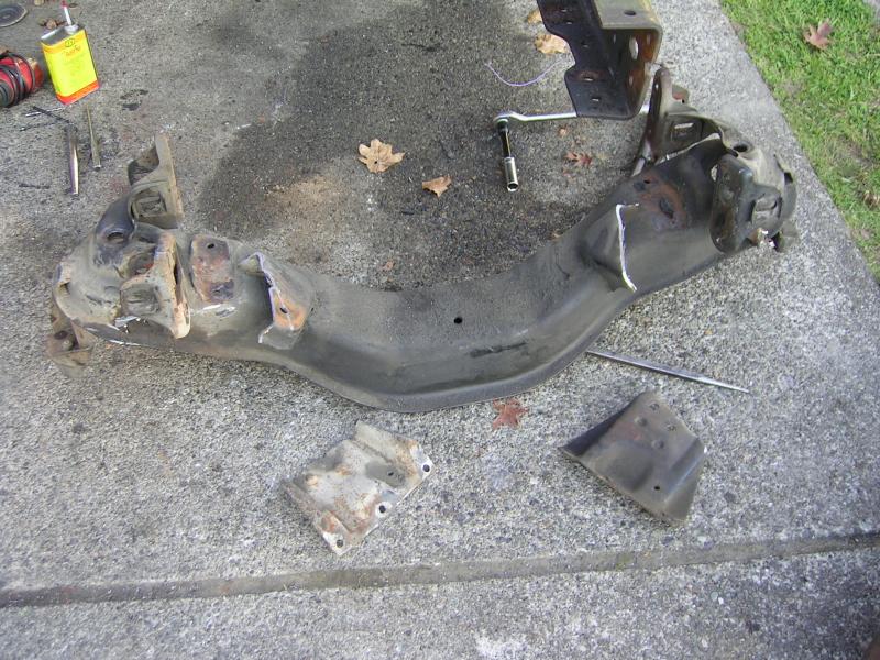

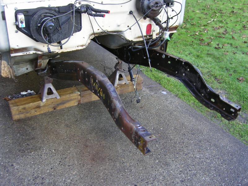

OK today I got the rivets all pounded out, and the cross members removed. Took me about 3 hours or so to get all the rivets out....about 20 rivets. Then I had to cut the inner brackets off the main center cross member...would not come out other wise.

And then a good pressure washing and scrubbing with so Simple Green.

Tomorrow I will get some paint on the frame rails...then start measuring and drilling holes to mount the 4wd cross members and brackets. Should have the front diff in by early next week.

Never realized how much work it takes to convert the truck to 4x4. Looks amazing, though ! Love the date code on the side of the framerail. Hopefully, you're going to repaint those letters there....
