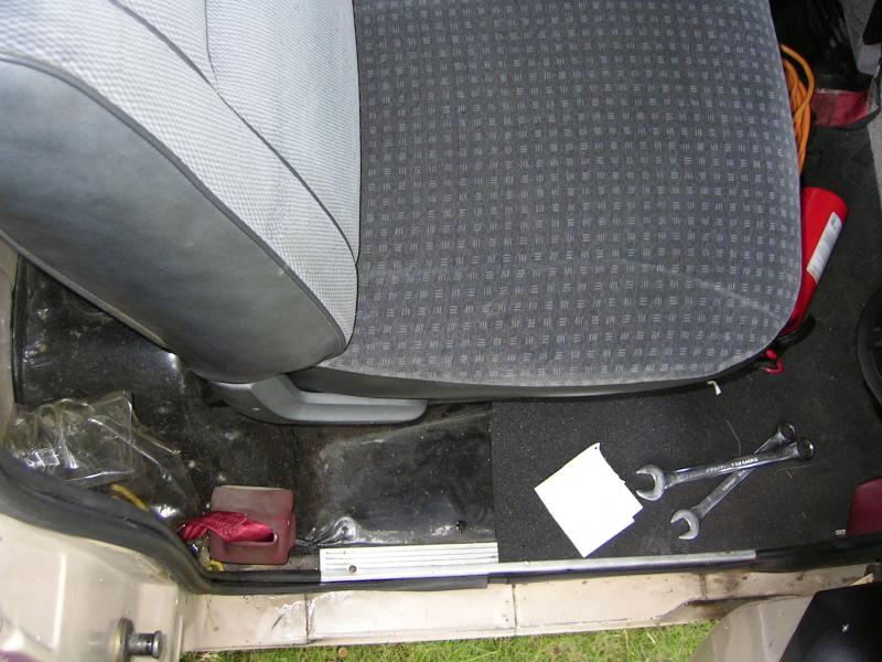

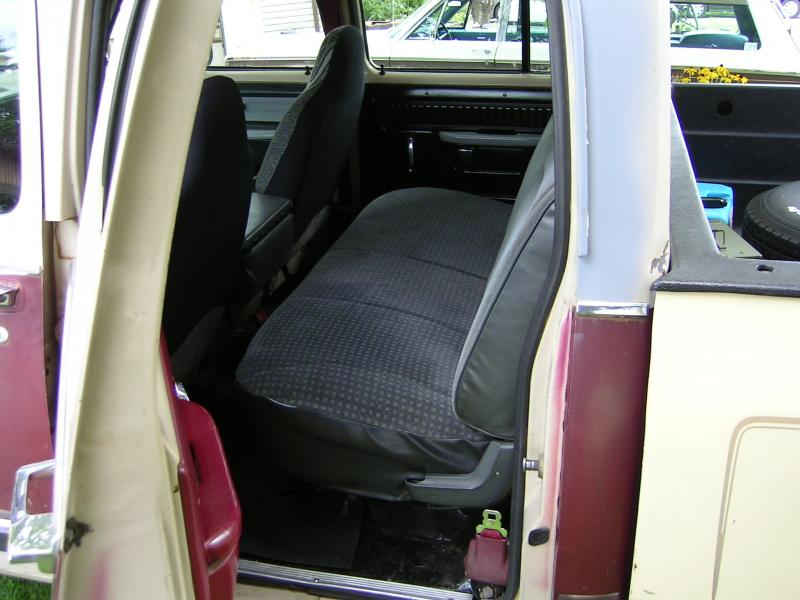

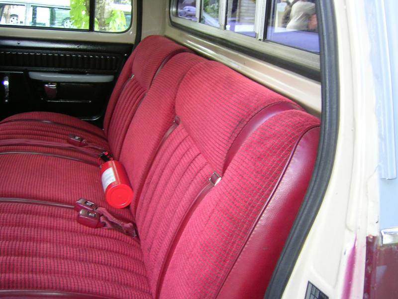

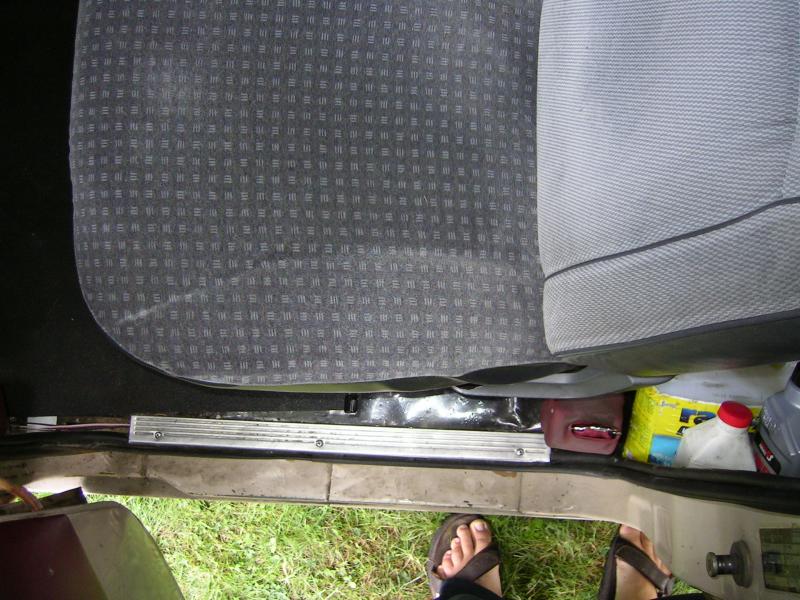

I had hoped to use the nice grey bench seat in the crewcab. Replacing the red rear seat was the plan. Well I wrestled the old one out,and then installed the grey bench from the 93. It turns out that a clubcab bench seat is off set, or short, on the passenger side. Here are some pics to show the difference.
Drivers side....
Passenger side....
Also turns out the base of the grey bench is longer then the stock rear bench. And the angle of the seat, and or the seat tracks, is greater then the orignal as well.
So needless to say I didn't keep it in the truck. Back in went the red seat and I will just have to get a good grey seat cover for now until I can have it re-upholstered.

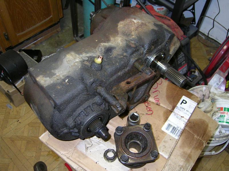

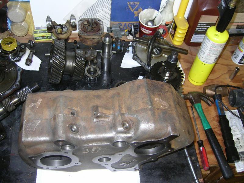

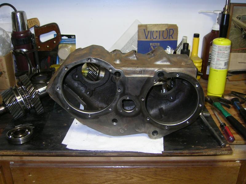

And I tore down the transfer case for it's conversion from 23 spline to 29 spline input shaft. Never torn into a T-case before, so was a little worried. But found a couple sources on-line with great write ups and followed them. All went well.
Before..
After with case all cleaned up...
Now I have to get the parts down to my machinest to get the work done.

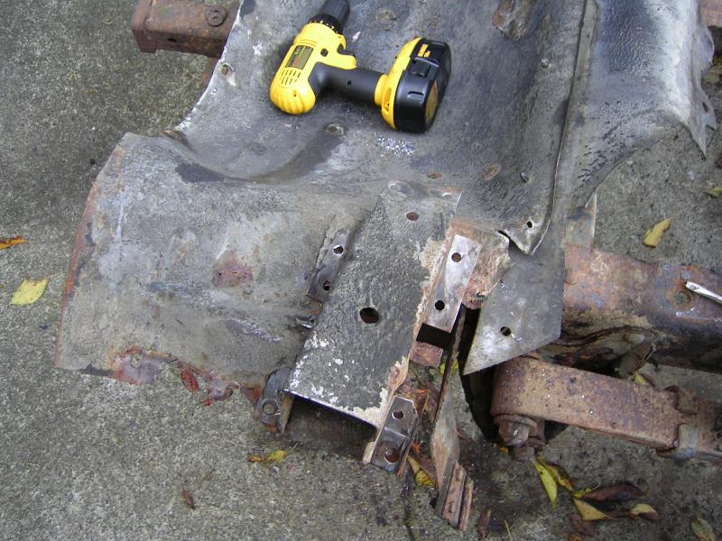

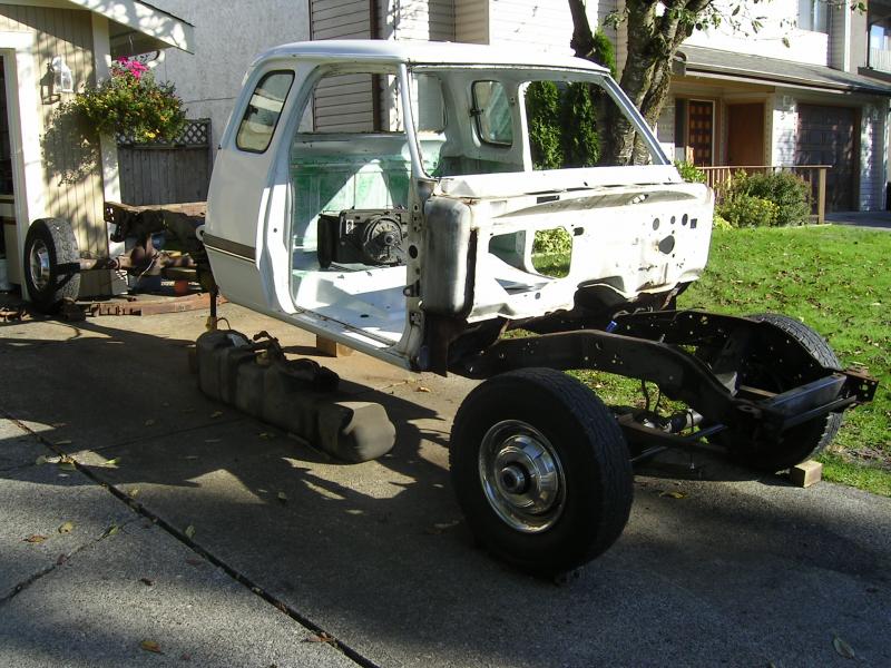

I had hoped to use the inner fenders, but the drivers side was too rusty, and then once I got the pass. side out I found it was rusty too. So I removed the mystery brackets and tossed them. I will reveld those brackets onto my good inner fenders on the crewcab later.

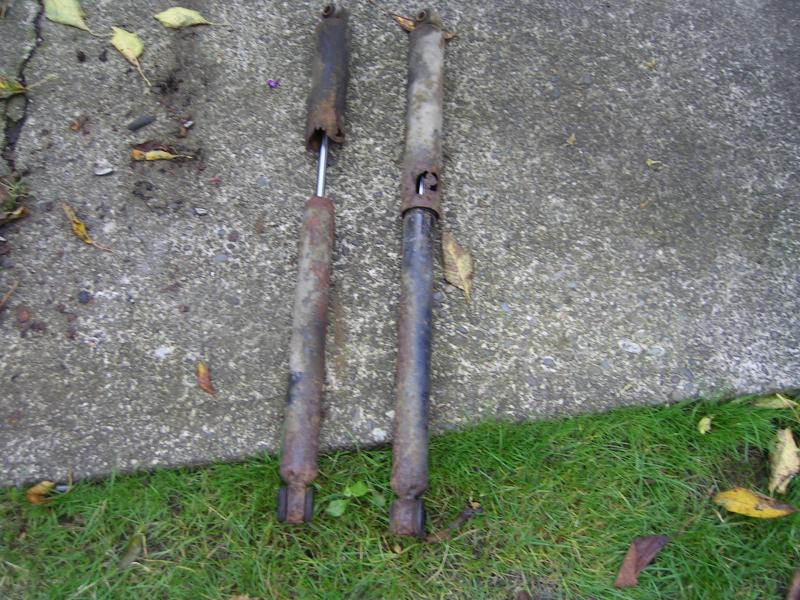

I also removed the shocks...all 4 were original units!! These are the rear shocks.
And this is basically how the truck sits now. Another day or two and it should be ready to come off the frame and go to it's new home.

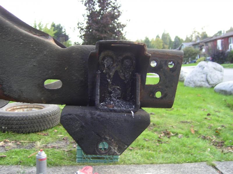

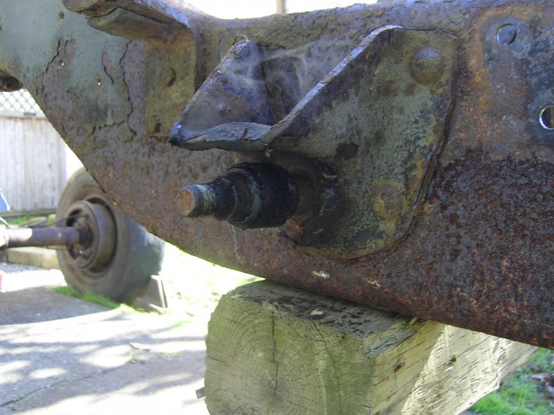

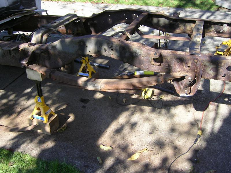

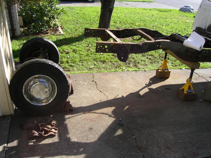

Got the rear diff out. Which was no problem. Getting the springs off...well that took me a lot longer.

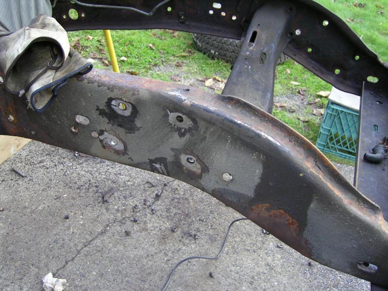

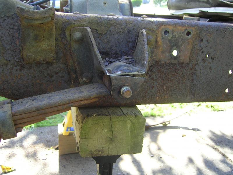

3 of the 4 bolts were seized to the inner spring bushing metal liners. So I Decided since I wasn't using the frame or brackets I would just cut the front of the eyes off.
Next was getting the spring free...had to cook the rubber until it was soft enough to slide off. The rear spring mounts...which I knew were in rough shape...turned out to be paper thing. All the rust flaked off when I was beating on the bolts trying to free them up.

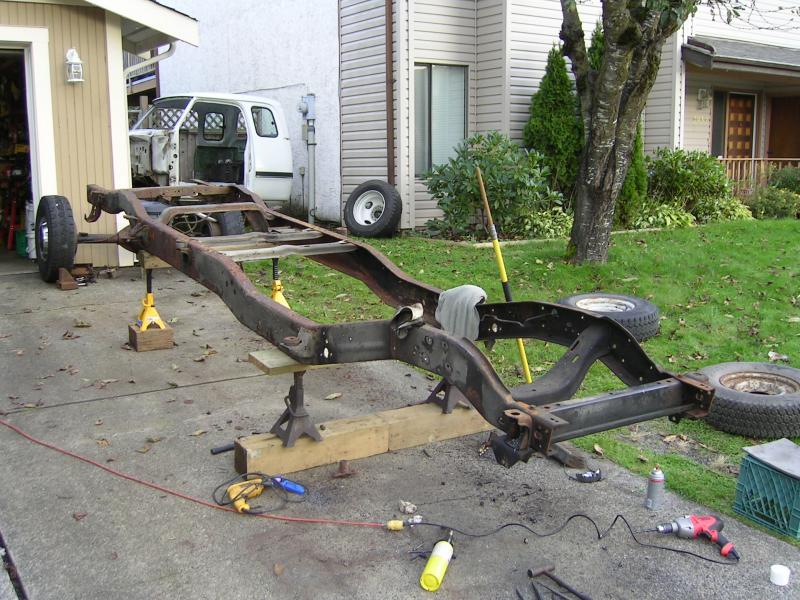

Old Oct 8, 2013 | 12:50 AM
  #133

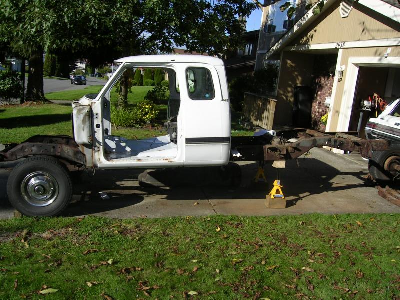

And the cab just sitting there. We moved it off the frame so I could finish tearing the frame down.
And a day or two later all that was left was a frame....

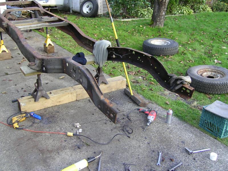

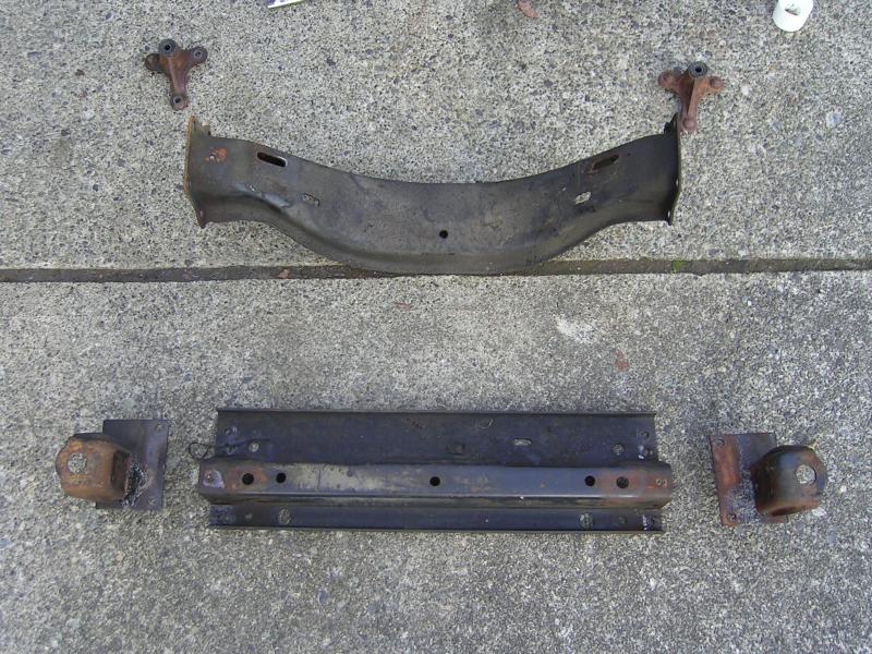

Then I had to get all the front 4wd brackets and cross members off. So removal of the rivets was at hand. I ended up drilling out the heads of most of the rivets...then using a HD punch and a 3lb hammer to pound them loose.
Only ones I used a grinder on were the main engine cross member...sionce they were easily accessed.
And all the 4wd brackets removed. Too me about 5-6 hours to get all the brackets off.

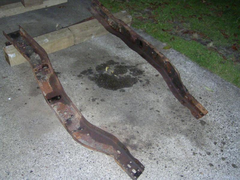

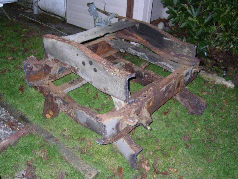

And the frame pretty much ready to be cut up and hauled away.

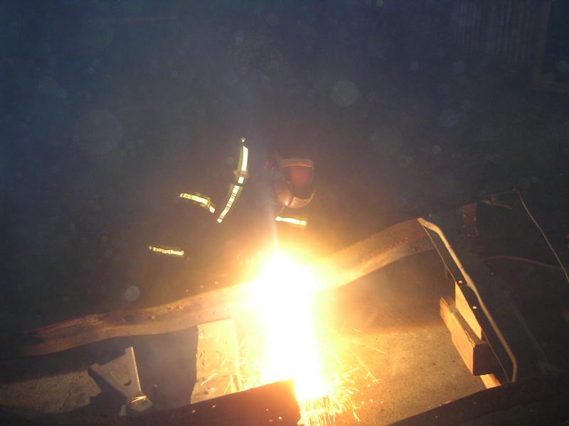

Now to cut up the frame I was not sure how I was going to do this...until my neighbor, and friend, asked if I wanted to use his plasma cutter from his work....HELL YEAH I DO!!!
15 minutes after getting the plasma cutter home this is all that is left of the frame.
I'm keeping the front frame horns as templates and reference for drilling and positioning the brackets into the crewcab frame.
