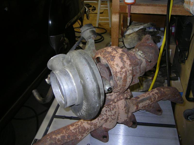

I bought this HX35 used off craigslist a few years ago as a rebuildable core.
Here's what I bought...

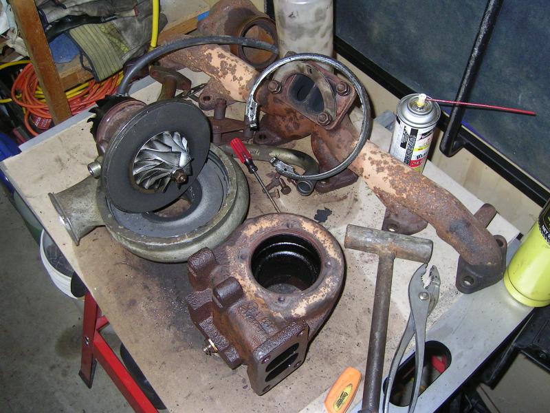

And all torn down....
I tore it down and installed one of those E-bay rebuild kits. The shaft does seem to have more play then I thought a "rebuilt" turbo should have. But not so much that it will touch the sides when I push up/down and rotate it.

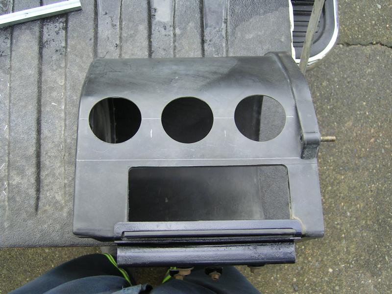

Stock air box with three 2" holes cut into the front side....

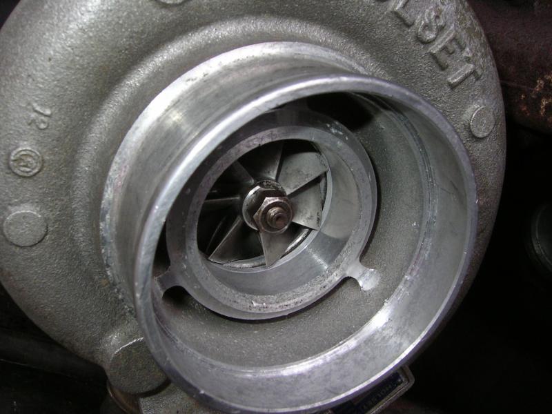

Well in the light of day it was pretty obvious what the problem was....
Tad bit of interference between the impeller and the housing..... Guess my turbo rebuilding skills still need a little work.
Now that there is wear on the intake housing, does that make the housing junk? Or if I got a new cartridge for the HX35 can I install it and be good to go?
Old Oct 17, 2014 | 06:14 PM
  #764
mknittle's Avatar
Joined: Aug 2013
Posts: 4,918
Likes: 603
From: Tulsa, OK
I would be more concerned about the impeller. We have cleaned up and ran housings after some pretty nasty carnage. In he "hotrod days I had to deliver turbos to my dad to replace sitting along the road with a load of logs. I would take some sand paper to it and make it match the area ahead of the damage replace the cartrage and call it good.
