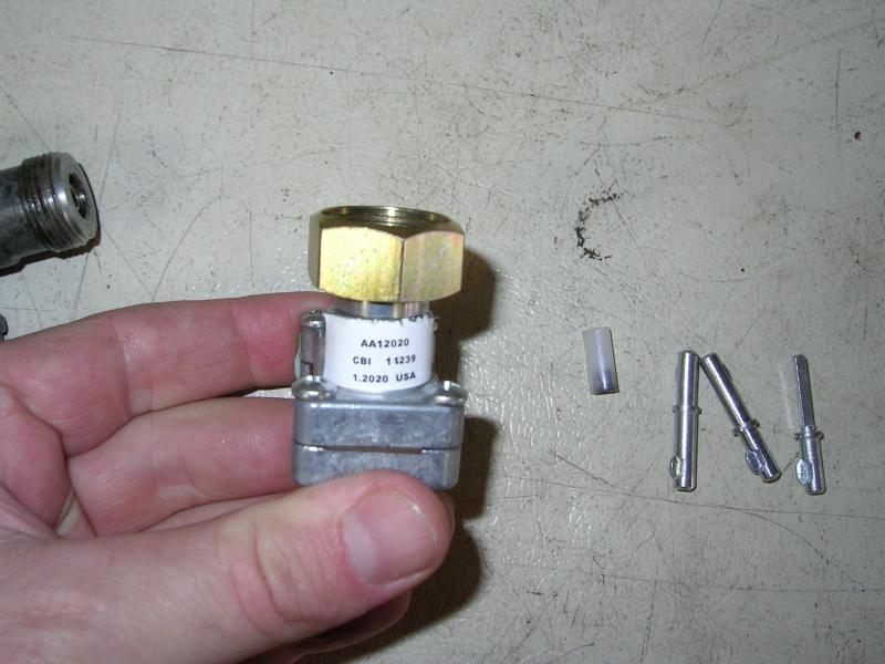

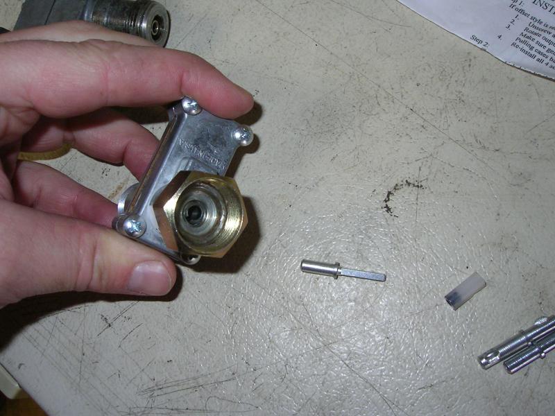

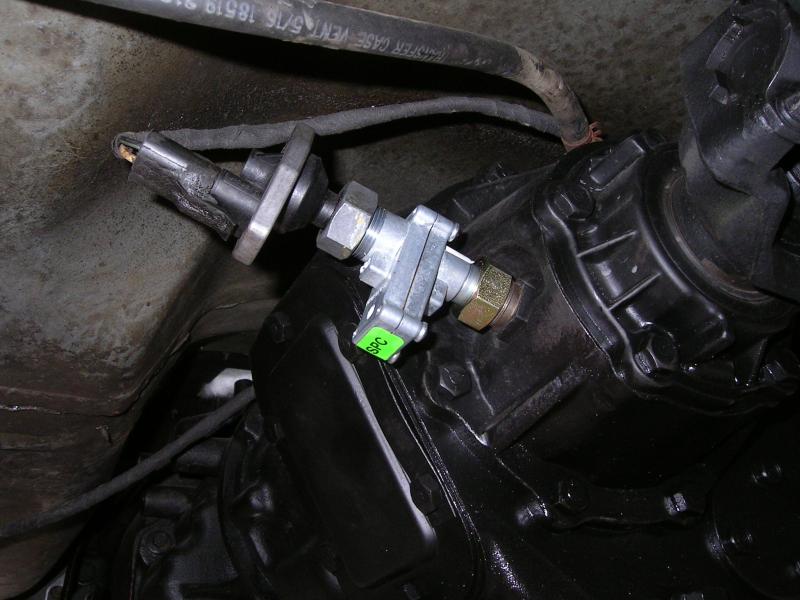

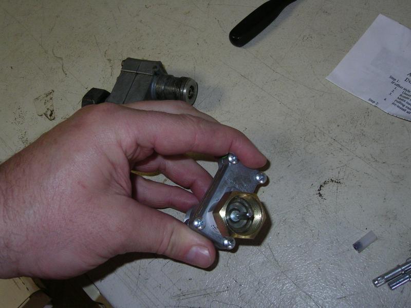

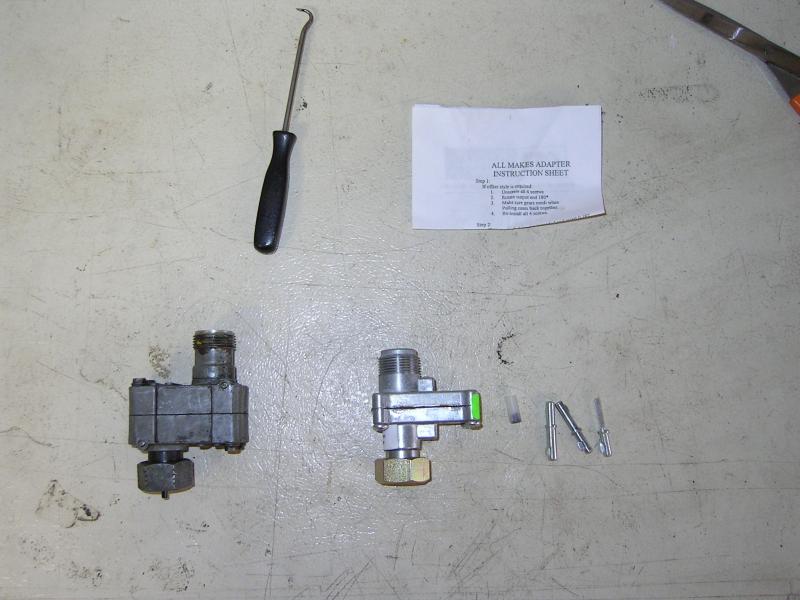

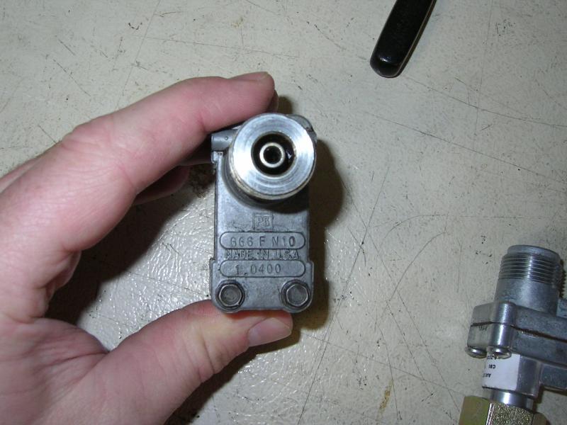

Well yesterday I received my ratio adapter for my speedo. I figured out that I needed a +20% VSS signal to get my speedo to read right.
I went with PATC. Very happy with their service and product.
http://www.transmissioncenter.net/sp...n_______va.htm
Here's some pics...
Original and new unit....
And the ratio on the OEM unit. The 1.04 equals a +4% VSS signal.
And the new ratio at 1.20. So +20% VSS signal.
Old Nov 5, 2014 | 09:23 PM
  #790

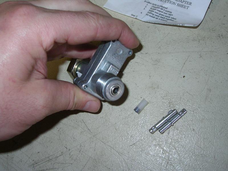

The ratio adapter from PATC must be a generic piece to service more then one application. SO it came with a small adapter kit as well.
I needed the square head for the transfer case side...
And the VSS side I needed the plastic insert so it would except the VSS square drive shaft. You can see it in the back ground.
And installed and ready to go.
