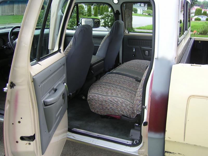

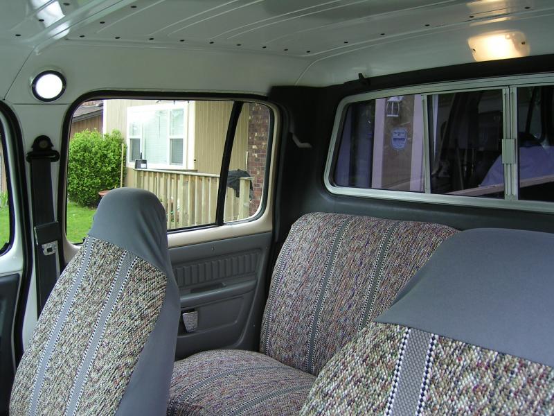

So that's about it. Truck is basically done!!
Installed a good set of saddle blanket grey seat covers, front and rear and called the interior finished.

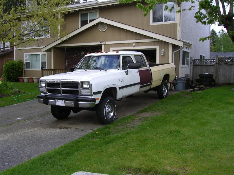

And here it is ready to go....My daughters have dubbed the crewcab "Patches".... They don't want me to paint it....they love it the way it is.
I started driving it the first week of May. Have put on about 1300km's so far. I will go into the few issues I have had to deal with later.

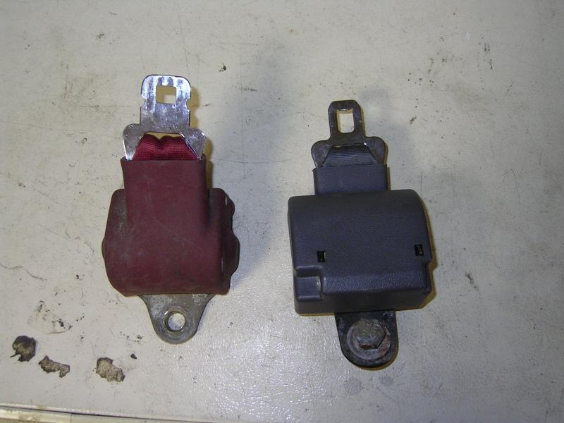

I knew I forgot a couple things.....

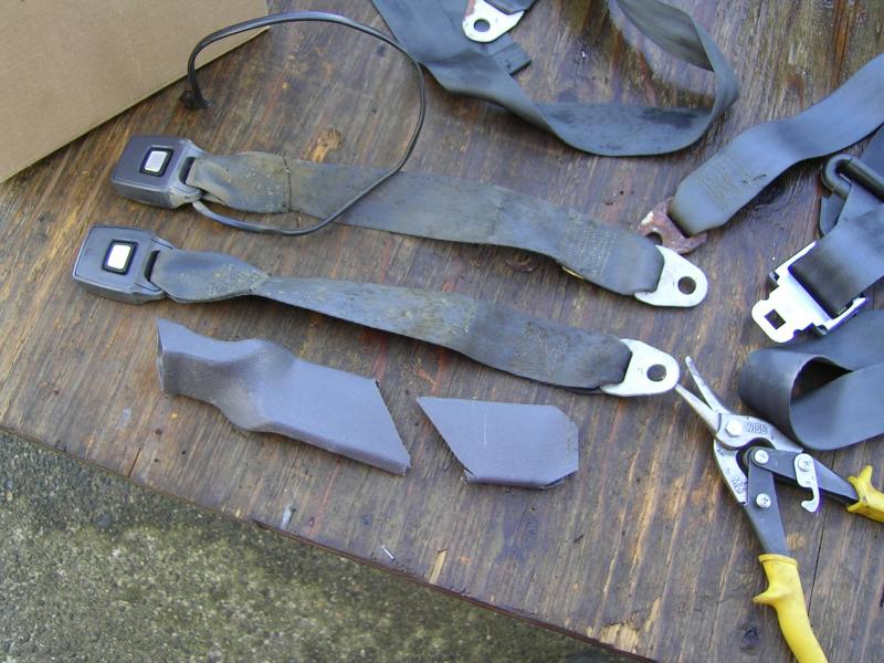

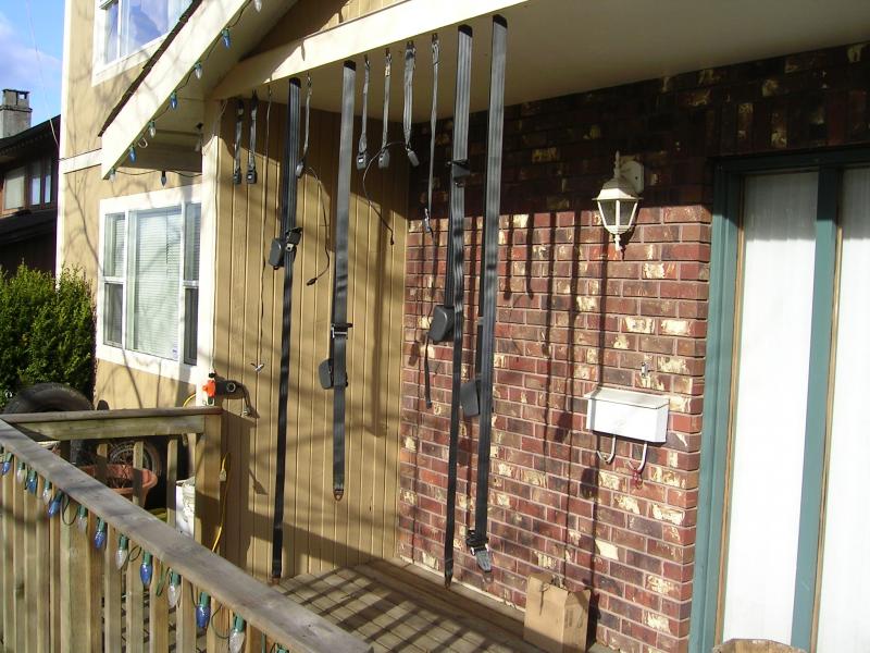

There was the seat belts. I had the complete set from the clubcab donor truck...in grey. And I lucked out and got a complete grey set from the wrecker from a regular cab truck.
So I cleaned everything up really well. Lots of simple green and a scrub brush to clean all the webbing. If you haven't scrubbed your belts...I highly recommend it. They are nasty things!!
I also didn't like the broken, and sharp plastic sleeves over the belts. So i cut them off as well.
Cleaned up and set out to hang dry.
Wonder what the neighbors thoought of my redneck wind chimes.....LOL...

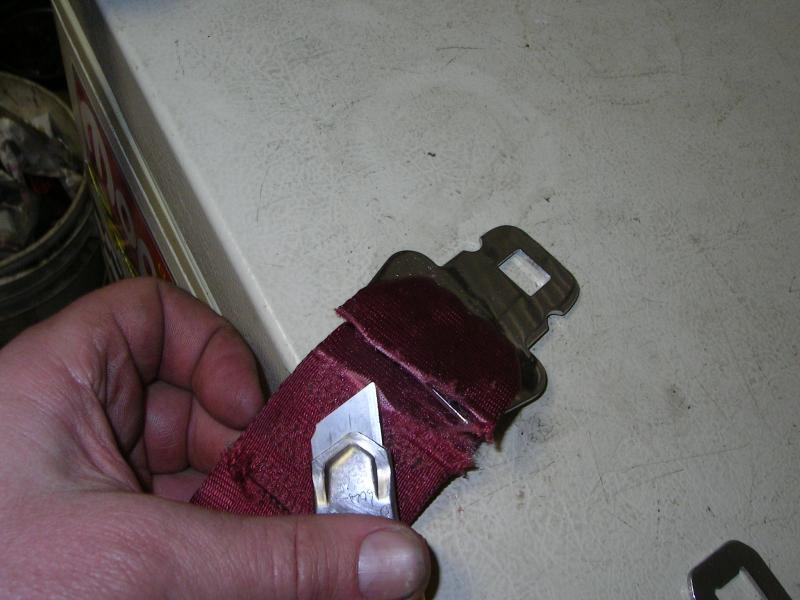

Only thing I had to modify was for the rear seat lap belts. The auto winder ones.
Here is a pic of the original crewcab unit in red, and the rear clubcab unit in grey.
What I wanted was to use the clubcab unit, but the buckle would not work. Seems Ma. Mopar decided to use a different buckle and latch set up for the rear seat belts in the clubcab.

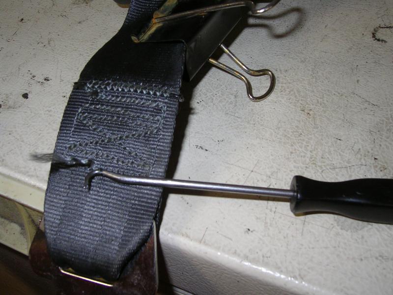

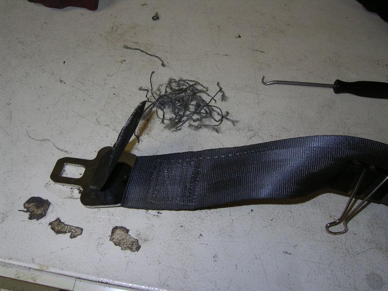

So I decided I would remove the stiching on the grey belts...to get the buckle off cleanly.
Took a while to work out the old stitching...but eventually got it all out.
Old Jun 12, 2014 | 11:26 PM
  #641
Then it was cut the buckle off the red belt, and have the upholstery shop sew them back up.
Here you can see the difference in the two buckles....
Ready to get sewn up....
The shop did it for free, since I had already done all the hard work. Took like 2 minutes on their machine.

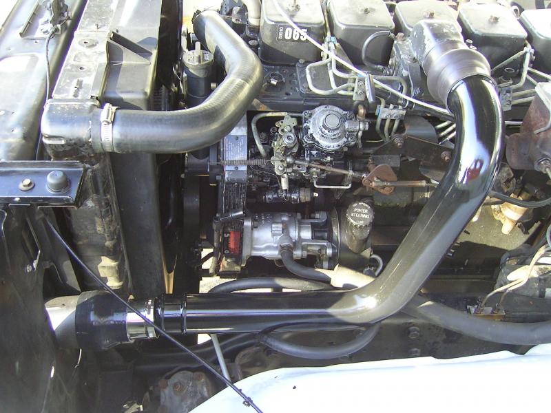

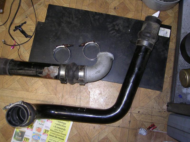

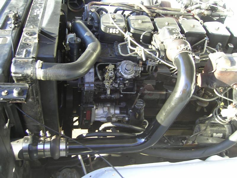

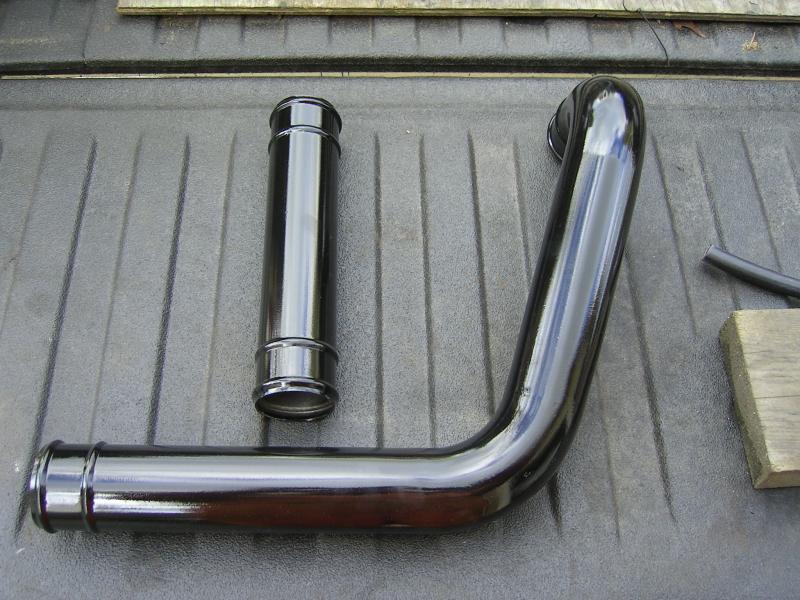

Man another thing I forgot.... The PS IC tube install.
I had wanted to try and re-use the OEM intercooler tubes. The only issue I had with the OEM tubes was that corrosion had got under the powder coating. (This is why I don't like powder coating)
Wire wheeled them clean....
And then painted them gloss black....
Old Jun 12, 2014 | 11:45 PM
  #644

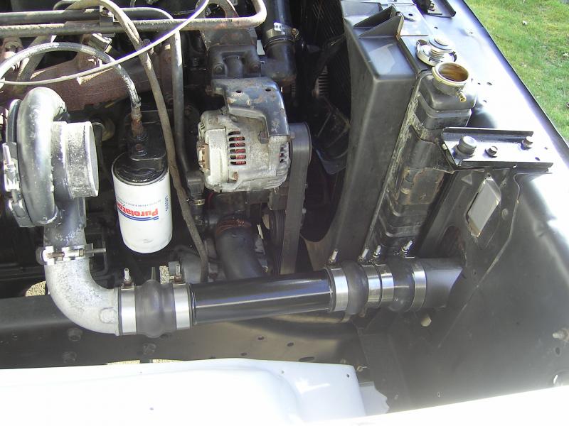

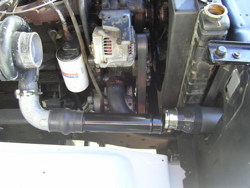

I had taken measurements when the OEM intercooler was in place, then after I installed the Power stroke intercooler. And had figured I needed a few parts from Silicone intakes.
And this is what it looked like when I trial fitted things.
A little closer then I had planned on. Turned out the OEM boot was about 5" , and I needed a 3" boot.
Old Jun 12, 2014 | 11:58 PM
  #645

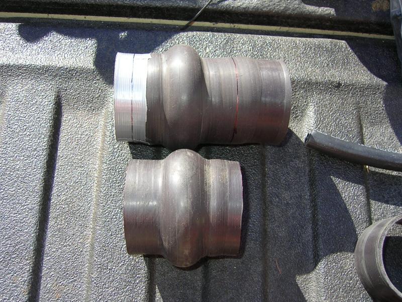

So I looked at some aftermarket "Humped" boots...but they were pretty weak in the humped area.
So I decided to use the OEM boots. Just required a little trimming.
Careful measurements, and even more careful cutting with an exacto knife, netted me a boot that would work perfectly.
All button up....
I really like the Silicone intakes website. They have every measurement you could possibly need on their items. Makes it very easy to get the right part the first time.
